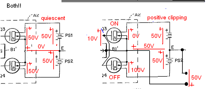

Michael Chua said:
Hi Paul
Yes, PS1 will be connected to ground in a short.
No, reading will be +9V
I've drawn out another diagram with Haflers' patent.
The one on the right is with Q3 injected with a 9V square wave.
E swings to + 9V rails. PS2 is now -9V to +9V, making it +18V.
But when looking at E from Ground, it would be +9V. E will have the same waveform as the injected signal.
Cheers
Mike
Why did PS1 disappear in your second drawing? Q3 conducting does not short out PS1. It brings the top of PS1 to 0V, which leave the bottom of PS1 (E) at -9V relative to ground and the bottom of PS2 at -18V relative to ground.

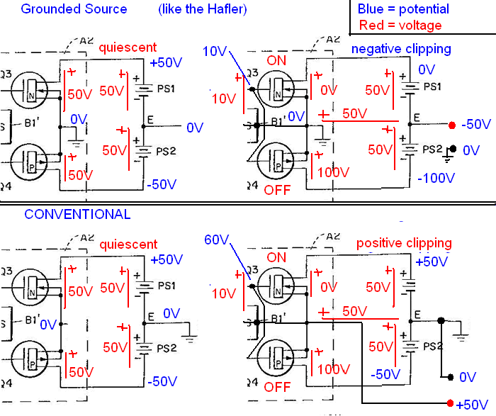

I made a picture (attached). Voltages in both circuits are exactly the same. _Potentials are not_ - just as expected when the ground reference is moved.
Attaching ground to different parts of a floating circuit won't change it's behaviour. (well, not true for high frequencies though - but this is just because the parasitic "components" aren't included in the schematic)
If the ground reference is removed altogether it's obvious both circuits are exactly the same as far as this part of the circuit is concerned.
Potentials at the different nodes won't exist/are undefined though, but this doesn't matter for circuit operation.
edit: Forgot to remove "positive clipping" text. I meant "N-channel-side clipping".

Here's what the circuit looks like. Where you put your 0V potential (ground connection) won't affect circuit operation - only node potentials.
(positive clipping as shown in the picture is for a conventional amp. With ground connected to the other output like in the Hafler, this would be full negative output of course)

Michael Chua said:In this Hafler PSU, 0V is fixed. Center of PSU swings...
Hi Michael,
I think this quote is the heart of your misunderstanding of this circuit: The center of the PS does not swing. It's the ends of the power supplies that swing (i.e. get grounded to some extent or other through the outputs). Or, alternatively stated, its the whole PS that moves up and down, but the center point will always be at exactly the middle voltage between V+ and V-.
There will always be 126V from V+ to V- in the 9505, or 18V in your earlier example, and the middle point (OUT+) will always be halfway between the two potentials. How that middle point relates, potential-wise, to ground depends on how strongly coupled to ground V+ or V- is. If V+ and V- are being equally pulled towards ground (like when the amp is at idle), then OUT+ will be equal to ground potential. If V+ is pulled more strongly towards ground, then OUT+ will be negative relative to ground due to the negative potential sourced by the negative end of PS1. If V- is pulled more strongly to ground, then OUT+ will be positive relative to ground due to the positive potential of the + end of PS2.
Hi Paul
I really appreciate your explanation but I am having difficulties seeing this. If the center of the PS does not swing, how is current going to flow through the speakers? One of them have to change so that a potential difference is there for flow of current. So, if "E" doesn't move, then 0V must move. Help me out here. My learning is very slow.
Let's assume upper N-Fet shorts, what will be the voltage of the top supply rails?

If the N-Channel shorts, the top of PS1 will be clamped to 0V. However, PS1 will still be generating 63V. That means that E will be at -63V relative to ground, and the bottom of PS2 will be at -126V relative to ground.
So the speaker will feel -63V DC.
Basically, what I was saying before was that E/+OUT doesn't swing or move relative to the power supplies. It will always be right in the middle of PS1 and PS2. But, the whole stack, PS1+E+PS2 DOES move up and down based on the conduction of the output transistors.
