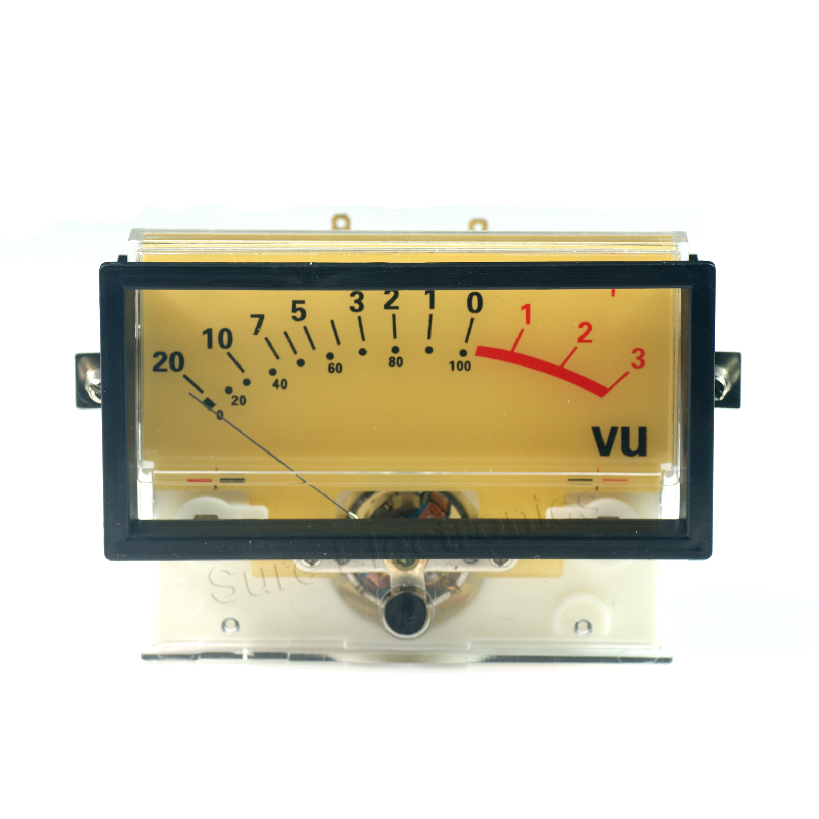

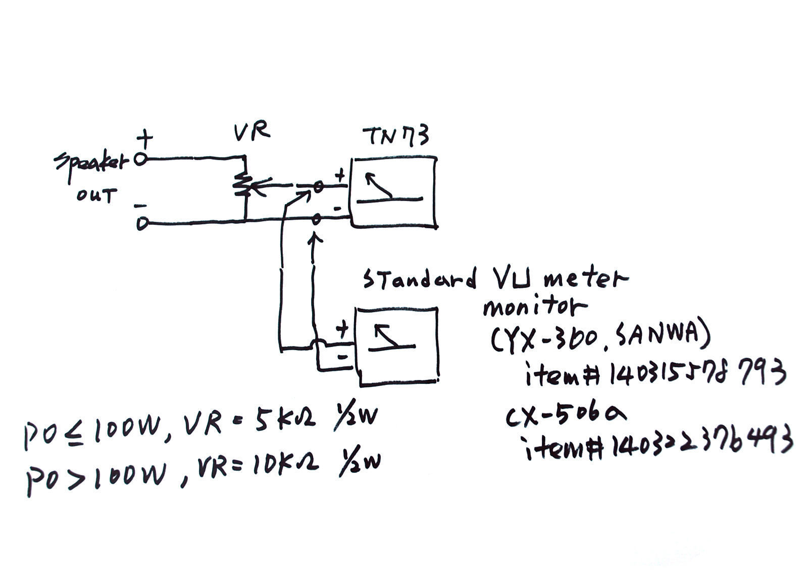

I've got a pair of VU Meters and would like to connect them to the out of my Honey Badger amp. I have followed the schematic on the eBay seller site (attached) and I see the arrow jump however I don't like that it is not really realistic. Low volume produces very little movement and high volume produces a lot.
What is the best way to connect the VU Meter to speaker out to get decent results? I don't need great precision but I want it to somewhat realistically represent the power out. Right now it is either nothing or a lot.
The meter I got is TN-73 from this eBay listing:
1pc Panel VU Meter TN-73 0dB=0.8VAC size=76x59x41mm & LED lamp NISSEI | eBay

Meters of all kinds only sense or read a DC voltage. The way you have it noted in the schematic is that you have no provision for this property. The AC source signal needs to be rectified and then limited by resistors to establish a scale that would refer to the end point of the meter scale known as full scale deflection. This is not to be confused with hitting the peg which is a overload condition and something the meter does not want to have happen a lot. It stresses the meter jewel movement.
Rather than go through all the calculations of making a VU meter which is an average meter, you could consult some amplifiers that have meters that have already done the calculation and designs for you- this would be equivalent to saying why reinvent the wheel?
The reaction type of meter has to do with the damping of the meter drive.. This is usually done by placing a capacitor in parallel with the meter after the diode. The larger the capacitor within reason the more damping or averaging there is to take place. A very small cap would allow for peak meters or dB meters. Keep in mind that this is hard to do to a real fast rate as meters themselves have a damping and are slow to change due to the physics of the movement. This is why some meters also have LED peak indicators to signify when a certain peak level has been hit even though the meter has never reached that position. This is why they are incorporated as the meter can never indicate a +8dB signal transient as the meter ballistics and weighting have not allowed the meter to indicate that. This is why LED meters are better for fast reacting type signal displays.or what is called Peak meters or dB meters.
So basically you tap off a 8 ohm load and take that AC voltage sample and first rectify it so that it is a 1/2 wave AC signal and then limit the current so that it stays withing bounds of the scale and then add weighting to the level ballistics that you desire.
When a meter needle is sitting at -20 Vu the input of a negative going signal as would be applied by a AC signal source can not really be displayed. So 0 Vdc is at -20 Vu and then the 100% reference signal is placed at the 0 Vu or 100% and then the Full scale deflection is placed at the end of the scale indicating in an amplifier the amount of headroom it must have.

I thought that a VU meter showed 0dB at 1.3 volts, but yours says 0dB at 0.8V. OK, no matter which, your Honey Badger is likely to over drive it in normal use, that's why the voltage divider is used.
I don't know what power supply you are using for your Honey Badger, but let's assume a max output of 30V RMS. That's 50X the voltage needed to get your meter to 0VU. If you divided the amplifier's output voltage by 50, that would place 0VU at your max RMS output, and +3VU at the peaks.
However, it's unlikely that you are using that much output power. Do you really know how much you are using? You could try to set voltage using a test tone. For example, go to the thread listed in my sig line. Download one of the test tones and do the following.
Set your system volume to a normal, or slightly higher than normal level. Play back one of my test tones and dial your voltage divider to -9VU on your meter. That "should" put you in a good range for your normal listening levels, with peaks falling right at +3VU. The peaks may be too brief to see on the needle, but that a good starting level. Hope that helps.

Thanks for the link, Pano. It is a very interesting tool. I used it to make some measurements... My 220Hz test tone came up at 20V RMS. My understanding (from reading your thread) is that the peak voltage should be 20 x 4 = 80V RMS, or 113V amplitude. Something doesn't connect - I have +/-67V at the rails. What divider should I use if I follow this test result?
Regardless of the test tool, if I follow the theory my amp can produce 67V or 47V RMS. The VU Meter will be at 0 with 0.78V and at +3dB with 1.1V (confirmed in tests) which means the divider should be around 43x if I want the meter to register +3dB at max output.
Now, if I follow practice, I got the most reasonable results (by just observing the arrow move and playing with the potentiometer pod) with a 14x divider. This would mean that VU meter is at 0 with 11V RMS at the speaker and the peak (+3dB) is with 15.4V RMS.

That's for trying the test. Your 20V reading is surprising, but I don't know your room or speakers. If 20V is what you get from my test tone, then your peaks will be 4X higher (12dB) meaning 80V peak, not RMS. I agree that still doesn't connect. Perhaps try again?
Setting your VU meter at 0 for 11 volts seems more reasonable to me. Remember that most music is recorded at an average level of 14 to 18 dB below peak. If your meter consistently hits +3 on peaks, it should be hovering around -15dB on average. Does it?
