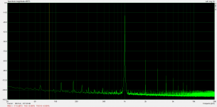

I'd try out an EL84. I ran one at 10mA and 225V plate idle (HT=430V) and got the attached distortion profile with feedback set for a gain of 10. Obviously, more gain will increase distortion but it'd still end up plenty low, I'd bet. The nice thing about the EL84 was that bias stability was pretty good in my experience even with a naked CCS plate load. "mu" on these power pentodes doesn't seem to be that high compared to these higher-transconductance small-signal pentodes. I don't recall what the EL84 was, but I measured mu of 300 for an EL34. Not all that high. I never once adjusted the bias on CCS-loaded EL34 or 84 the whole time I experimented after I initially set it.
Also, is there a reason you don't drive the feedback resistor from the mu output of the CCS? This would increase open-loop gain since the D3A plate would no longer be loaded by the feedback resistor. If necessary you could then lower the gain some by loading the plate with a higher-value resistor if you find the stage hard to tame.

I took some measurements with a 470K resistor from plate to ground of my EF37A input, 801A biased at 330V 50mA.
Output Z: 2.09ohm
FFT 1W into 8ohm
FFT 4.1W into 8ohm
As you can see, the spectrum is low distortion but H3 dominant. Subjectively, I felt I was getting better sound with a 200K plate resistor and a dominant H2. I decided to keep the CCS in place, but use 200K from plate to ground and see where that got me after rebiasing the pentodes.

Honestly, just looking at the curves and operating points of the EF37A and the 801A, it looks like the EF37A at 270Vp is going to be 2nd harmonic dominant no matter the steepness of the load (within reason). The steeper the load on the EF37A, the more even harmonics. However, the steeper load also gives less gain for the feedback. The 801A is going to tend to odd-harmonics at higher levels due to the compression at both high and low plate voltages, with more even harmonics at low levels.
You've also got some even-harmonic distortion cancellation going on. At low levels the output stage curve spacing is expanding while the input stage is compressing and vice versa. Sometimes you get really good cancellation and are left with low levels of 2nd. It's nice that you can play with it and dial it in where you feel it sounds best.
