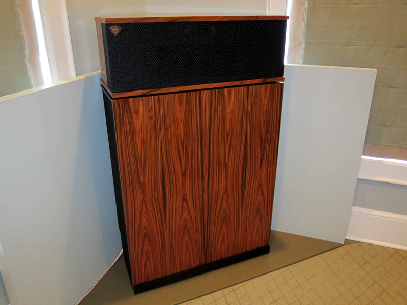

From the co-inventor of the Klipsch Jubilee, Roy Delgado:
These early reflections should be controlled (i.e., a "Zero Reflection Zone" by P. D'Antonio) in order to achieve much greater imaging performance with speakers in the corners of their rooms."Imaging and creating it by having two varying acoustic signals is an interesting undertaking. I have found that a smooth, unobtrusive boundary between the two speakers works very well with well-behaved and consistent polar patterns [of speakers]. The other thing that I have noticed that works well is no boundaries--like playing the speakers outside. Both do a very good to excellent job of accomplishing the imaging goal, but the caveat is that no boundaries forgives non-consistent polar patterns while a smooth boundary is a strict enforcer of consistent polar patterns. Pretty cool how that happens."
What is the easiest way to control these early side and front wall reflections? Have a smooth boundary between the speakers (i.e., nothing between the speakers) and smooth front and side walls.
If this is not possible for your room and setup, the next easiest fix is to employ absorption panels. Many companies make fuzzy panels and acoustically absorbing tiles that can easily be placed along side walls and front walls of the your listening room. How much is needed? It turns out from the Haas Effect that controlling early reflections should be considered for 10-20 milliseconds of delayed reflections from side and front walls. This translates into about 11 to 22 feet (3.4-6.8 meters) of total path length at room temperature. However, the first 2-4 ms of early reflections are critical to control, translating to about 2-4 feet (0.6-1.2 m) of significantly reduced reflections. I use about 2 feet (0.6 meters) of absorption at the side-wall exit area of my corner-horn midrange horns.
Depending on your room geometry and listening position in relation to the corner horn placement (i.e., the included angle of the speakers relative to the listener--typically 90+ degrees included angle), the width of the midrange horn acoustic coverage laterally ( typically 60-100 degrees included angle), and assuming that your corner horn midrange horn controls its polar response down to its lower crossover frequency, the area that you should cover with absorption panels could be on the order of 2-10 feet along the front and side walls. I find that 2 feet of absorption along side walls works very well for Klipsch K-402 horns (i.e. Jubilee), and ~7 feet across the front wall, measured from the exit of each midrange horn's mouth.
Another approach is to place diffuser panels along the same near field areas but note that the use of diffusers in the Haas-effect areas will likely not achieve the same level of corner-horn imaging as the use of absorbers. The advantage of using diffusers is the relative liveness or deadness in smaller listening rooms.
If your listening position is more than 11 to 22 feet (3.4-6.8 meters) away, you probably have little work to do. However if you are like me and sit within 10 feet (3 meters) of your corner horns, you will find that the effect of using absorbent panels along the walls very much increases your stereo imaging performance.

Again, the most straightforward way to deal with this is to simply remove all objects between the speakers, leaving a smooth wall. If this is not achievable, the alternatives are the same as above. I use absorption tiles on the side and top of my center loudspeaker, on the masonry, and a quilt-based cloth fabrics on other protruding objects like the mantlepiece to control early reflections.
"But What About the Television Between My Speakers?"
This one is easy--place a temporary quilt, comforter, or acoustic absorption tiles in front of the screen when you listen in music only (i.e., no video) mode.
"But What About the Floor Next to My Speakers?"
Something as simple as a thin area carpet around each corner horn or even wall-to-wall carpet will suffice. This carpet does not need to be very thick or fuzzy to be effective.
"But What About the Ceiling?"
If your ceiling is relatively high, you probably don't have a problem. If it is lower than about 9 feet, and especially if you own Klipschorns or other horn-loaded loudspeaker having collapsing polar midrange horns, you should put absorbent material around the top/bottom mouth of the midrange horn or place diffusers/absorbers on the ceiling around your speaker's midrange horn mouth (especially if you sit relatively close to your corner horns). More on this subject later.
"What If the Amount of Absorption Recommended Above Just About Covers My (Small) Listening Room?"
Then you are probably one of those unfortunate corner-horn owners that would greatly benefit by placing your speakers in the corners of a larger room: in particular, Klipschorns require a large room to perform at their best . If perhaps you are using something like Klipsch Jubilees, then you can use them in a smaller room. More on the subject of midrange horns, below.

"What Can I Do About Ceiling Bounce of collapsing-polar midrange Horns (e.g., K-400 Series Horns and Smith horns)?"
A quick fix is to place an absorbent tile such as this to the top of the speaker cabinet, cut to fit appropriately but allowed to extend forward of the front shear line of the speaker's cabinet a couple of inches. This will have the effect of absorbing some widely dispersed polar acoustic energy exiting the horn (400--1700 Hz) that would otherwise wind up undesirably on your ceiling. While this technique is certainly limited in effectiveness, it may partially mitigate having to place absorption tiles on your ceiling in low-ceiling environments.
It will have a secondary effect of precluding random placement of drinks on top of your speakers (i.e., the pad will discourage placement of drink glasses and cups there due to its sponginess and corresponding uncertainty in supporting drinks by those random individuals). It will also act as an acoustic coating over any plate glass that you might have placed on top of your cabinets --which reflects more acoustic energy towards your ceiling.
Note that there will be a slight timbre shift when you do this, and slightly improved imaging.
