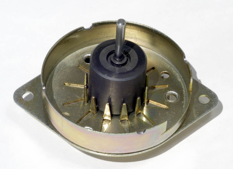

pixpop said:EC8010, can you show us the rotor as well?
At your command...
EC8010-
Thanx for that. The only synchro motors I have seen apart are the Hursts. The designs are similar (pole shape and number) but yours has a much better build. The Hurst is only bushed at the top (the rotor magnet “hangs” from it), and the magnet is hollow. It also appears from the picture that the fit/finish is better than Hurst.
It's obvious to me now why the better Mfg.'s stay away from Hurst. I'm sure the Philips/Airpax/Premotec/McLennan is quieter, and if I had started with it, I may not have had to go to the lengths I did.
-Casey

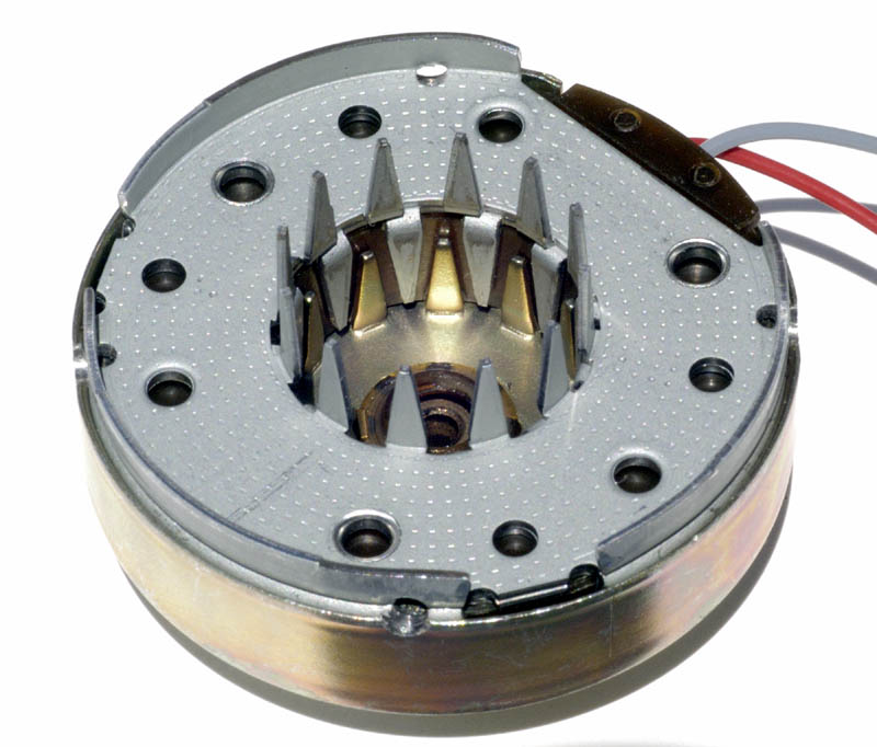

Just to drop back for a moment to the earlier discussion of motors and their poles, I took this photograph of the inside of the Philips/Airpax/Premotec/McLennan synchronous motor used by Linn and Rega etc.
-Casey
