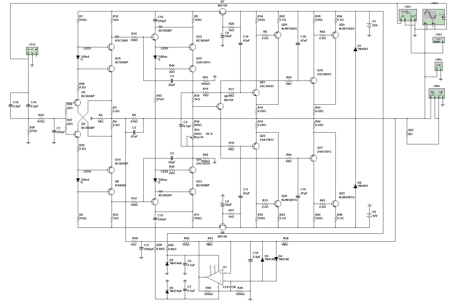

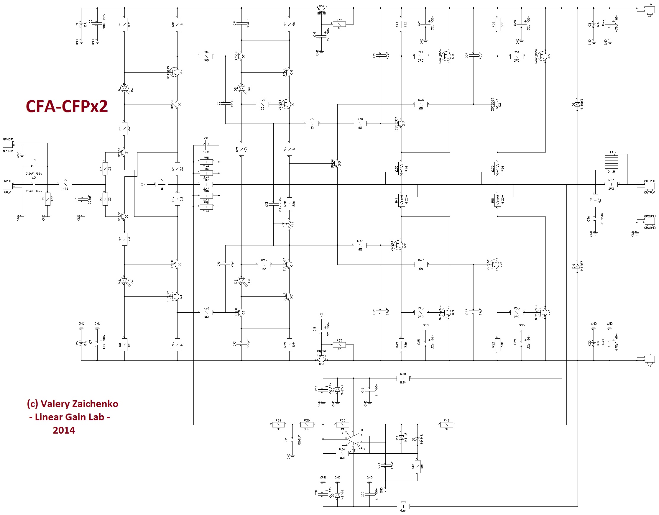

Couple of improvements - v0.7
OK, this one seems to be final for this design
Slightly modified input section to allow high performance low voltage BC5XX, switched to non-inverting servo, connected to low-impedance input and - most important - moved to double-drivers configuration - approach, similar to the one used in Alchemist Forseti APD15. Separate driver for each output transistor.
Roughly 30-50% lower distortion, same high stability margins and closed loop responses.
Working on test PCB layout...

P.S. A bit of a surprise for me - this double-drivers approach shows slightly wider open loop bandwidth = better 20KHz performance
Valery
The output transistors see a lower source impedance and this is reflected as a smaller time constant with the transistor capacitance.
I choose distributed drivers for other reasons but found this a nice bonus.

Vzaichenko that is a cool circuit but it's not simple
Andrew, it was rather simple in the very beginning, now - I agree - it's not that simple, but still "cool" and "clean" enough
At the same time - definitely more mature, rather compact in terms of PCB size and easy to build (at least, I try to keep it this way )...

@vzaichenko:
C10, C18, C11, C19: Local feedback, which I've dubbed (Bode) Step compensation. Those give you more GM at cost of PM and adjust the slope of the step. Can you verify this?
Edit: never mind, this is a CFA and so you won't see these effects much.
Well, those caps just move both curves (gain and phase) to the left - roughly 1MHz, so I don't see too much influence on overall PM/GM. However, they prevent the CFP pairs from potentially oscillating locally - as you just mentioned...

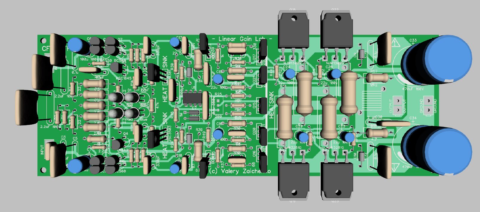

PCB!

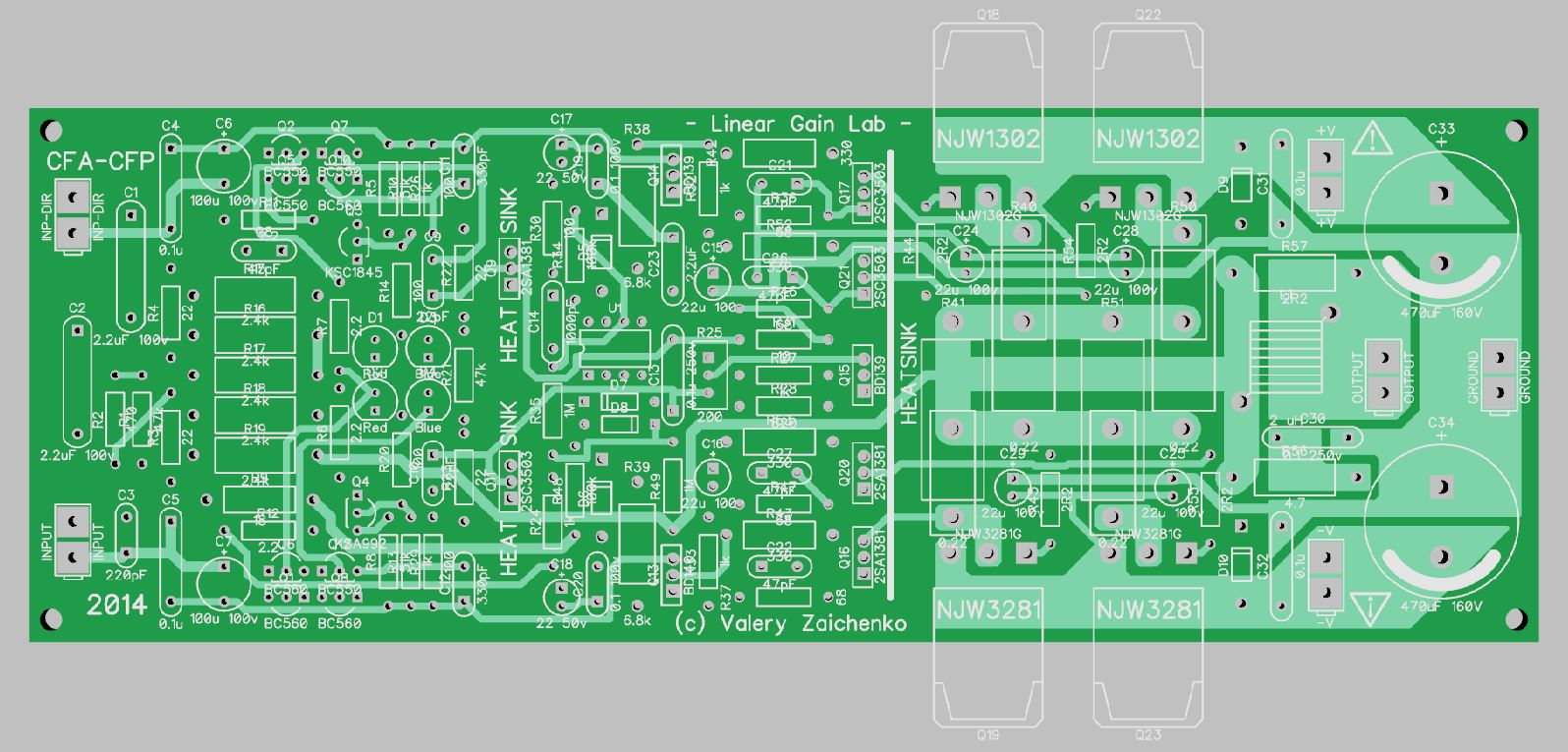

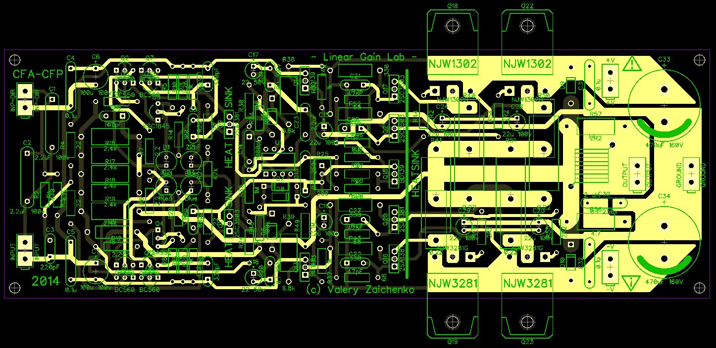

OK, here comes the layout...
8.5 x 3 inch, double-sided. Not really simple any more
However - still pretty cool
Placing the order tomorrow... takes about a week to produce.
And then we'll see...
P.S. Big ones are actually under the board - 3D renderer just can't show them the right way Anyway, gives an impression.
