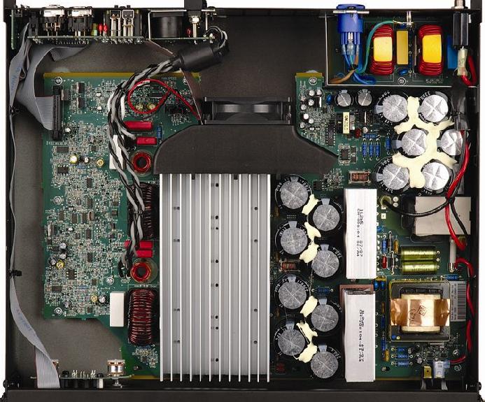

From a well know big brand… +VCC is about 200V regulated.
And please, forget the clip stuff; it is not admissible in a well designed amplifier.

http://www.crownaudio.com/pdf/legacy/CE4000Schematics.pdf
Same guys… but floating (page 7) and no direct over-current detection…
Input signal limiter on page 1,18,19…
PFC Smps page 16,25

http://www.crownaudio.com/pdf/legacy/k-series_servicemanual-schematics.zip
Same guys again… floating and no direct over-current detection…again..
Hei…!!! Floating supply is from AC line ???....
Nice to see that Crown is still using their BCA topology
..and they do not switch with unsaint speed, which is making parasitic inductances and capacitances less critical... Their solution is a clear statement that giant di/dt and dv/dt tend to cause evil...
Floating or not: From the schematic we cannot see how loose this floating really is. The parasitic effects of the transformers and PCB are not visible in the schematic...
But obviously it is possible to work with active floating supplies.
