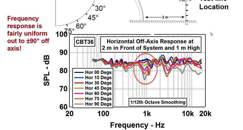

Remember how and where this is measured. If we are going to compare real data, the speakers need to be measured identically and under correct conditions. Right?geez... what a mess! can't You see it?? fairly uniform ????

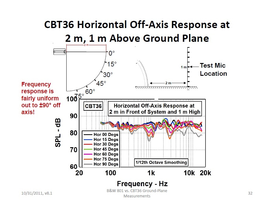

Here's some measurements of the CBT. On page 31 there's a horizontal off-axis ground plane measurement. Still seems to show some diffraction issues.
so this is actually a ground plane measurement by Mr Keele Himself and as such it doesn't include "the room's comb filtering", does it Omholt?

It's a classical collapsing polar response. Not very uniform.
What are you talking about?
The off axis FR falls uniformly.

This one is measured in a room with uneven floor and includes the room's comb filtering.
From http://audioartistry.com/brochures/B&W 801 vs. CBT36 Ground-Plane Measurements v8.1.pdf: "Impulse responses were windowed with a 50 ms half‐Hann window"

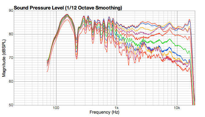

The vertical dispersion problem of a typical two-way box now has become a horizontal dispersion problem in the CBT (see attachment). What's more important to you? Horizontal or vertical smoothness?
in other words: "These measurements assess the sound field generated by the systems when operated in a non‐anechoic environment but over a reflective ground plane."
so much for CBT as any sort of a technical revelation and Holy Grail solution

There's not much discussing when you guys cannot see that measurements in a normal room with uneven floor effects it. Looks like you already have decided what you want to see but you may be judging on wrong assumptions.
My experience tell me that CBT meassures overall flatter then a good waveguide, even in small rooms. I have not seen the waveguide being clearly flatter at any frequencies, but they were about the same above 4 Khz. The impulse response is also very clean, but perhaps not as good as a Geddes speaker.
And I think you seem to fail to grasp the importance of reflected energy being close to the direct signal and don't understand that a polar response that becomes narrower and narrower is an effective EQ of a system. Which psycoacoustic studies tells us that a narrow treble dispersion is favorable? Aren't they telling us the opposite?

"Uneven floor"? The floor shown in the linked PDF is not uneven at all!
