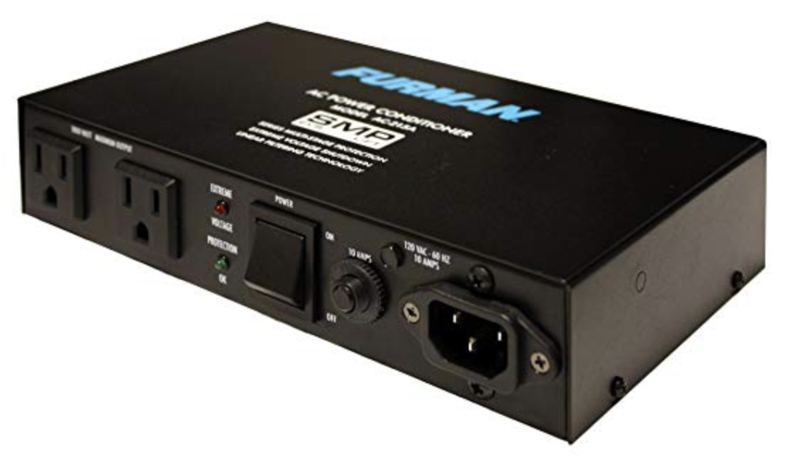

Methods tried:
1) Filtering line noise into the DAC. This definitely removed some sources of disturbance to the DAC registers. I isolated the DAC from the rest of the power line using a Furman AC-215A power conditioner. (image below). [I also filtered line current into the amps with a less aggressive solution but it didn't help.]
2) Bypassing power switches on all the sound equipment. Even isolated, the DAC could change configuration based on simple static discharges from being touched in dry weather. Also when powering other sound equipment on/off, there was a chance of unpredictable behavior. I added 3 inexpensive logic-controlled power outlets and haven't had a single 'surprise' since. (outlet image below)

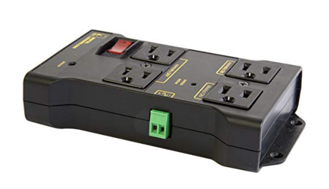

Wireless control of system power:
I decided not to run the BBB/Hermes/Cronus 24/7 because that meant changing too much of an otherwise good power chain. Instead I added a second single board computer to run full-time as a controller for power outlets and server for an 8T media disk. An Odroid N2 worked great for about a year until its networking chip died. I recently replaced it with a less-costly RPi 3B+. The RPi is perfectly adequate although required changes in the python code from what worked with the Odroid N2.
The Python code:
With the changes made for the RPi, I finally removed the last couple bugs from the code. Fresh versions are now available on my GirHub page. 'netio_server.py' runs on the BBB, while 'System_server.py' runs on the RPi. I realize that few DIYers, if any, would duplicate my hardware. The reason for putting the code up is to help any other non-programmers (like myself) with working solutions that could apply to their unique projects. For example;
a) wireless control of outlets doesn't require any custom interface because these products operate with the minuscule current from RPi GPIO pins - they are plug-and-play and the control code examples are straightforward;
b) the RPi and the BBB communicate during startup/shutdown to make the process safe and orderly - especially relative to amplifier power up/down;
c) both the BBB and the RPi wireless controls are on the same control screen on my remote devices - convenient and easy to use;
