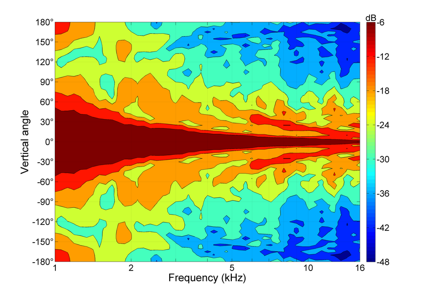

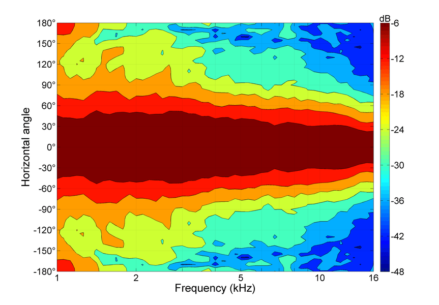

Yeah I had a look but the issue with my array is the strong curvature relative to the depths of the horns ruining the horizontal pattern control. It would work better if the array was less curved, longer, deeper horns etc. CBT arrays also use attenuation of element groups which is not ideal for PA speakers as its reducing output.

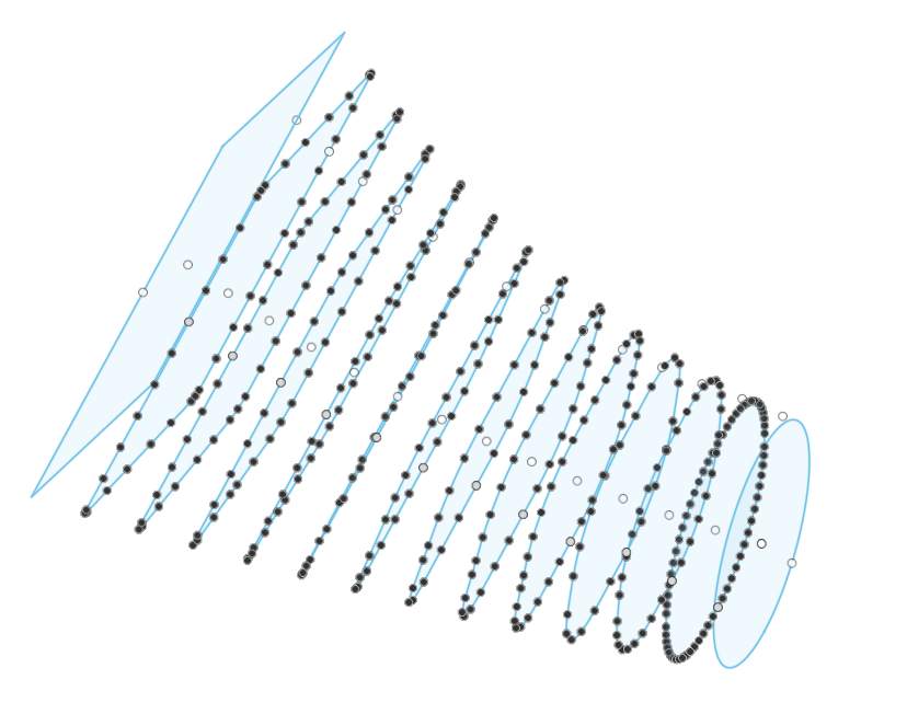

So I have been trying to make the delay from the compresion drivers throats (circles) to the horn exits (x's) equal to the wavefront curvature (spherical cap) at the location of the horn exits for a 60 degree conical horn and found this does not directly work. The error function looks a bit like this as the exits are moved to the right of the plot away from the compresion drivers:
so no minima quickly emerging. This is actualy for the 3D case with the drivers having the alternating left right offset but I have presented a 2D diagram for simplicity. I think perhaps I have overly constrained the problem by forcing the exits to expand verticaly as they move further away from the compresion driver throats to be positioned equaly spaced in a virtual 60 degree horn. Wheras in reality if the line of exits was shrunk verticaly this just reduces the spherical cap radius and so this is not linked to the axial position of the exits in the virtual horn. So in order to arrive at a solution where the horn lengths are correct I can:

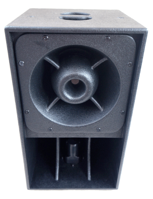

But one question, looking at the picture at the beginning of this discussion - why don't you just use a B&C ME464, the fitting driver and call it a day? https://bcspeakers.com/en/products/horn/1-4/0/ME464
Of course it's way more boring than what you plan here but will look great with the rest of the PA

The B&C ME464 would be an excelent and high fidelity solution.... however I want to cover crowds of 50m depth (at least eventually). We will make 4 new midbass horns and fly them with 4 of the speaker under design here. We see ~112.5dB/2.83V sensitivity for the HF driver of the DCX464 and 160W power handling resulting in a max 1m continuous output of ~135dB, at 50 m this is down to 101.02dB (even ignoring air attenuation). We are normally running around 93-96dB LEQ (A weighted, 5 mins) so we would be running into limiting trying to cover this theoretical crowd and loose dynamics. However more importantly this lacks scalability as it is the maximum that can be done with a single driver horn solution, if I crack HF driver combining then output becomes close to unlimited. Mostly though I do this for fun*, if it was just a job I would buy off the shelf stuff

In general, the though on the design here is HF coupling within 1/4 wavelength. Yes, a single ME464 can do well at the same volume as several drivers coupled together, but over distance the handful of HF drivers are going to stay together better with the rest of the drivers in the box. More usable SPL at greater distances while staying in phase.I'm late to the party - you do really good work here!

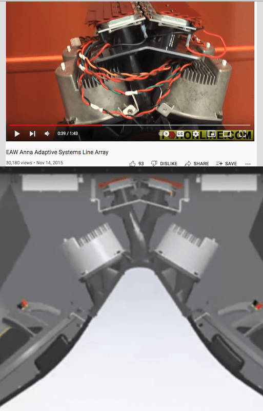

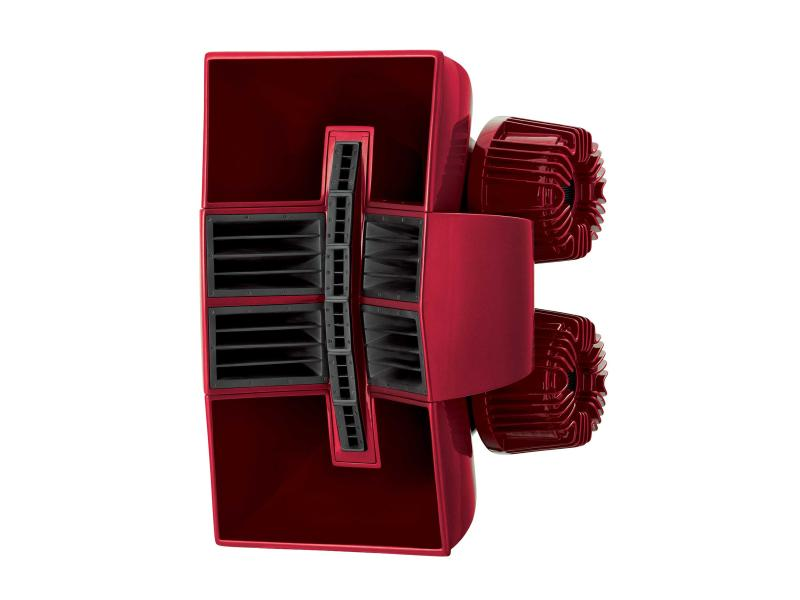

@kipman725 I've been doing a lot of backwards geometry lately on the J7/J8 based on photos and what has to make sense to work. I made some progress on that interior short horn. Now to build a working model. The HF drivers will have to be angled on the top and bottom to aim straight-down the throat, but besides that it shouldn't be too difficult to build.
Here's how I got here. 2ftx2ftx4ft box with a 90 degree x 50 degree horn. The horn is 90 degrees, so that means 45 each direction and from the DSL photos, I jumped to the conclusion that they taper off about 2/3 of the way through to add an extra 22.5 degrees at the end of each side. With those dimensions, the interior could only be so deep.
At this point, I'm calling the main section of the horn the "large horn" and the interior the "short horn." Since they switched to using FaitalPRO's HF108 driver for the highs, we can see that its 31 degree exit angle will fill the short horn a few inches from the HF driver. This means that the mids have some space to tap in, but that's going to be crossover-dependent. Here's where I'm a little caught-up. I'm not sure how to properly size the taps for the mids. Are they supposed to be 1/8 of driver Sd? That would put them at 1 & 3/8" for the Beyma 6MCF200Nd, which means they can't tap in until near the end of the horn based on physical size of the hole, which may affect how low the HF can be crossed over to the mids. If I used two holes at half the size, one would be entering the short horn before the other which may cause issues.
The dotted line on the photo above is the 31 degree exit angle of the HF108. The white circle is 11/16" (half of 1 & 3/8"). So if each driver is tapping into each short horn once, then we're golden and I have 1/16" of driver sD that I can place pretty close to the HF entry point for a higher crossover. BUT - since each hole is 1/16 instead of 1/8 sD, does that mean that I'm not getting as many lows through that tap? At some point, I need lows to get down to about 400~600Hz so that they can exit the short horn into the large horn and the 10" lows can take over and properly cross over. Are my mid taps too small to do that correctly? Perhaps slotted taps would work better?

I see one difference between your horn and the danley horns. In the danley horns the drivers are not all in the same plane but are on a curve. See this picture from earlier in the thread of a J8:
