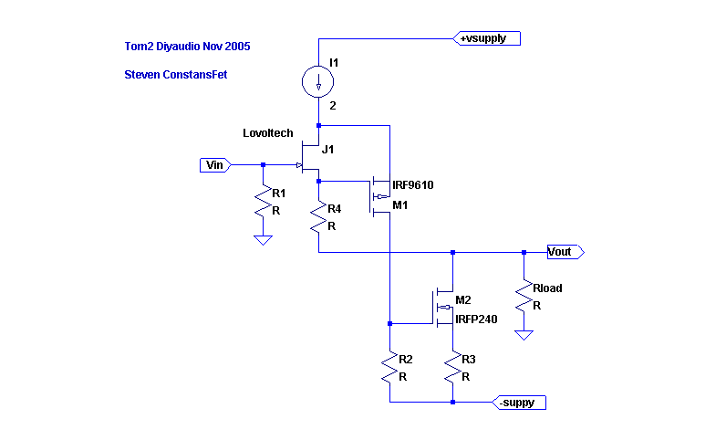

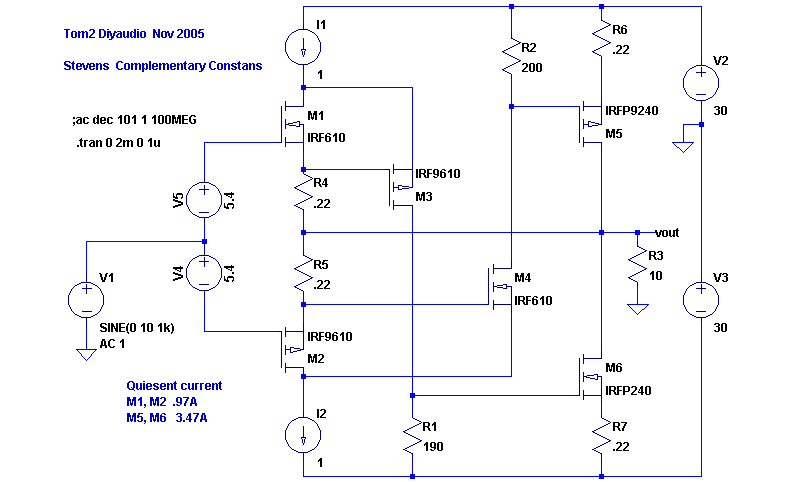

I am very curious about how a complimentary version would look like.
I understand your concern with the circuit working. I would think it might suffer from latch-up at turn on.
I did the circuit with mosfets. It seems to work. I don't how accurate the models I use are. I played around with transistors and it sometimes worked. I used caps across the c-b output transisitors for compensation to get the circuit stable when using transistors.
It gets tweaky using a simulator.

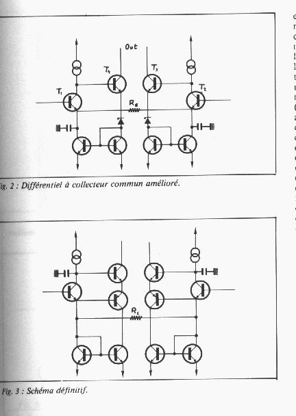

When exploring more linear input stages than standard differentials Gérard Perrot (Lavardin) became aware by some IC designers that there exists a "bipolar enhanced emitter follower" which was commonly used in IC's : both input (controling device) and output (controlled device) transistors are of the same polarity. It should have a lot less temperature drift than a CFP. In a CFP when current in the input device becomes larger, the current in the output device becomes larger, too.
This is the contrary in the enhanced follower which is very similar to the circuit shown by TOM2 with a few more elements to correctly polarise the bipolar junction transistors. The snag is that a CFP uses only two transistors and an enhanced follower uses three active devices, at least. However the circuit shown by Perrot has a slighly larger bandwidth than a CFP, probably due to a higher current in the input transistor.

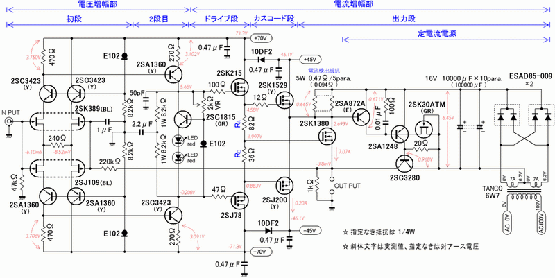

Bernhard said:My idea for the moment is to have a low voltage psu with floating ground driven by a classAB amp ( Instead of the cascode ).
That would provide the constant voltage both for gain device and CCS.
Without that, the constant power topo looks like a big room heater to me.
Hi Bernhard,
Something like this?
http://www.ne.jp/asahi/evo/amp/2sk1380/report.htm
This circuit is from Shinichi Kamijo. Your idea triggered my memory about this amplifier. Actually it looks a lot like the circuit I proposed, but instead of the folded cascode and current source, he uses a floating low power supply voltage, which allows for a different way to force a constant current through the output FET (the 2SK1380). Looking at Kamijo's website, I think he is one of the most innovative amplifier designers, and a very productive one too.
Tom
Hi Tom,
Exactly the same circuit topology I had put on paper, only with BJTs. But I had strong doubts about the (DC) stability, so I set it aside. In your circuit M5 and M6 will fight against each other, and instead of just forcing a current through M1 and M2, just as easy a big (almost uncontrolled) current will flow from M5 to M6 (cross conductance).
The Lovoltech power JFET is indeed a nice candidate for a Constans amplifier. It can handle big currents but its voltage rating is limited. The folded cascode takes care of that. BTW A group buy is going on in the Pass Labs forum for such a device.
Steven

HI FAB
"Where do you find these info on Gerard Perrot.s circuit?"
In the french magazine "L'Audiophile" n°43, 1st trim 1988.
In his articles, Perrot studied some kinds of differential input
stages looking for high linearity (see his patent for the
finally chosen one) and then good subjective rendition
with a phono cartridge input !

Hi Forr,
Thanks for the info!
Yes I have already a copy of the patents. So it means that the circuit you have provided is an earlier version. I used one in its patent (for my own personal use). Anyway, the amp input circuit in the Perrot patent is also used in Halcro patent.

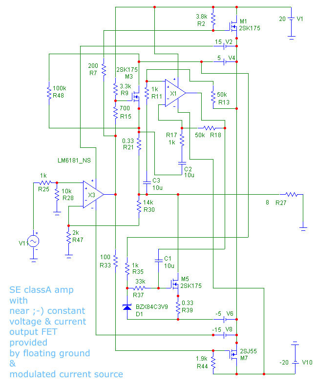

- const. voltage & const. current on output FET ?
