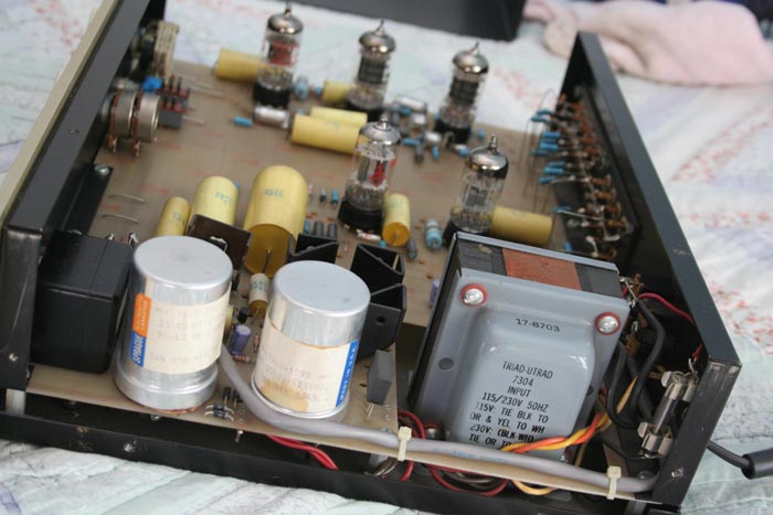

I have a problem in my C-J PV7, it sometimes turn off and restart automatically. It means that I must wait 45 seconds about (warmap time) before the music restarts.
It is possible that the SPRAGUE capacitors (TVLU 1095) in the PSU are exhaust?
Someone got the schematics?
Thanks in advance

You can certainly still find equivalent Twist-Lok electrolytics, but at the cost of not being "vintage," one can replace them with more modern caps of the same capacitance and voltage. Look for 105C rated capacitors. You'll be surprised at how much smaller we make them today.

Possible, and I'd replace them anyway, but it's more likely in the soft-start/mute circuit or the regulator. But bad caps can still be the root cause.
I don't like Twist-Loks in general, so that's like asking me about my favorite rap artist. :D
Dhaen's point is well-taken: get a schematic, and troubleshooting will be much easier.

You can find the schematics of the PV6 and PV10 versions here
http://www.drtube.com/audioamp.htm . The schematics should give you a pretty good clue as to your preamp.. From what I can tell, mulfunction may be somewere on the primary side of the transformer (if the "pilot" lamp turns off at the reset moment) or inside the "delay output on" circuitry.

In my experience, Conrad Johnson will email you a scan of the schematic if you ask them nicely.
When asking for schematics it normally it helps to give the serial number as proof of ownership.
Yes, the led turns off at the reset moment.....
anatech said:
As I recall, they were using film caps for the B+ filter. Lower value of course. Also, every CJ I've looked at had the heater filter cap opening up. Check that first.
