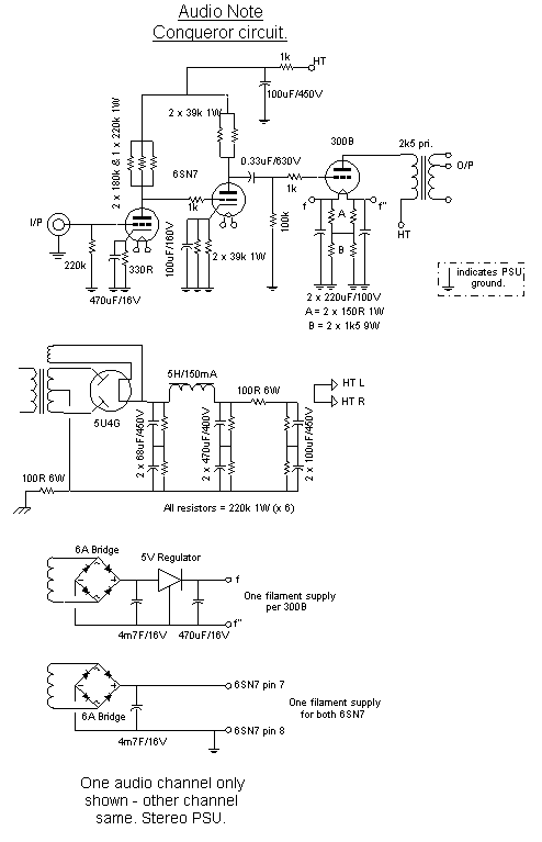

Conqueror schematic
Guess I found it.
found this old thread. I`m preparing to clone AN Conqueror. Maybe someone of you could help me out with mains voltages@amperes...
I found out that Couest signal circuit is identical and 5u4g there gets 380-0-380 of input.
But than again Conquest is identical (except for paralel triode) and OPT) too and there is 425-0-425 on the same rectifier.
