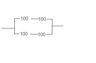

You really only need a single 100 ohm resistor, almost no current flowing through the screen in triode connection, but what you have done is ok.

Yes this is true, but the small metal film ones that DigiKey sells function like heavy metal fuses. You play Metallica at full tilt and they blow! I zapped 3 of them, then I switched to 1 watt carbon film, no more blown resistors.

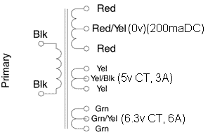

Well it should be clear by now that the heater voltage is not nearly enough!
I hope the my wireing is at fault, and not my power transformer, as one is far easier, and cheaper to fix than the other

Yeah that low filament voltage would cause the sorts of symptoms you are seeing. Another clue would be a very dull filament glow.
No chance these were wired in series accidentally? The other thing to check if the filament winding has a center tap is whether or not this is connected in error to your tube filaments and the end which should be going to your filaments is instead connected to ground, left open or connected to the filament bias voltage network if present. Believe it or not I have done just this on an old transformer with faded wires.
Yep, that's it. Just use the two green wires and ground the green/yellow wire.
