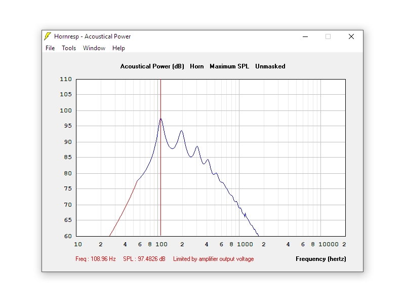

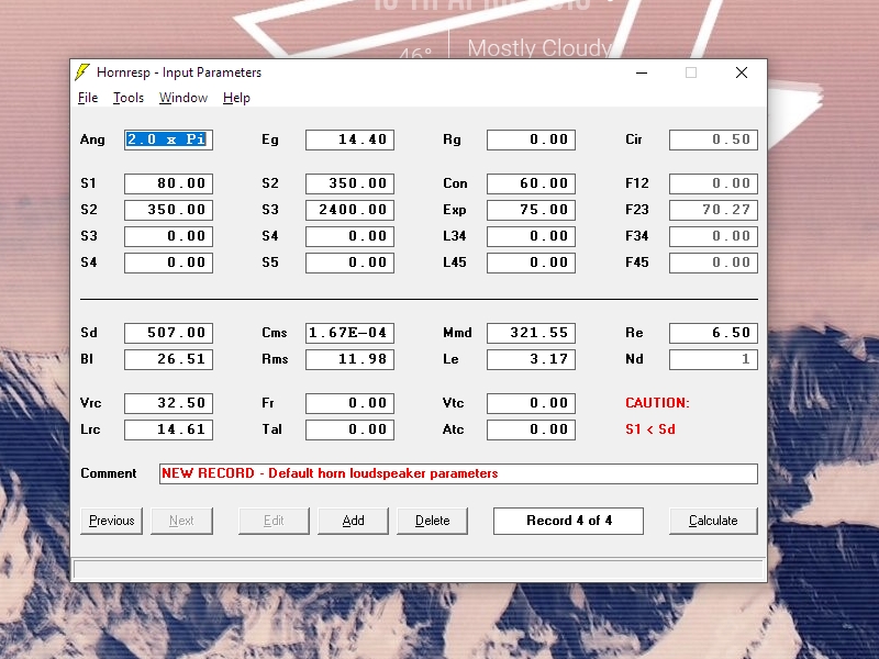

I must have done something wrong. I'm getting very low DB. Here is some screen shots.

It does not look like you entered your speaker's TS parameters into Hornresp, and you've modeled a horn rather than a sealed or ported enclosure.
To get a simulated response reasonably close to what you're cabinet and speaker are requires the proper inputs.
I followed the guide. Theres alot of data no provided on my woofer. Theres also alot of N/A sections that don't apply to my woofer. I've been messing with it for 3 hrs.

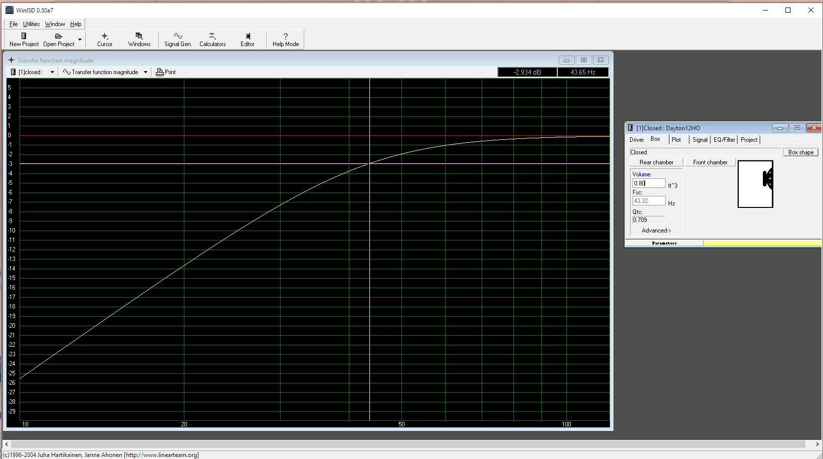

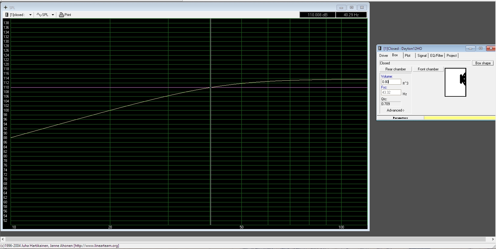

OK, have no direct experience with any of the parts or even putting a big sub in a truck, so the following is strictly based on published specs and comparing in vehicle response using a [once] popular JBL woofer's with a similar sensitivity as a general guideline: https://www.hobbielektronika.hu/forum/getfile.php?id=189513
Yes, your HO specs are way off. The easy way to input them is to double click on the 'Sd' field and a window will pop up for you to input them. Note that it auto calculates Qts.
I guessed that two would take up approximately 0.3 ft^3, so cab net Vb = ~0.8 ft^3 [ ~22.65 L], so actually either near perfect or maybe too small, though heavy stuffing can offset it if required or just use some low bass boost.
In comparing the response to the JBL, it rolls off quicker, but your truck may have more 'cabin gain' than JBL predicts in a typical car to offset it, indicating it might be too small, though at high power I doubt the difference would not be obvious at these low frequencies, though might sound a bit 'boomy' at modest playback. Again, the usual way to fix it is to add more internal damping.
Attached is my HR file, so download it and put it in HR's 'IMPORT' folder, then in HR click File/Import/Hornresp record, then double click my file and it will load as a new 'Record' for you to do as you please with it.
