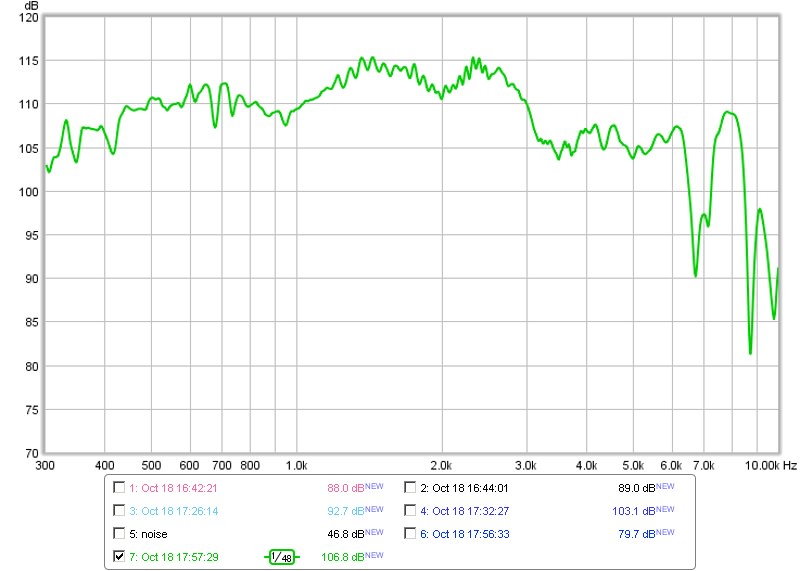

Some chunky compression drivers can do approx 400-6kHz at >105dB per watt. I have a single old Community M200, which I bought based partly on POOH taking it up in this thread. I tried it on a cheap 2" horn that I modded / extended, and it measures pretty well to 6k, I somehow got more HF bandwidth than is shown on the spec sheet: image attached.
I didn't experiment much with it. I assume DSP would be essential if you wanted to use it to 6kHz.
Yesterday I found another orphan M200 on ebay ($60), so I should eventually have a pair.

Sticking one on a large horn with 2" throat, there is lots of gain, but only over a ~2 octave range. In this configuration, it needs a dose of EQ to act as a wide band driver. I am yet to try it on a larger throat. My expectation is that a bigger, asymmetric throat (e.g. 5*10cm) will give me another octave of HF.
I will be surprised if I ever get them flat to 6kHz (without eq). What I'm expecting / hoping for is lots of gain 300Hz-1500Hz, and then another octave or two of lower (but smooth) response that is easy to EQ.
