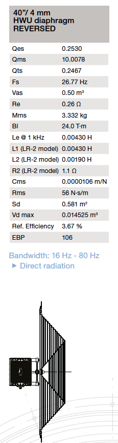

Bill,
As previously stated, LP SmartSide is a wood product that is basically completely impervious to the environment- I have used it, unpainted, as an outdoor sidewalk directly on the termite infested ground with virtually no degradation over a period of 16 years.
The M-Force 01 with the 40" cone appears most impressive at a 3.67% efficiency as a direct radiator.
I have been reading about the M-Force moving motor concept for a few years, but have not heard any of their units yet, have you?
Art
Not yet. During my discussions with Power-Soft's US representative, the 30" cone was recommended for use in a large bass horn. The polypropylene cone is ideal for this particular outdoor application as it is impervious to all the hazards. The TSPs look suitable for driving a horn load as well.
For this project, how the frequencies above say 80 Hz. are reproduced is where the acoustic challenges are to be found. Below, the challenges are primarily those of concrete placement.

3)Not yet. During my discussions with Power-Soft's US representative, the 30" cone was recommended for use in a large bass horn. The polypropylene cone is ideal for this particular outdoor application as it is impervious to all the hazards. The TSPs look suitable for driving a horn load as well.
4)For this project, how the frequencies above say 80 Hz. are reproduced is where the acoustic challenges are to be found. Below, the challenges are primarily those of concrete placement.

M-Force Revisited
@Whgeiger The Powersoft Cones and M-drive are already used in different horn applications, bandpass and frontloaded designs from different brands. Function one F132, PK sound Gravity, D.A.S. Audio SF30 are a few of them that used the Powersoft design.
Thanks for the input.
I am aware of Tony Andrews effort to use M-Force drivers. Funktion-One | News | Funktion-One and Powersoft combine for new level of bass performance
Note that even when arrayed, the footprint will be much smaller that what the OP is considering. WHG
