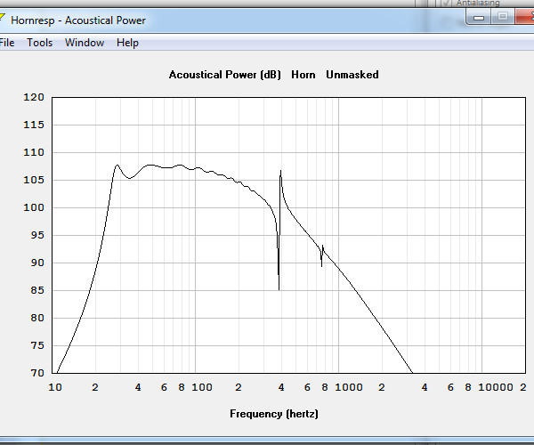

I don't think we needs the plans.
If you want an accurate sim you do. Your sim is not even close to accurate, it's like comparing a golf cart to a motorbike. Sure, the are both transportation vehicles but there are very significant differences.
It was an exponential horn.
Already the problems start. He said very specifically that he thought it was silly to carefully calculate the expansion. "Exponential" has a very specific meaning and flare rate - since he just built something that looked vaguely exponential and didn't document the actual flare, we have no way to simulate it.
You might think it doesn't make a big difference but it does - it affect everything, including the volume of the horn enclosure. And when coupled with all the other little fudge factors in your sim, the end result isn't even close.

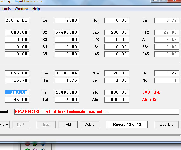

length about 17'
Again, not specific, and it does make a difference. "About 17 feet" could mean anywhere from 14 feet to 21 feet. He's showing that he's not overly concerned with the details, so why would we trust the dimensions of the stuff he didn't even bother to measure?
In that thread he specifically says "Length was about 15 feet. Mouth area was about 68 square feet." So either you got the dimensions wrong or he is posting different details in different places. This stuff matters. A lot.
throat size (based on the info I quote here - but I left off the vent)
"I used ~1:1 compression ratio, including the vent area as part of the driver area.
This is perhaps the biggest problem. You left the duct that connects the rear chamber to the horn path completely out of your sim. That duct changes EVERYTHING.
And that's not the only problem here.
His actual statement was "The compression chamber was vented into the throat of the horn, which no doubt helped the low end. I don't think you can sim this with hornresp - maybe with akabak."
But when you look at the picture, it looks like the rear chamber is ported to the outside, not into the throat. Maybe it's vented to the outside AND into the horn throat. Either way, these details are VERY important and far from clear.
And a final problem - he said "I used ~1:1 compression ratio, including the vent area as part of the driver area."
Assuming it's end loaded and not offset (which is a pretty good guess I think but not necessarily true) with the square segment construction he used, it would be IMPOSSIBLE to make the compression ratio anywhere near 1:1, it would have to be a lot lower, maybe even 1:2. Here's a visual to help out with this issue.
The black square is a cross sectional area of the horn throat area where the driver is mounted. The big black circle is the outside diameter of the driver. The red circle is the actual Sd - a bit smaller than the outside measurement of the driver. The little black circle is the duct that connects the rear chamber to the horn throat.
Even if it's built to tight tolerances like shown here the square area of the throat is WAY more than the area of the Sd (red) and also way more than the area of Sd + duct.
Therefore, it's almost impossible to conceive that his estimation of 1:1 compression ratio is even close to accurate.
If it's not accurate, your whole throat area in the sim is inaccurate, and the implications of that are HUGE. Change your S1 to 1600 sq cm (which is definitely within the realm of possibility, probably a lot closer than 800) and see what happens to your sim.

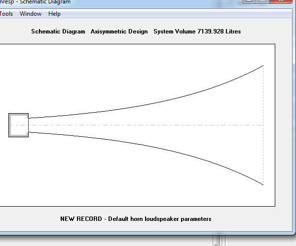

Rear chamber guesstimated from the photo
I'd say your guess at the rear chamber volume and dimensions are way off. It's not a good idea to guess anyway, this is why you need plans.
...and I have attached shots of what I get from banging those values into Hornresp. It looks pretty OK to me, and does indeed model exactly as described: a good 30Hz horn. It looks lots better than a toddler's scribble.
