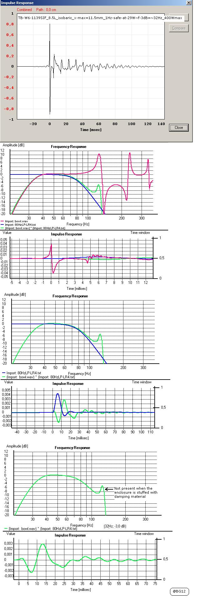

Concept, Beolab 11 style isobaric sub using Ikea Blanda metal bowls.
Adding a picture where the ported enclosure is (sub) filtered at 80 Hz using LR4 LPF:
The small ripple seen in the off-band will totally disappear when damping materials are added.
b:)

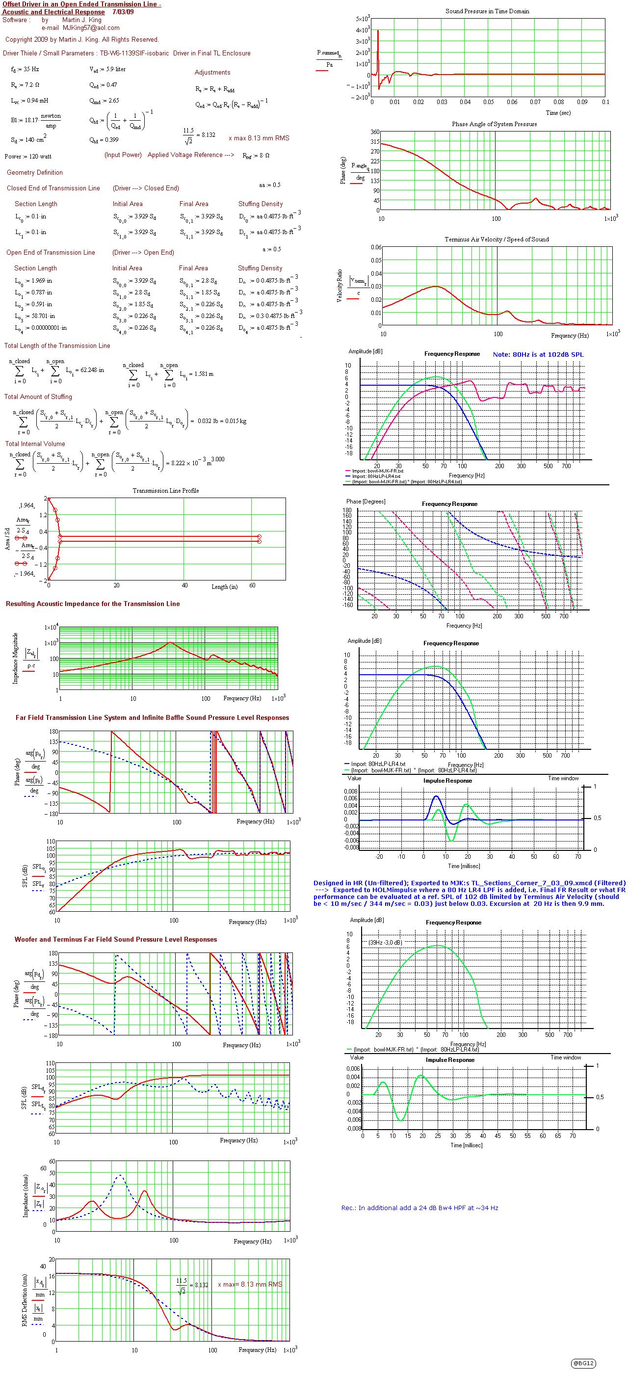

..The small ripple seen in the off-band will totally disappear when damping materials are added.
This fact can be seen here:
b:)
PS: My posting to this thread was not in the first place to show my weird 'Bowl'
design but the supplied 'rookie' calculations of the consequences when
using the TangBand driver in different configurations.

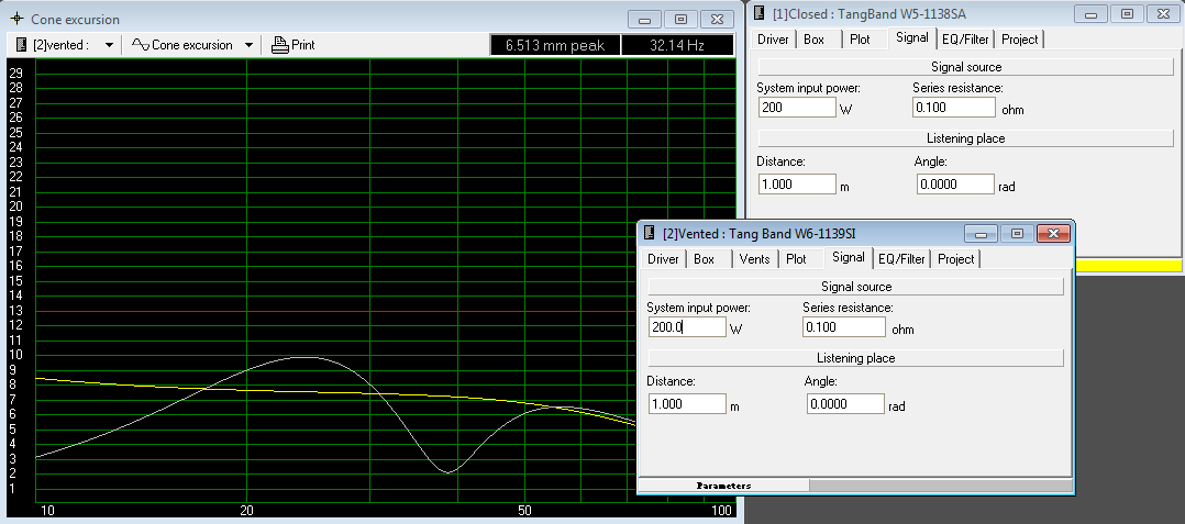

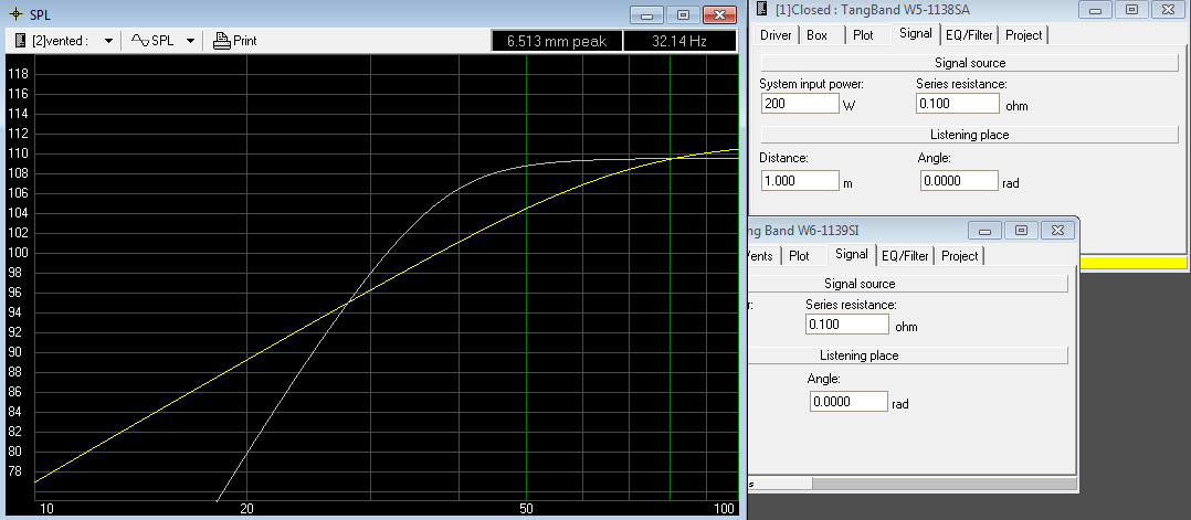

Ran some quick numbers using the older version of the 5" woofer (the specs of the newer one are similar).
4 of those drivers (total) in a 22L (again, total) sealed cabinet without slot loading would give a Qtc of 0.75 (slight rise in response - nothing to worry about).
Keeping excursion sane at a mere 5mm one-way would give a SPL of 98dB at 40Hz. Remember winISD gives figures for half-space.
I've done a comparison between 4x 5" drivers sealed vs 2x6" drivers ported.
With a suitable highpass added to prevent the drivers bottoming out below port tuning, the pair of 6"ers appear to win this one - see attached. Note the Xmax for the 5"ers are ~9mm, so both systems are being pushed hard here.
If you're willing to go ported, the 6"ers would better use the cabinet volume IMHO.
If you want to stay sealed, the 5"ers will give decent performance. You might like to read this - rather useful information about getting the most out of a sealed subwoofer.
Chris
