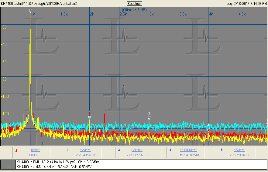

Sound Card comparisons
Here are measurements made with two soundcards and an external interface. The two cards are a Juli@ in balanced interface, an EMU 1212M in +4 balanced and an external AKM5394A ADC demo board connected via SPDIF. The EMU has had its opamps upgraded to LME49880's. The AKM5394A has LME49710's and the Juli@ has its stock JRC's. The biggest difference is the noise floor. The Blue is the Juli, about 15 dB higher. It also has a stronger third harmonic, which seems to be a signature of the JRC opamps.
Not easily visible is that the distortion is pretty similar between the three cards.
I find the Juli@ the simpler of the three to use. There are fewer options than the EMU but it just works and is straightforward.
I have an RME Hammerfall 9652 but its analog input is identical in performance to the Juli@ so no need to measure it.
