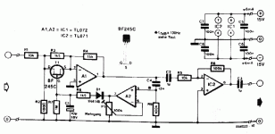

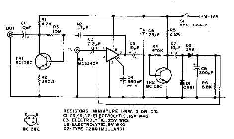

Hi Jon, I don’t want to spend lots, but can go higher if there was an advantageFor TV sound ... is it worth spending lots on it concidering the sound quality from a TV?
That Sony circuit is interesting, thanks
Thanks RMJ1, the latest DBX compressor is only £140, so in budgetdbx117?

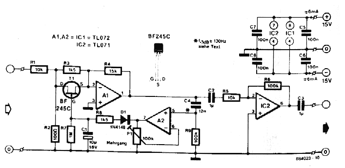

I have found broadcast TV sound quality quite good on the main HD channels, but we use this for streaming, DVDs and Blu-ray too so it needs to be decent
That circuit is interesting, won’t do what I want as no stereo linking, but could be adapted - it’s weird without stereo linking as loud sounds on one channel cause the sound to shift to the other speaker
I don’t think it would be better sound quality than my Behringer, but not far off and would be an interesting project in a much smaller box. I might have a go when I get some free time
