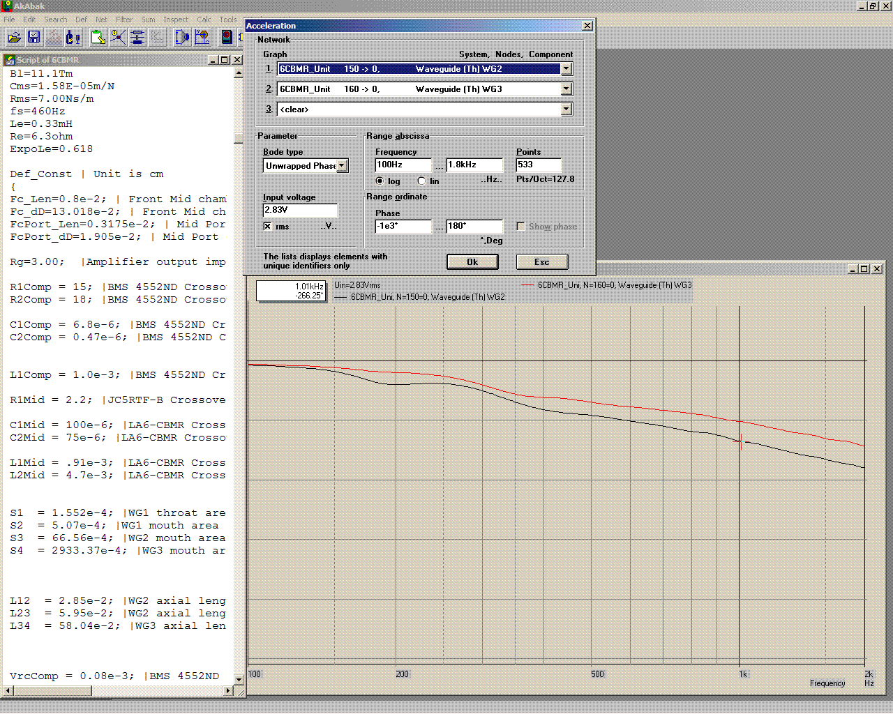

JLH/GM/Bateman/Synergy experts, please slap me,
the frusto thingy is designed to:
1. low pass filter uper harmonics by air chamber inside port plus inside cone
2. of course as midrange sound exit, but it is small enough to make it invisible to HF, yet large enough to avoid port noise / high port velocity.
did you do simulation of this box? why not using delta pro 8a?
I've simmed the basic HF horn and the sealed back (4th order) and band-pass (BP) alignments with theoretically ideal' reflex ports (didn't know they were called frustoconical though) for Unity/Synergy concepts, but not the complete horn system or the SH-50's TH (6th order) mid-bass system. AFAIK only AkAbak can do either of these and I haven't taken the time to learn it yet.
Frankly, while I find the SH-50 technically interesting, I'd rather have a larger three way horn with all BP alignments and limit the TH to (sub)woofer duty.
GM
I agree with John. When I built my first few unities based on looking at Tom's and the Lambda ones and doing some very basic modeling, the response was horrible. It wasn't until I simulated the horn in a Matlab script I wrote that I started to get decent response out of the mids. On a 3 way unity I built, it was still surprising how good it sounded after I eq'd it to have roughly flat response (with active filters). I will say that using a dsp crossover makes life a lot easier - you can get the response smooth during the modeling and then use time delay to tweak any positioning errors instead of having to potentially build another iteration of the design.

OK guys, you have effectively killed my hope and joy! :p
I have looked at AKBAK but i have not gotten in to learn how it work.
What i do not understand is how one can simulate something like this...!?
I mean.... you are talking about frustoconical ports, how do you simulate that?
And if you can, how to measure Vb in front of the membrane?
Surely 20% off in volume will do more harm than if you not cones the port-openings?

Sorry about that! For sure, its design is no trivial pursuit, but get a good grasp of compression/TH horn design to get its basics right and as noted, with DSP you can dial one in to get good performance at HIFI/HT SPLs.
It should become transparent once you've studied up on theoretically ideal Helmholtz resonator ports.
Well, you can calculate it by carefully measuring it as a truncated cone or mounting it to a thin plexi-glass plate with a hole in it to drip in a pre-measured amount of alcohol tinted with food coloring same as is done with engine cylinder head combustion chambers.

The typical method to simulate in a program like matlab or akabak (never used akabak personally...) or even Excel is to make an equivalent circuit model. You model all the physical parts of the horn and drivers as electrical quantities. Then you calculate what the impedance would be of all the elements. Then you calculate what the current would be for a given input voltage to that impedance. Then you calculate back the other way to see what the current would be in the horn which is actually a flow. From that you can get the pressure. You do that for a bunch of frequencies (hence the use of a computer program) and then you can plot the response curve. There are books written that describe this sort of thing - see Beranek's Acoustics or Olson's Acoustical Engineering for example. There are examples of horn speakers in there. The unity style horns need some additional elements like the volume of the horn throat in parallel with the horn from the midrange ports to the mouth and the port from the midrange chamber to the horn.
I think JLH posted his akabak script somewhere though, so maybe you could try looking for that. Here it is:
http://www.diyaudio.com/forums/multi-way/109568-unity-horn-script-akabak.html
My Akabak scripts have evolved quite a bit since then. The better I got to understand Akabak, I began to use more of its tools to make better designs. Being able to compare the phase of each driver at any point along the horn is a incredible tool.
