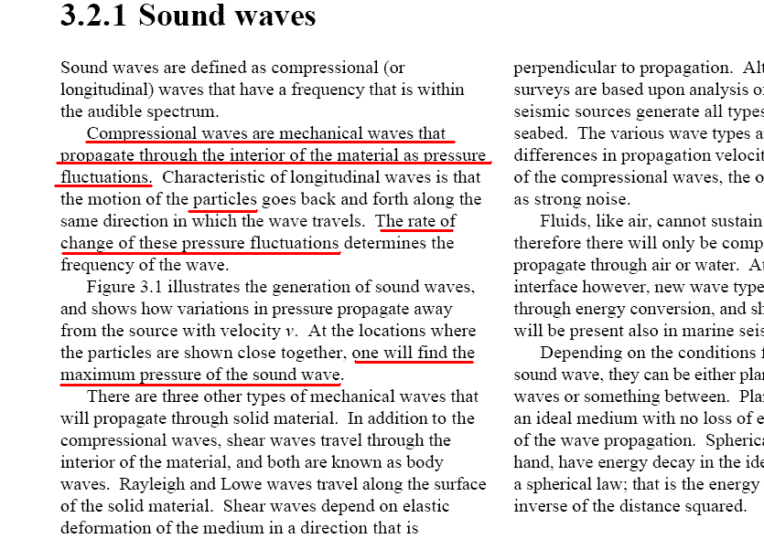

Sheldon said:
I seem to recall several, and I'd guess there have been more since I exited the premisis, but just for grins, here's one more: http://smub.st-andrews.ac.uk/seismic/pdfs/3.pdf
And taken directly from your reference:
Note the underlined in red.
more backpeddling here I see
noted...I wonder why they call them {compressional waves}??? Just a thought
...and this supports your position how?

MJL21193 said:And taken directly from your reference:
Um, yeah. I did note those passages. That's why I cited it.
"Compressional waves","pressure fluxuations", "at the location where particles are shown close together, one will find the maximum pressure of the sound wave".
What is it that is not clear about this referring to the compression of water as the mode of sound wave transmission? You may not want to believe what the author says, but you want to dispute the meaning of common words?
"Depends on what "is" means."
Are we present in the same universe? Can the meaning of words change anytime and for any purpose you want them to?
It says "pressure" not "compression" and in reference to the "particle theory" model, the particles are "shown" close together. I have said that as sound moves through water it forms regions of high and low pressure. Once again, pressure is not the same as compression.
I asked for a black and white, it is written this way, reference that says: "sound waves compress water" as the primary means of sound propagation through the medium.
