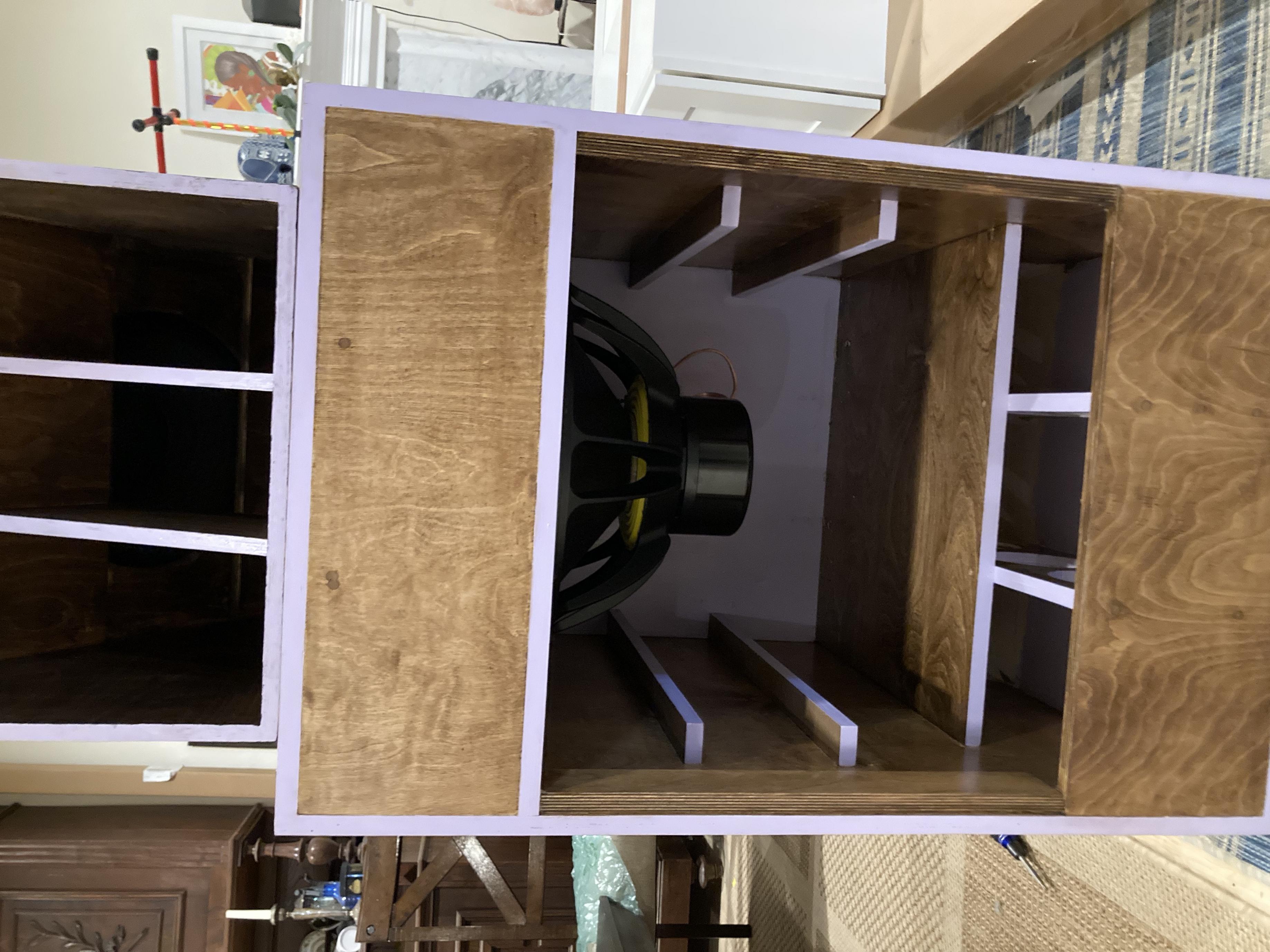

Will your driver have enough "throw" room for xmax or xmech with the braces just flush behind the driver mounting baffle?
It's tough to tell from the photo but the braces aren't flush against the empty space for the driver. There's a big notch cut into them so that the cone has way more clearance than it would ever reasonably need.
Here's a pic of the cab loaded and finished with some spar varnish. On top is a kick I built back when my woodworking skills were pretty bad. I have a mono stack set up to spot check the sound of the cab with some actual music and so far, so good. It does have what appears to be a weird resonance somewhere up top but that could honestly be my living room or the fact that I haven't looked at how the phase works out around the crossover point with that kick. (DSP settings right now still assume that I'm using a 15" bass reflex cab in place of the sub.) I look forward to getting the second cab completed and doing some sine wave sweeps with the whole rig in open air.

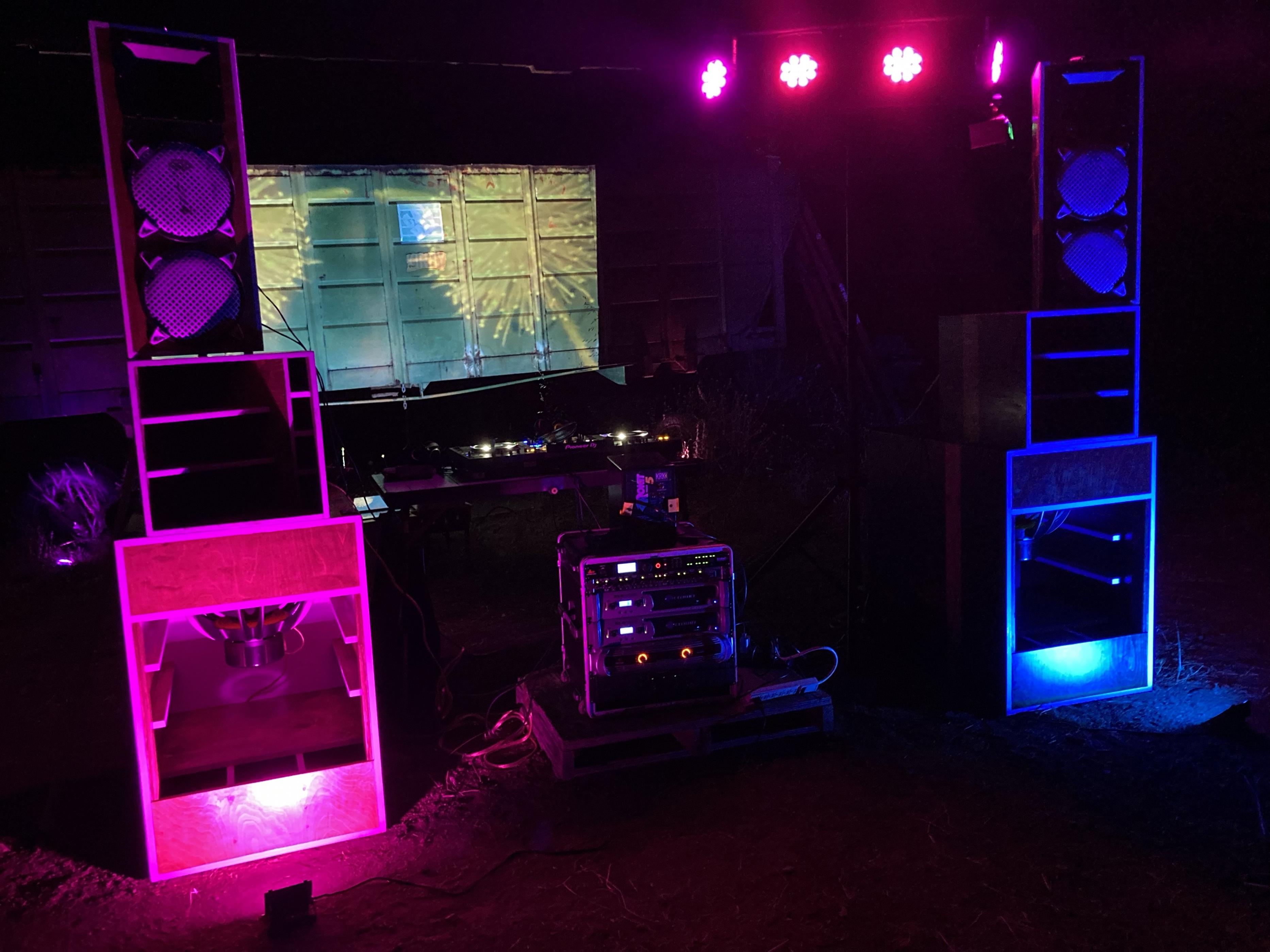

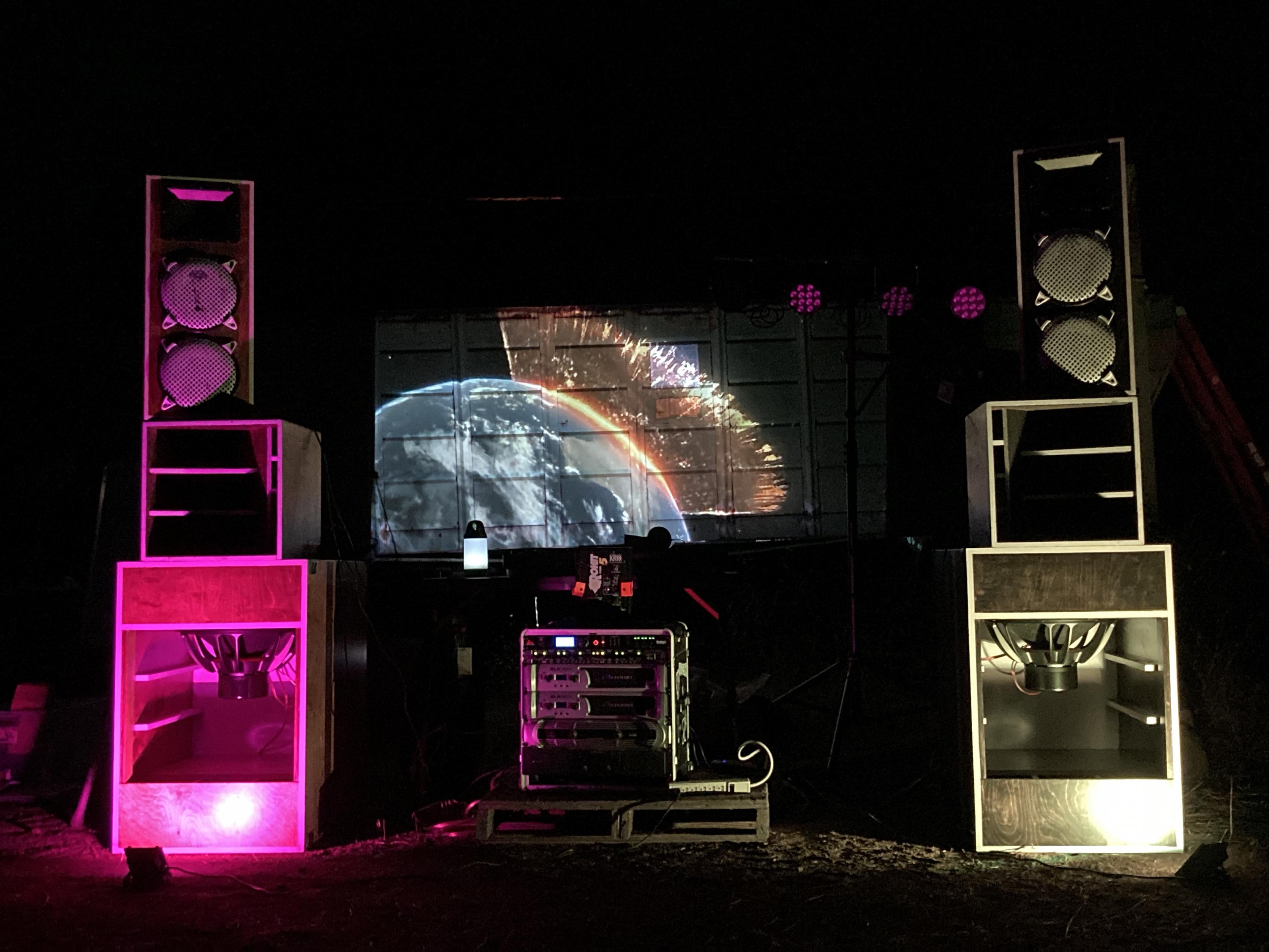

Handful of pics/vids from over the weekend with the two completed Type C cabs.
The sound is fantastic. I went hog wild with the measurement mic on top of a hill in Morro Bay last weekend. Frequency response is exactly what was advertised and it was really easy to EQ and integrate with the rest of the system. There was a big cancellation happening between the paraflex and the kick and once I added the right delay settings every kick drum felt like being jabbed in the sternum with a boxing glove when standing close to a stack. Excursion was under control all night even with huge bass drops that went very low. They are also surprisingly directional so when we pointed them towards a hill we were on instead of the valley below us it made a substantial difference.

Looking to the picture looks like you system is 4-way, is it right?
In general digital processors works with 3 way system, so maybe your tops are using a passive crossover and you feed them with 1 way (top).
Bass = 1 way
kick = 1 Way
Top = 1 Way (split 2-ways passively)
Good question. The system is 4-way active. We use a DBX driverack to split everything three-way and the 20hz-250hz band gets split again between the kicks and the subs by running that signal into a Behringer crossover. I can only imagine the biggest signal degradation happens there as a result, but the bass sounds OK to me.
If anyone can recommend a logical next step to migrating away from the Behringer, I'd love to hear it.
The tops can reach around 100 hz but the ports are in the back. I built them this way with the expectation that we could just run them at patio BBQs without needing any kicks, just a pair of 15" bass reflex subs.
I opt for the kicks outdoors because they make the rig taller, give us more dispersion control for those frequencies, and take a big load off of the mids. With a taller rig, we still have the kick frequencies at chest height, and everyone can still hear the mids and highs with good clarity even if a tall-ish man walks in front of a stack.

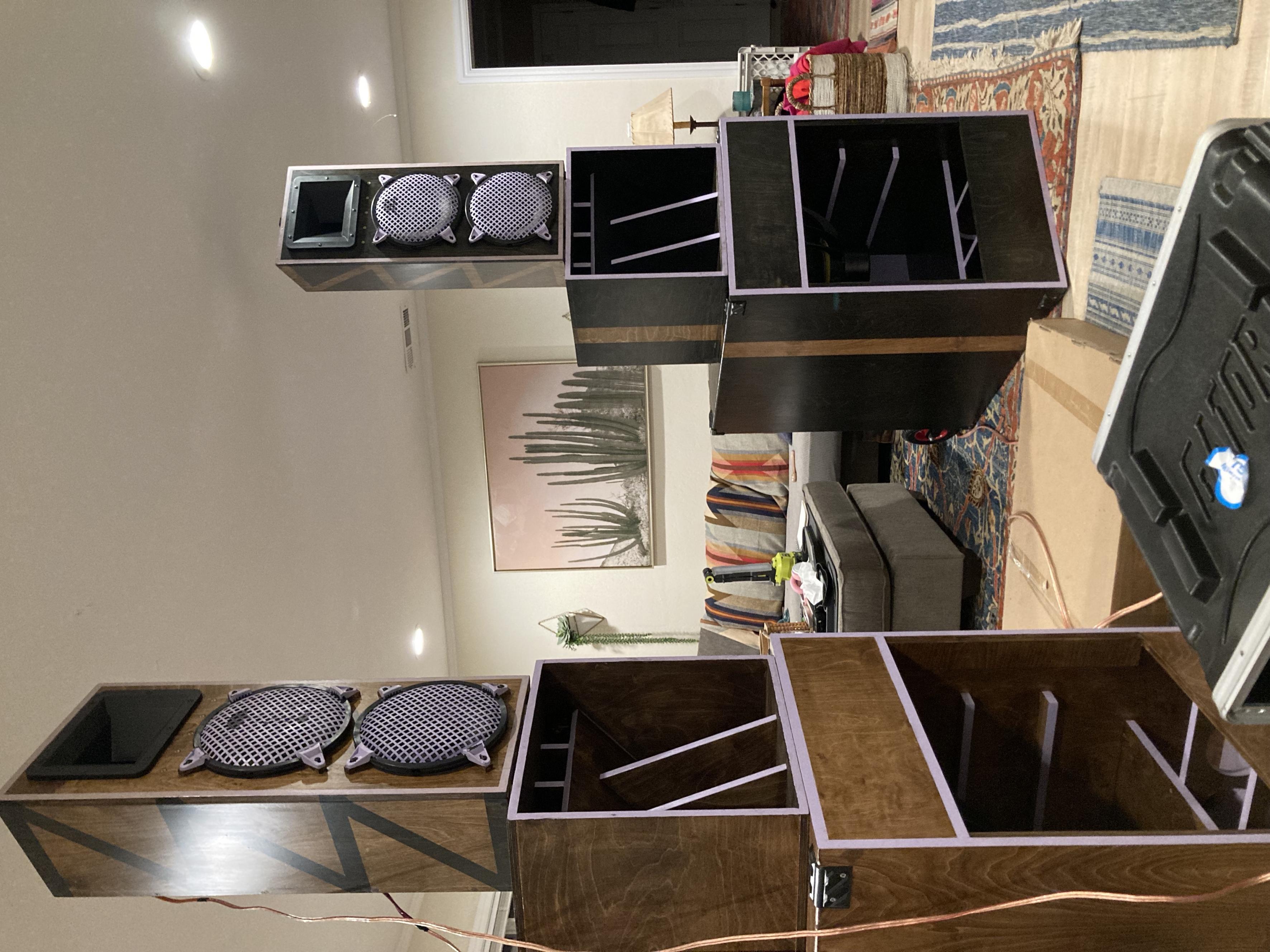

e: here's another pic of the stacks in my living room since I'm here
