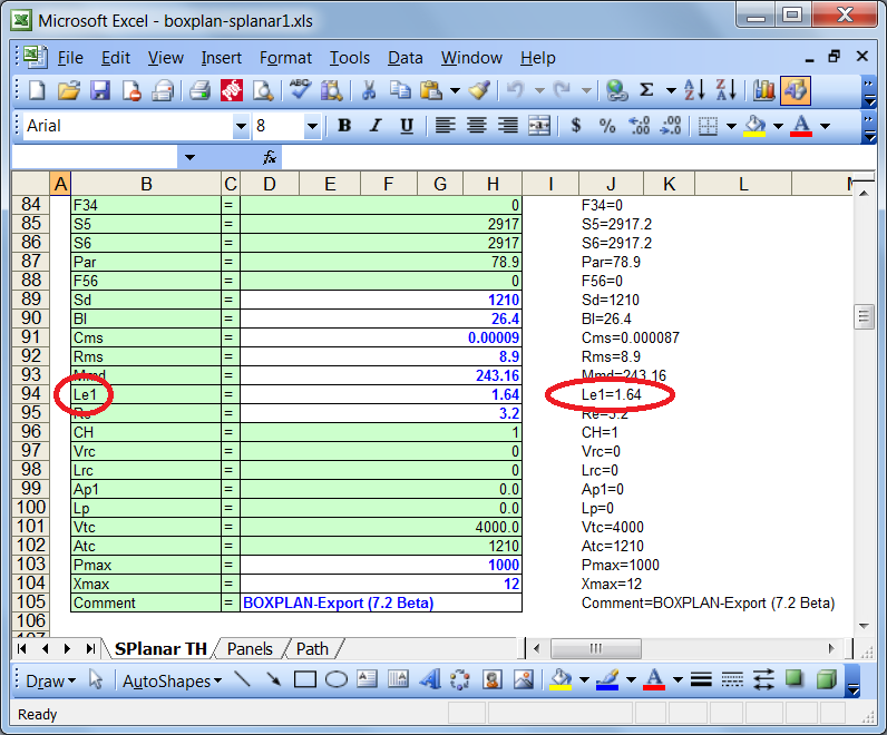

The parameter for enabling/disabling Le is 0111 off, and 1111 on
Just to clarify - the Lossy Le flag is the left-most character in the four-character numeric string (0 = off, 1 = on).
The other three characters are filter parameters.
That might be difficult to do, ...
If not impossible
... as I'm using an earlier version of the Hornresp data file for import purposes as I couldn't get the workbook to work with the later version of the import file.
The Boxplan export file (ID=29.00) is different to the standard Hornresp export file in that it does not include any filter data. The Lossy Le flag uses a filter field that became spare when the separate low pass and high pass active filters were removed from Hornresp (because the band pass filter already covered them both).

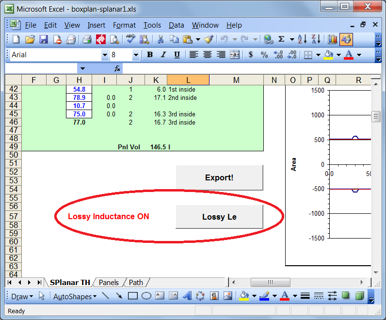

Procedure:
1. Import the initial exported Boxplan file into Hornresp.
2. Open the Loudspeaker Wizard.
3. Tick the Lossy Le check box.
4. Adjust Boxplan and export the updated data.
5. Press F6 to update the Loudspeaker Wizard with the new Boxplan data.
The Lossy Le flag will remain set.
That might be difficult to do, as I'm using an earlier version of the Hornresp data file for import purposes as I couldn't get the workbook to work with the later version of the import file. However, once enabled in Hornresp, re-importing the Boxplan-created file shouldn't reset the "Lossy Le" option under Loudspeaker Wizard, so you can take the same approach I do with stuffing the horn (stuffing is also not included in the Boxplan export) - do a preliminary import, then under Loudspeaker Wizard set Lossy Le (and stuffing, if you're going to use that), tweak the layout in Boxplan and then use F6 to update Hornresp's Loudspeaker Wizard with newer versions of the Boxplan-created import files.
Hi Brian,
Further to my Post #763, after thinking about it some more last night, if considered warranted a Lossy Le flag could be added by setting "Le=" to "Le1=" in your Boxplan export file. With a few extra lines of code, Hornresp could then check for Le (lossy inductance off) or Le1 (lossy inductance on) when the file is imported.
I have attached a modified Boxplan xls file with a "Lossy Le" toggle button and associated macro added to illustrate one possible way that it could be done, together with a couple of (hopefully) self-explanatory screenprints.
What do you think - would it be worth implementing this feature?
Kind regards,
David
Certainly - I've already included it in the v0.4 beta version of the workbook.
This weekend I'll see if I have some time to add on the "Guidelines" section of the workbook. This will tell the user where to draw the guidelines on one of the side panels to ensure that the internal panels are positioned correctly. This method is a lot easier to follow than trying to measure funky angles, etc.
Thanks Brian. The necessary complementary changes to Hornresp will be included in the next update.
If the Le1 flag is set in Boxplan and the exported file then imported into the current release or earlier versions of Hornresp, the Input Parameters screen will show the inductance input box label as "Le1" rather than "Le" for the duration of the current session. The lossy inductance flag will not be automatically set. The next time that Hornresp is opened the label will revert to "Le".
When the next Hornresp update is released, if a Boxplan file with Le1 is imported, the Input Parameters screen will show "Le" in red and the lossy inductance flag will be automatically set.
