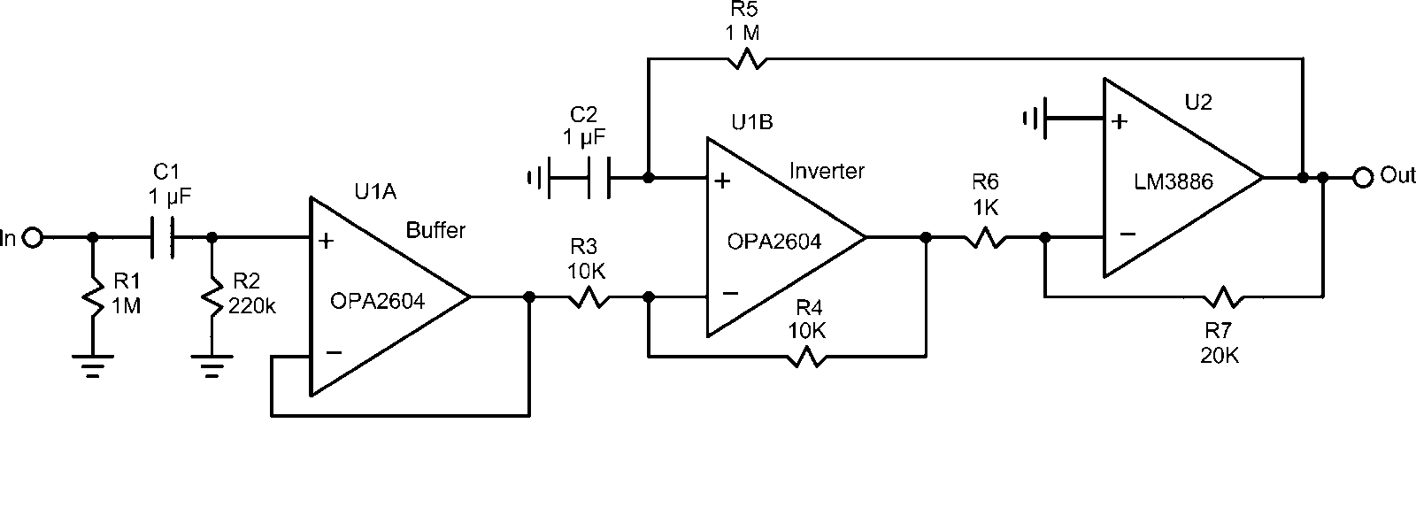

My source for this circuit is almost 20 years old*, so a forum and web search didn't turn up anything about it. I'm soliciting comments, opinions, and possible mods using other op amps or more powerful chip amps. I'm attracted to its elegant simplicity. And the numbers ain't bad either:
10 watts RMS into 8 ohms ____________ >0.003% THD @ 1kHz

Unless I'm mistaken very low input impedance circa 1K and very poor gain, x2, I
cannot see the point at all, cannot see it being remotely stable either, very poor.
rgds, sreten.
The below avoids bipolar electrolytics in the signal path, gain is x20 :

the OP circuit "throws away" ~36 dB of gain in the 4k/65 divider - rather inefficient use of potential loop gain - and it still has a region of 2nd order loop gain slope giving ~ 0 phase margin
composite/multiloop amps with op amp added inside global loop with audio power chip amp is difficult given the limitations of achieving composite amp global stability when you may have to assume worst case loop intercept for the chip amp as low as 200 kHz you have limited added loop gain @ 20 kHz
if you stick to Bode's Maximum Loop Gain you only get ~10 dB added gain at 20 kHz, adding more loop gain requires allowing conditionally stable compensation and consequent possible clipping recovery sticking/oscillation
an interesting option is to use Black’s Feedforward to improve higher frequencies while relying on added loop gain at lower frequencies
the resulting complexity may make you wonder why you aren’t just building a discrete amp with 30+ MHz output Q from Cordell, Self books

sreten, what is the source of the circuit you have there? It's roughly the same thing my circuit shows. This article also shows a non-inverting version with the input and feedback resistors removed and the source brought to the + input on a 1M resistor to ground.
There's also 33, 40, and 70 watt versions, repeating this basic "module". I agree that it probably needs a strong input signal and attention to grounding and layout, but with just 5 passives and some decoupling caps this 10W amp just seems too tempting not to give it a shot. If I can't get it to behave, a little more soldering will give me that 3-stage circuit.
sreten's circuit is simply inverting mode for the power chip amp - the only other "improvement" from the op amps is the DC servo
buffering, inversion gives a hi Z positive input
this is essentially the same as Cordell's "Super Gain Clone" - page 540 of his book
I consider it a very feeble attempt at really improving the chip amp audio performance
the only chip amp distortion mechanism addressed is the nonlinear common mode input Z
the bigger thermal coupling distortion is better fixed by the OP circuit with the input op amp inside the global loop but physically separate from the chip amp and its high power, large temperature excursions
also the OP circuit input op amp is adding to the global loop gain below ~50 kHz - this added loop gain reduces all distortions of the chip amp
the input op amp is driving a relatively high 4k Ohm load, and only to a fraction of the output V at audio frequencies - its not working very hard at all so should have low distortion
The AD711 is part of the magic with this circuit. According to the article, it seems to be particularly well-suited for this application. Since Mr. Wurcer designed the opamp, if I'm not mistaken, I figure he ought to know.
The output is meant to mirror the performance of the opamp, so the LM1875's datasheet THD of 0.015% gets reduced significantly. My motivation is simply that I have the chip amps on hand and am looking to use 'em. If this puppy needs a good preamp, I have a LME49710-based diy unit ready and waiting.

I cannot see why the gain is so low. If x10ing the values of R2 and R4
it would make more sense to to me. The LM1875 is stable with with
closed loop gains of 10 or greater, x2 = oscillation guaranteed AFAICS.
The usual 1R/0.22uF output loading is missing. No reason the chip-amp
should be run off +/- 18V, +/-25V is better, but too high for the op-amp.
rgds, sreten.
I really can't see the "magic" of the circuit at all .....
Don't get me wrong. I am very wary of the circuit's stability. But I'll probably give it a try anyway. The network on the output of the opamp is intended to stabilize the response, and a table is provided showing different values and their effect on phase margin and bandwidth. If things go well, I may try higher ps voltage for the LM1875, but I'd be happy with 10W.

nothing "magic" about the op amp - the AD711 is barley an improvement over LF411, TL070
OPA134 beats it by >2x on noise, GBW
if you want to talk about "magic" jfet op amps for audio you should be thinking OPA627 and the last decade's devices aimed at it like AD8610, ADA4627, OPA827
the OP composite amp circuit isn't particularly sophisticated in compensation, use of the 2 amps worth of gain - Scott Wurcer's name doesn't help its performance at all as far as I can see
Walt Jung, Gerald Graeme, Bob Pease, Jim Williams have all written about various op amp deficiencies and ways to help out
but since SofaSpud can dismiss their ideas so easily as having poor credibility I guess all we can do sit back and await enlightenment

The schematic in post #1 doesn't insist on running the AD711 on its own private clean regulated power, unaffected by the high current noise striking at the LM1875/LM675. However, please don't miss the opportunity to run pre sections cleanly on hi-fi amplifiers.
STK456 and TDA7294 can be run that way, with the pre on regs (shuntie, etc. . .) and not more than 220uF, while the output section's separate power taps can have large capacitance unregulated supply. They, and similar discrete amplifiers, have something very similar to your application, which is really quite like a pre with an output buffer.
This reminds me that one of the possibilities of regulated power, uses a couple of extra parts to insure a clean ground, and that's the version you're after for the pre (AD711), since the majority of the high current noise that you're trying to avoid is the big hammering coming back down the speaker return line. Contrary to legend, 100% of that noise doesn't flow into the power supply board voluntarily. No, not really. Some of that noise makes it up the ground leg of the gain divider, gets gain applied, and is the main cause of the typical hall of mirrors effect, that you have the opportunity to avoid.
Thanks, that is along the same lines as I was thinking. I hadn't thought about the separate supplies. As I mentioned, a big part of the appeal was the few passives and some decoupling caps.
This is really just a junkbox project of mine. Nothing's concrete yet. This circuit may well be too unstable for a production line, but to me that just gives it more diy appeal. Please tell me more about your clean ground concept. I could probably use some education on the C1/R1/R2 compensation network also, if you'd be so kind.

Nesting/composite amplifiers give the opportunity to have the pre run from regs, if you so choose, and since the pre is controlling global feedback, it can also reduce/cancel power circuit noise of the output stage (which is usually jolted/fluctuted from operating the speaker).
The concept seems to be similar to chips with 4 power pins and likewise discrete amplifiers, which all provide the same opportunity (run the pre clean). Your circuit seems to add that feature to a chip-amp that otherwise wouldn't have such a benefit due to lacking connections for it.
There are many cases where features like that aren't used, for instance the ST (TDA7294) and STK (a discrete amp hidden in a little black box) datasheets show hooking V+ small signal power to V+ output stage power and likewise hooking V- small signal power to V- output stage power, thus wasting the high resolution facility of the amplifier. That approach is unfortunately common practice with many discrete amplifiers as well. As usual, the only reason to do it wrong is for reduced costs.
I don't have the education to thoroughly answer your question.
What I see there is that the components you specify are a Local negative feedback loop. Usually nested amplifiers have 1 local feedback loop per each op-amp. And this was going well until I noticed that not all of your feedback is negative. The AD711 is running both R3 and R4 in an adder function. Since both op-amps aren't inverting, R4 is running forward, and after spotting that, I'm lost because I'm just not familiar with nested design. It does appear to be not much different than an inverting discrete amplifier. Perhaps it is merely comparable to the wide range of functions available to ordinary inverting mode amplifiers. But, its got me bluffed. A simulator might estimate some functional component values.
