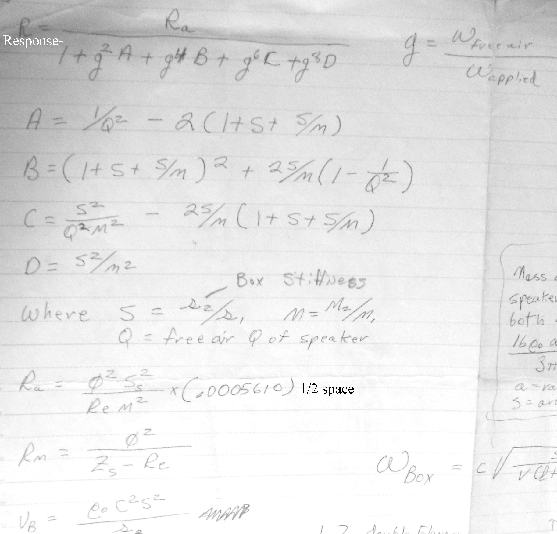

On the pic is the response formula. Not really second order.:faint:
