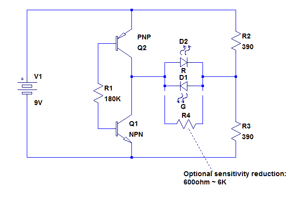

Here is a circuit that will perform like the original one is supposed to, but better:
Without R4, one of the LEDs will practically always be lit (unless the beta's happen to match with extreme accuracy), and the brightness will indicate the degree of mismatch.
If this behavior is not desired, R4 can be added to introduce a threshold: if the mismatch is below a certain value, none of the LEDs will light.
The LEDs could be replaced by a milliameter (and the resistor values adapted)
I'm having a hard time with this circuit. I can't get either LED to light.
I am using a REF102 to supply 10 volts to power the circuit. I had to use the recommended PNP transistor in the datasheet to provide enough current. I'm getting exactly 5 volt drop across each of the 390 ohm resistors. I used a 156k ohm resistor for the base connection.
Any ideas?
Any ideas?
Did you use R4; which value?
Try disconnecting the collector of one of the DUT. One of the LED should light.
Otherwise, it has to be a silly problem of wrong polarity, wrong pinout or wrong connection.
There is so little that can go wrong in such a simple circuit, that should make troubleshooting an affair of 60 sec. at most
This is weird. I removed the jumper between the LEDs and the transistors' collectors. I inserted my ammeter in its place and there was no current flowing even when there was current flowing elsewhere in the circuit.
At the suggestion of a friend, I replaced one of the 390 ohm resistors with one of different value (in this case 1k ohms) and voila! The red LED lit up.
The only thing I can figure is that if the two transistors match exactly and the 390 ohm resistors match exactly, what is created is a perfect wheatstone bridge so that no current flows across the circuit.
Now I'm going to put the original 390 ohm resistor back in the circuit and try a NPN transistor which I know does not match.
Aha! When I put the 390 ohm resistor back and inserted a different, poorly matched NPN transistor the red LED lit up. I then remeasured the current between the LEDs and transistor's collectors and it read about 150 micro amps.

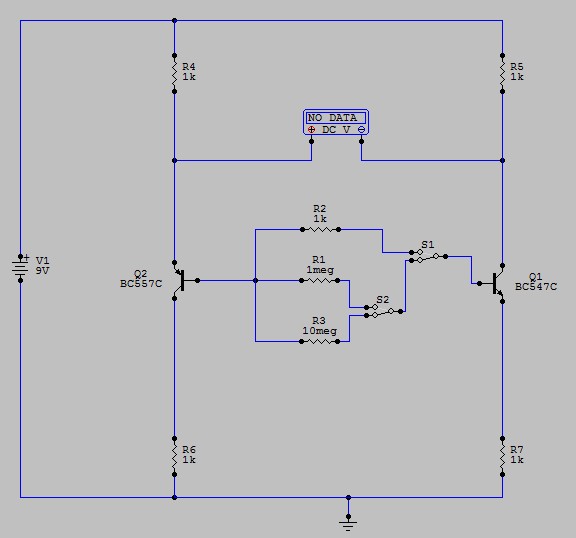

After using a DCA55 / DCA75 combination and a spreadsheet, I think I have come close to matching some transistors.
Just to see how close I was with that method, I decided to try the method in the attached document.
I matched the 100k resistors within 1 ohm using an HP 34401A. Even so, when I switched transistors per the recommended method, the difference was about .7 mV. This was way more than can be accounted for with the small difference in emitter resistors, in my opinion.
Any ideas?
  • ianFritz-transmat0011_144.pdf
Fritz jig puts the resistors on the wrong side of the DUT &REF. This arrangements very effectively hides the differences between DU & Ref.
I thought I expressed this view at the time IanFritz posted his jig test.
The emitter resistors must be very small. Even zero ohms is acceptable.
The voltage drops should be measured across collector/load resistors.
