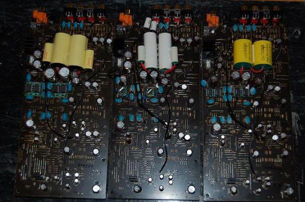

Changing RCA jacks
I didn't change mine.
If I did, I'd feel compelled to change the jacks on my preamp and power amp too (not to mention upgrading interconnects!)...
I've heard that some guys reported good results direct-soldering their right and left channel interconnects directly to the PCB, and used rubber grommets/strain relief through the panel. This eliminates the jacks and another set of contacts(the plugs)!
Sounds like a hassle, but I can see where it would sound better.
Attached pic shows the main R/L jacks, which can be de-soldered then seperated from the multichannel outs(which I'd leave stock).
Cheers
-Chas.

Do I have to de-solder all of the jacks to seperate the L/R?
I never attempted this and it's been a year since I had it apart so I can't remember exactly (and my photos weren't taken from the right angle to see this).
Take a close look at the pcb.
The jacks either seperate pcb jack modules or one big multiple unit, from which you'll have to desolder the leads and then cut off the L/R pair from the rest (at which point-if you're really OCD- you could replace all with "audiophile" quality jacks silver-wired to the pcb). Depending upon the quality of your interconnects (and other components), you may decide to "go all the way".
The big improvements, sonically, seem (to me) to be from the improved I/V stage, Class-A biased outputs and power supply upgrades. My friends and I have favorably compared the modded player(with the stock jacks) to a few very high end CD players.
YMMV
-Chas
Oops! I should have re-read that before I posted (up way too late the night before when I wrote that)!
I meant to say that (IMHO) the biggest improvements I could hear came from (in order of the improvement each made):
1) Replacing the output(electrolytic) coupling caps with film caps.
2) Replacing output Opamps with improved, Class-A biased units (e.g. AD 826, AD827, OPA627's on browngdog adapter).
3) Power supply upgrades (especially the large caps on the PS board and the use of Black Gates on the audio board).
Next in line would be: improving I/V stage and then replacing the clock with the Dexa "D-Clock"unit. The last two involve greater difficulty and cost (respectively) for the amount of improvement realized.
Hope this clarifies things.
-Chas
Thanks Chas, I have just a couple more questions...
regarding the opamp decoupling capacitors.
Did you remove the smt chip capacitors c343,344,345 and 346 before adding the .1uf blackgates?
Also I noticed that you decoupled across V+ and V- as well as
V+ to gnd and V- to gnd.
Thr data sheets I read suggested one or the other.
Why did you choose to implement both methods??
Yes. Removal and replacement of the chip ceramics with good film types, around the opamps, improves sound quality IMHO (The ceramics are retained as bypasses in the digital section, due to their low ESR at very high frequencies).
Also I noticed that you decoupled across V+ and V- as well as V+ to gnd and V- to gnd.
Yes, The use of both together was recommended by others in the threads on op amp bypassing.
"...one [small] film cap from + to - on the opamps supply pins is also used. [The]key is to use all three caps as close to the pins as possible for optimal results."
"The purpose of the bypass capacitors is to produce a low impedance ground return for high frequency garbage which makes its ways on the power supply rails."
As I mentioned earler, I used whatever small value polystyrenes I had on hand(330pf-10nf).
Try to avoid "analysis paralysis" (a mistake I've made), when it comes to the mods. Remember that any of the changes listed should make an improvement, and in most cases they're additive!
Disclaimer: YMMV
Enjoy listening to your newly improved player!
-Chas
P.S. Credit for the mods must go to the many others, more knowledgeable than I, who've posted here on the forums (I was a virtual "newbie" before I joined DIYaudio and began modifying my gear)! I'm just using this forum to compare and share my results.
