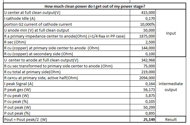

There is not too much detailed data available about the KT150. Based on my measurements it is an "extended" KT120. Here is a quick an dirty excel to roughly estimate the range of output power of a Class A SE. Input is Ub(V), Ra primary(Ohm), lowest voltage (V) of the anode when starting clipping and the remaining anode current (mA) at the positive AC signal peak. The calculation is based on a pure sine wave ignoring all nonlinearities. The output is the estimated output power, the resulting class A anode current and the anode power dissipation based on that current.
I have put in some configs.

So I'm gathering that in my current project, 22W from a KT120 into 2.5k at just under 400V should be realistic and sustainable?

Agreed. The actual used value might be too optimistic. As I stated, the anode low voltage parameter is an input cell to play around with.

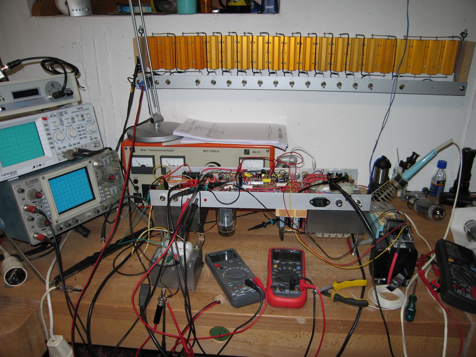

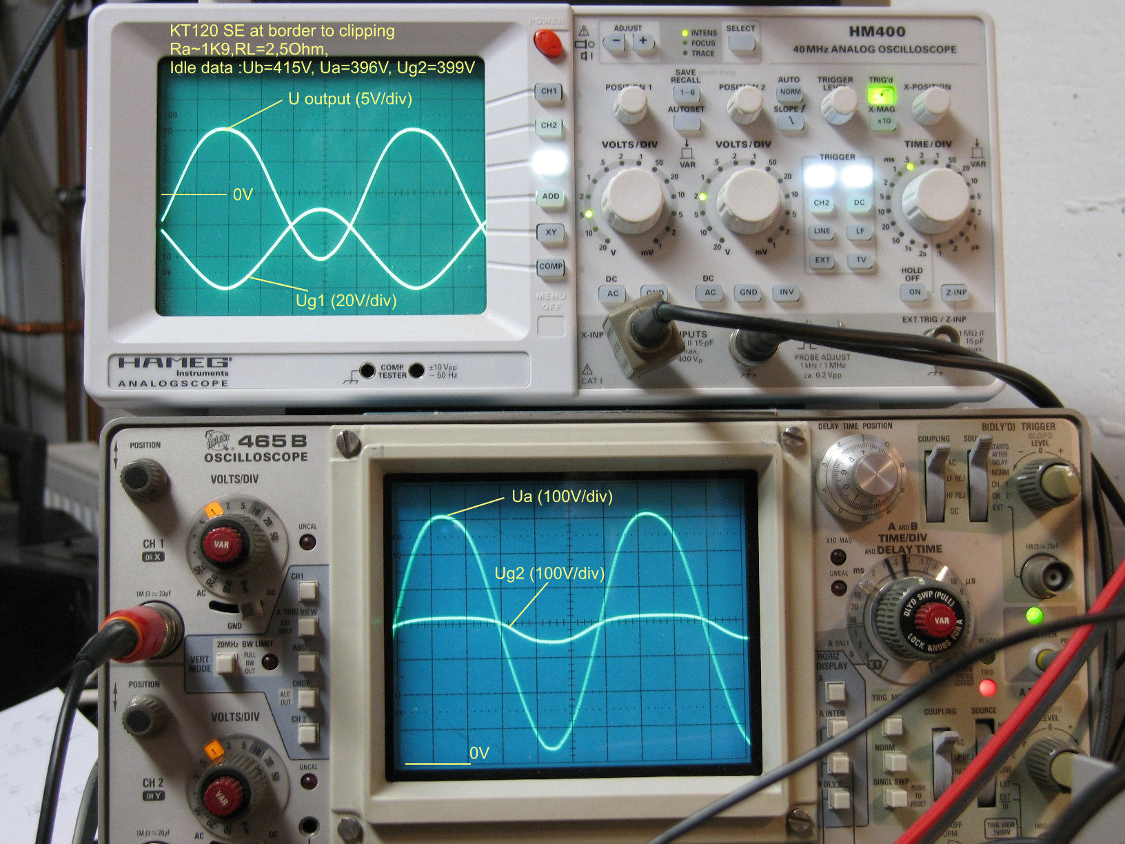

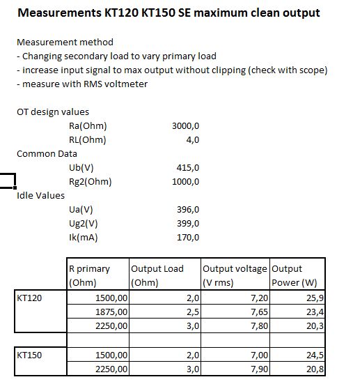

It took a litttle bit of time to create a quick and dirty prototype, here is my measurement of KT120 SE. I have varied the primary load by changing the secondary load. The measurements is done with an RMS voltmeter just before clipping (checked with a scope).

Thanks! What was the screen voltage used for the tests?It took a litttle bit of time to create a quick and dirty prototype, here is my measurement of KT120 SE. I have varied the primary load by changing the secondary load. The measurements is done with an RMS voltmeter just before clipping (checked with a scope).

So here are some more details, please have a look to the right table attached. In addition to KT120 I have measured 2 points of the KT150 for comparison. Interesting to see that basically there is no significant difference between the KT120 and KT150.
The scope picture illustrates a little bit:
- upper scope: output power and control grid signal at the output tube
- lower scope: Ua and Ug2
If you look to the output power you implicitely can see the 2nd harmonics at the level to clipping, typical for SE output stages. Interesting: Ua min is 40V.
I have made a power output estimation including the DC resistance of the OT(primary=144Ohm(measured) and secondary 0,1Ohm (estimated)). The calculated estimation is 25,1W at Ra=1875Ohm (left table). The measured result is 23,4W, so thats what I call "in the ballpark".
And just for fun: the other picture shows what I call "quick and dirty": I have used my PP testbench, removed one output tube, exchanged the PP OT by an SE OT (left side) and put in a choke (right side) to the G2 supply.

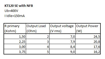

In SE, it would be more realistic to use a RL between 3.5K and 5K into 8ohms for either tube. It would lower the power output slightly and change the distortion measurements as well. You should still be able to get close to 20W out.
