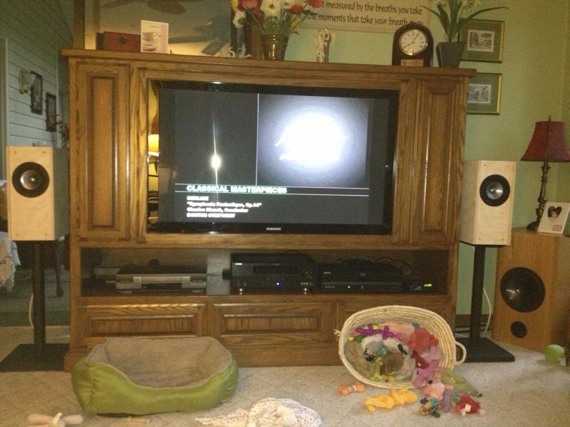

Well d@mn! Here I am sitting in my easy chair listening to music streaming through Music Choice, surfing the web and sipping some Black Jack. I have the A10M.3's in a pair of 16l BR's driven by my HT receiver, and I wanted to see what kind of bass they would do, so I set the AVR to bypass -- turns off the sub and removes any EQ. Up come the Berlioz "Symphonie Fantastique". It was as good as I have ever heard it! I could feel the tympany. The orchestra was there all the way to the basses. Never go muddy then the orchestra was at full throttle. On to Beethoven's "Moonlight Sonata". Alfred Brendel is in the room with me.
I'm going to have to take these speakers out to the shop and see it they measure what I am hearing. The model says f3=40. Maybe it does. I like these speakers!
Bob

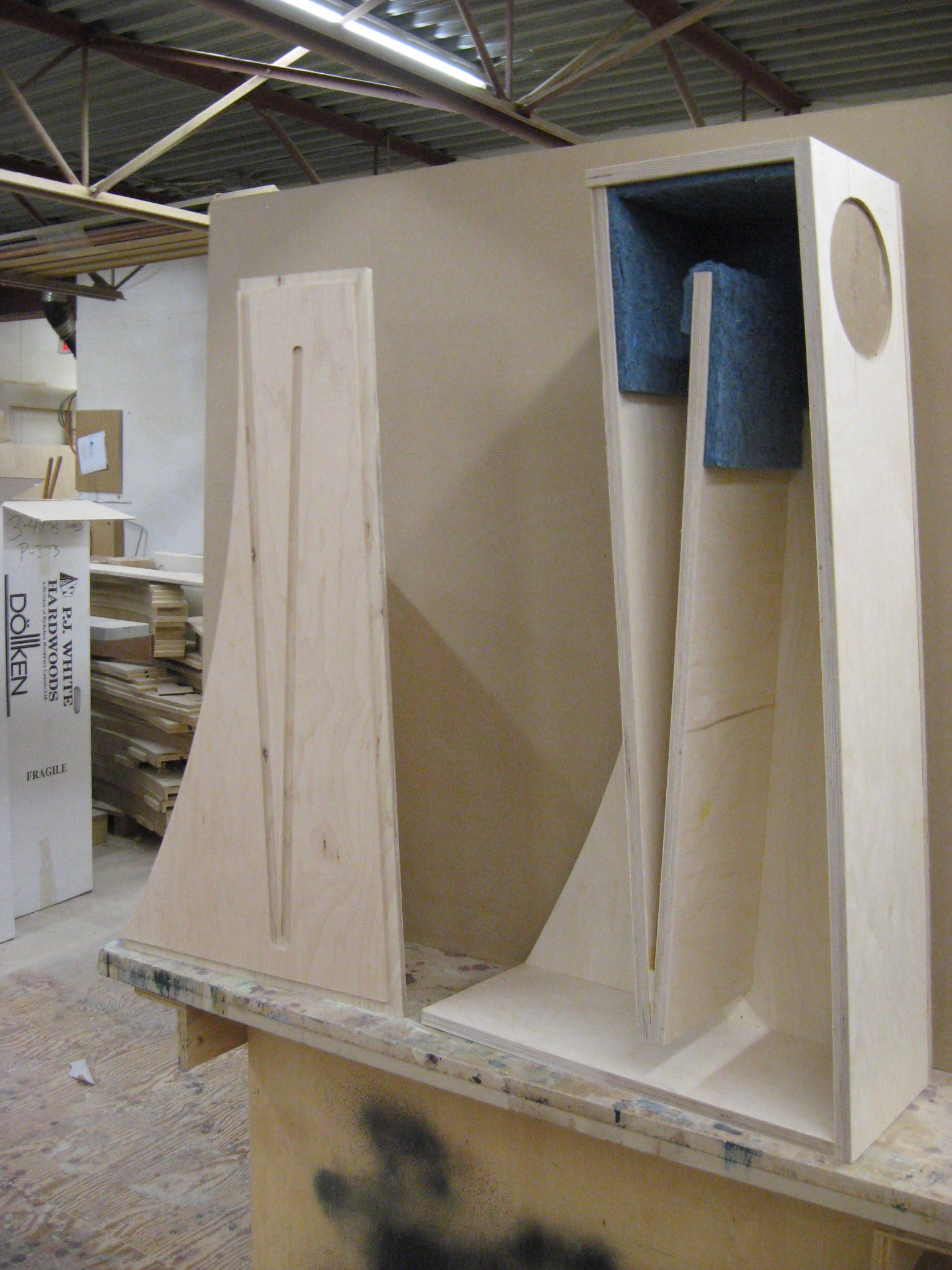

quick view of FHXL compared to side panel from FH3 kit

To forestall any queries, it's not a 'scaled' FH3, although the configuration & loading scheme are similar (but not the same). For the sake of interest though, neither it, nor FH3, are ported.

They're not all that much larger than the FH3, but the material break-out isn't quite as efficient.

Protos as built just under 2x the volume.

well yes, the one photo doesn't accurately display the difference in cross section (203 mm vs 140mm )
