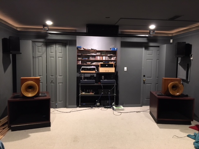

My speakers are very high efficiency horns which is probably why I like the M2 so much. Mid-range is Edgar wood salad bowl with JBL 2441 compression drivers (500 hz and up), Mid-bass is front loaded straight horn (68 to 500 hz) using Great Plains 15" woofer, Subs are 7 ft tall diy tapped horns with Definimax 4012HO drivers. Subs are driven by pro Peavey amp and Welbourne active xover at around 60 hz. FW amps drive the mid-range and mid-bass, passive xovers. I also have the fancy Fostex magnesium tweeters but they are sitting disconnected at the moment. All in all big huge dynamics that can fill up a room so they work better in bigger rooms.

Pic of my horns. I built the mid bass and tapped horns from sims that John Hasquin did for me.
