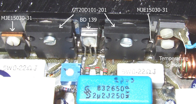

I made it for about 300 € , payed 10,5 € a piece for the GT20D101-201 .
So glad for DIY amps . I designed the protection circuits for the amp and a different supply power . I can switch 'em on-off remote controled .

I think that original Toshiba IGBT pairs are: one black other green package? You have all black IGBTs? Thay, originals are 3 times more expensive per piece and not easy to find theese days...
I build one piece of that very good amp. Before decades. This was in the article Ultrafast high end design. Still working in the pro studio for monitor amp... I run it about 400mA Io. Somehow when I remember for 300mA these heatsinks are at the edge? Probably should be bigger. Mine was. I remember that the one og the key point was to pair the input BJTs not only smple Hf but thermaly. The device for pairing is also published in some later elektor magazine. And of course huge power transformer. I put dual mono 2 x 400W, with not much uF after rectifiers...
It was for my oppinion one of the best 50W amps.
But from what You are accomplish this PCB from parts of tank T34?
Well did say that I build it in 2001 ... 18 years ago . Back then you bought in electronic component shops and got the original Toshiba transistors . Not that much fake/immitations like there is nowadays. So the 10,5 € /IGBT is the 2001 price too .
I (unfornunately ) live in an apartement so I can't play loud . 300 mA is enough to stay in class A at low levels. In hot summers I turned it down to 250 mA . I don't want my heatsink temp higher than 40-45 C . These are big a$$ headsinks btw.
Yes the input transistors and the constant current sources are thermally coupled , as you can see in the pic I posted in my second post .
My transformer was as Elektor's BOM , about 160 VA but with 4 x 10.000 uF to each supply line.
