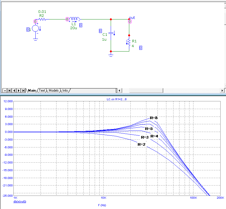

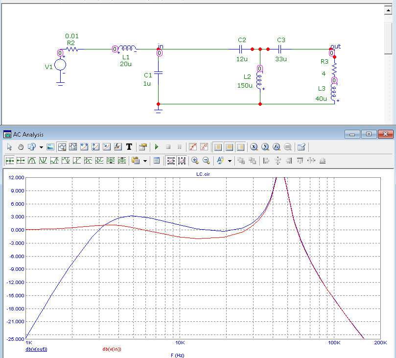

The inductance of a 30" twisted pair cable will be about 20 nH. Forget about the inductance of the connecting wires for such short lengths. Most likely, the whole catch is in the output filter of the amplifier. As soon as the speaker impedance decreases in relation to the low-pass filter setting in the amplifier, the effect will immediately appear the inductance of the output low-pass filter amplifier in the form of additional inductance, and this inductance can be from 20 μH to 40 μH, it depends on the manufacturer of the amplifier.The amplifier makes you a roll-off in the frequency response, since the output low-pass filter of the amplifier is not covered by feedback.There is probably about 30" of twisted pair wire between the amp and the tweeter... Surely twisted pair wire would not add this much inductance? or maybe yes?

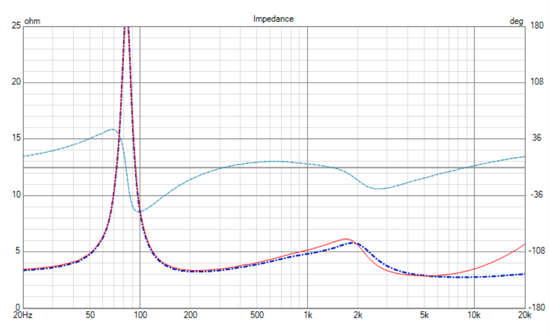

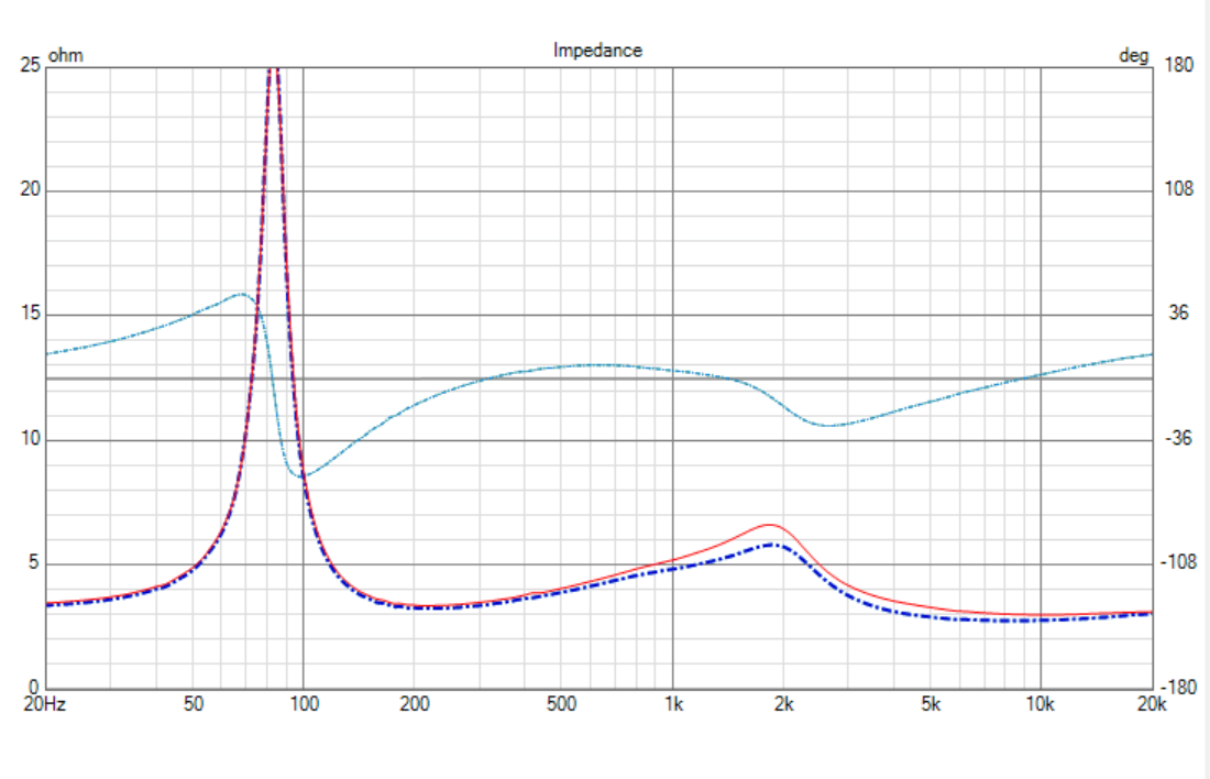

Can you show the impedance plots as well for both cases, sim and real?

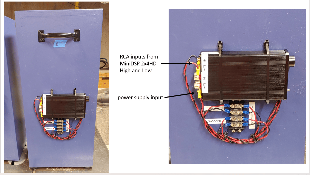

Good thought...The wiring length definitely changed. For the testing of the drivers, I was using short leads from the amp to the drivers. The actual finished system uses longer wiring. As you can see, I used twisted pair wiring for a neater installation. There is probably about 30" of twisted pair wire between the amp and the tweeter... Surely twisted pair wire would not add this much inductance? or maybe yes?

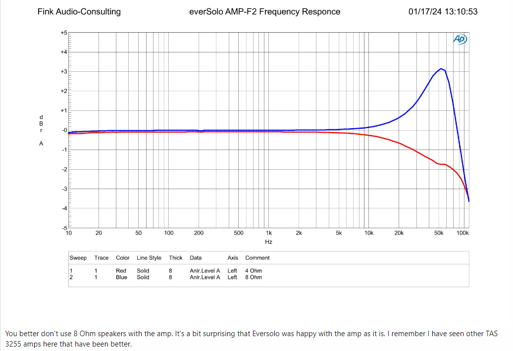

K.H.Fink posted in ASR his measurement of a recent class-D amp, showing the FR deviation.
Post #14:
https://www.audiosciencereview.com/...f2-class-d-power-amplifier-coming-soon.47651/
Post #14:
Dashed curve is the measured impedance of the mid+tweeter+crossover. Solid curve is the simulation
Now here is the same plot with 0.039 mH of parasitic inductance added to the tweeter ciruit
It seems that if there was actually this parasitic inductance between the amp and the tweeter filter, it should show up as a rising impedance above 7k... and the actual measured response does not show that.

I have made a frequency response plot of the amplifier output, with the mid+tweeter+crossover as the load.
The plot is in dB, but please be aware that is a relative dB. In other words, 0 dB is not referenced to anything in particular. The actual measurements were made at an amplifier output of about 1 Vrms.
This data confirms that the amplifier frequency response is not flat when connected to this loudspeaker load. There is a peaking of about 0.5 dB at 4k, and then a drop of more than -2 dB at 20k. This matches closely with the acoustical measurements in post 613 https://www.diyaudio.com/community/threads/compact-low-cost-active-3-way-speaker.402812/post-7570120
Thanks to those who pointed out the possibility that this inexpensive class D amp might have a sensitivity to output load impedance. @uriy-ch , @IamJF , @Draki , @JukkaM - - Thanks !
Now that I know the source of the anomaly, I am more comfortable in simply compensating it in the DSP filter.

In class D amplifiers, a low-pass filter (LPF) is placed at their output for demodulating the Pulse Width Modulation (PWM) signal. If this LPF is not covered by feedback, there will always be an influence of the LPF properties between the amplifier and the load. It is this LPF that possesses such physical properties; it is capable of altering the amplitude of the output signal when the load resistance changes. In post number 627, this property is precisely depicted in the lower picture; please study the images attentively. In class D amplifiers where the LPF is covered by feedback, such an effect is not observed because the feedback monitors the LPF output signal and makes necessary corrections to prevent such changes in the LPF output signal at the load.For us non-sparkies, can someone explain the conditions in which this could arise?
I actually understood that! Thank you! So is this found only in cheap D-class amps?
