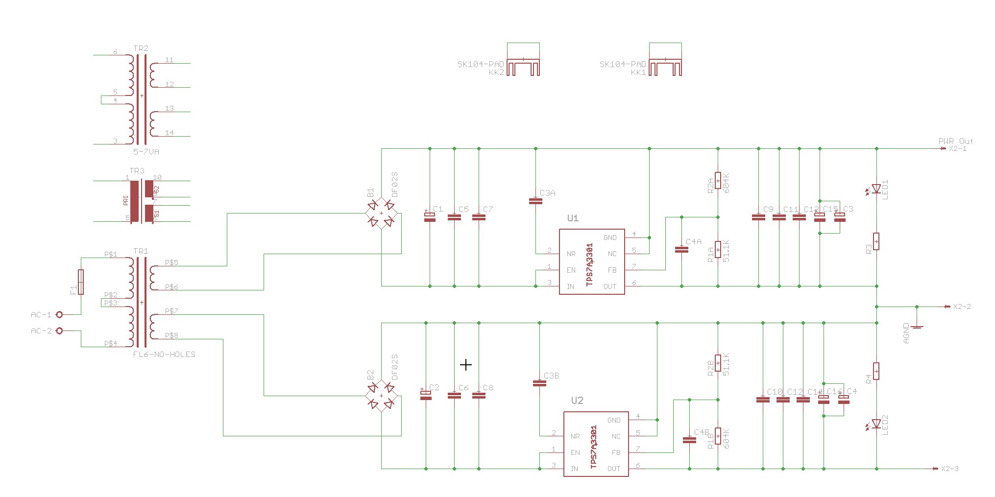

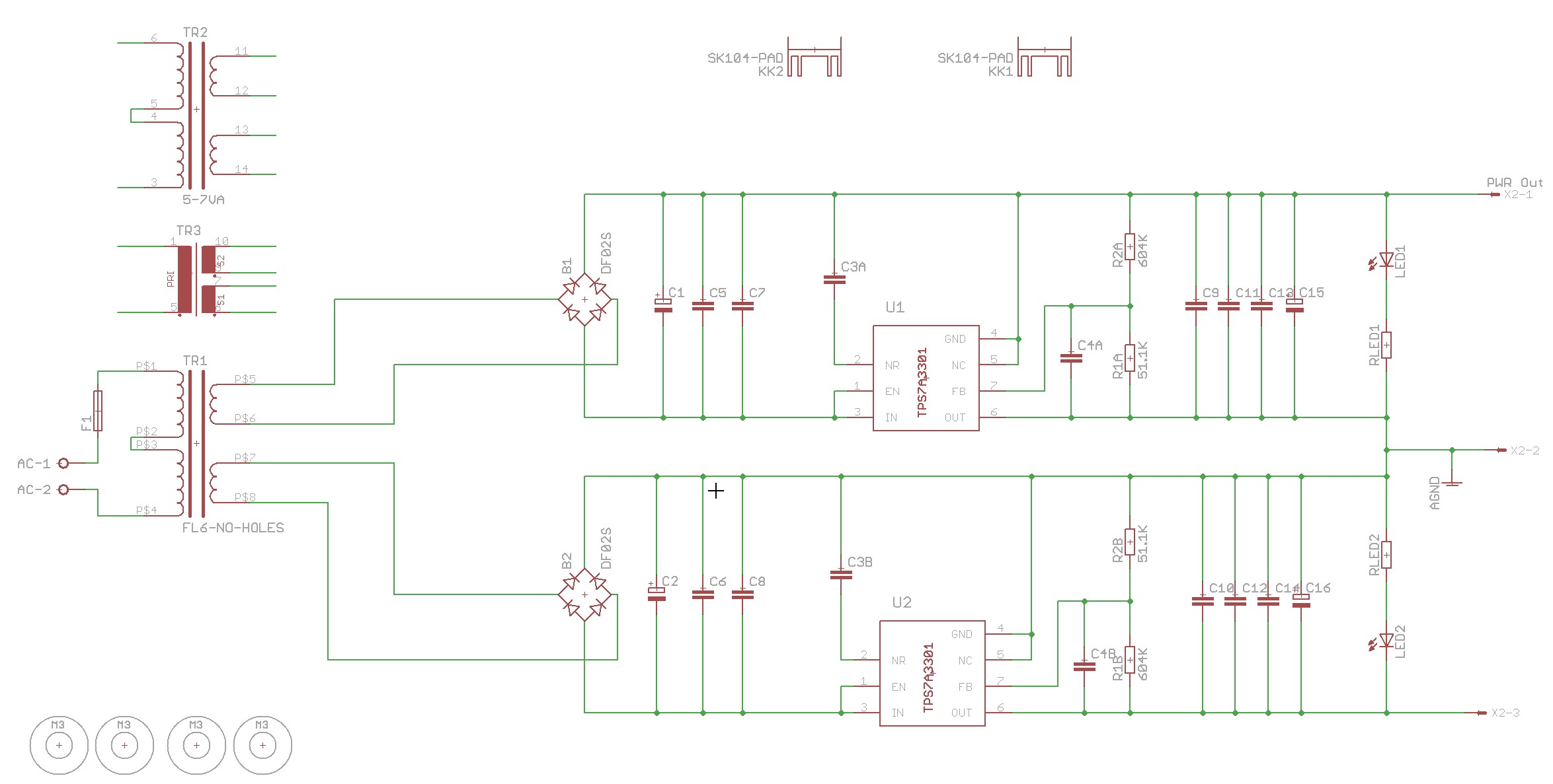

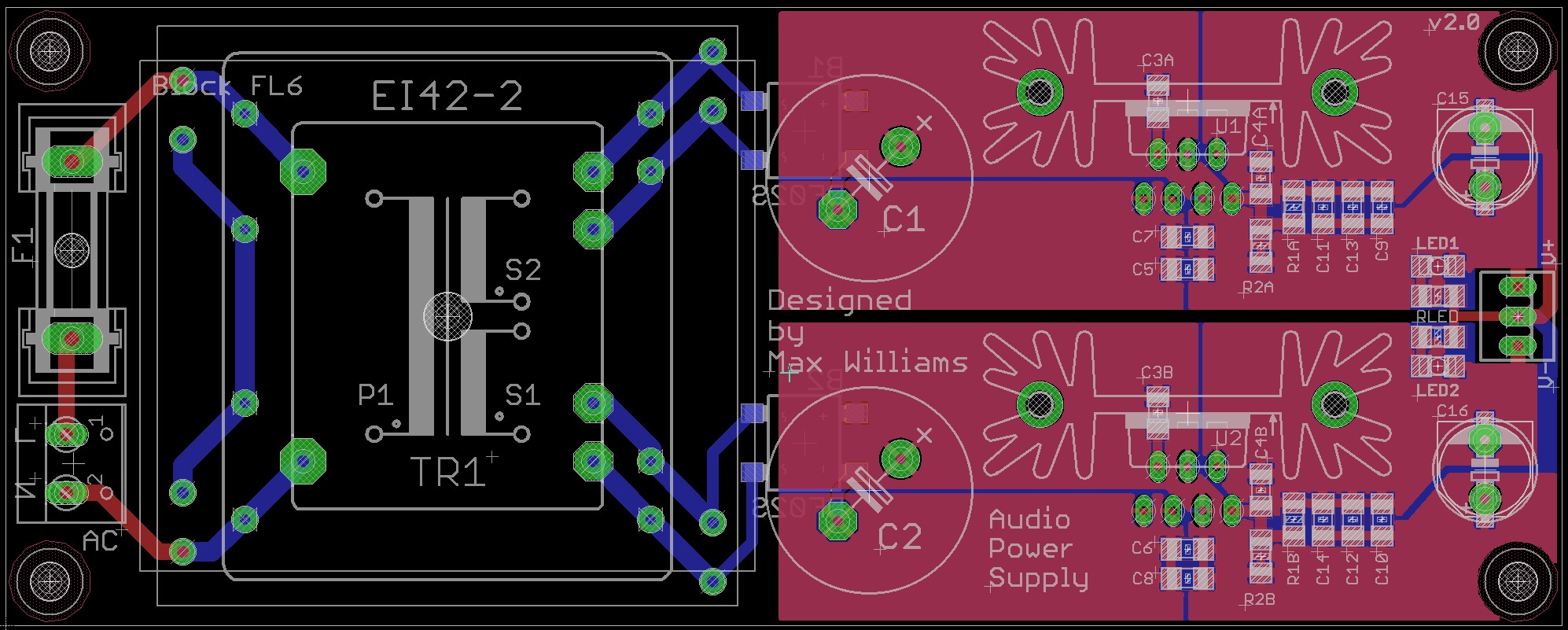

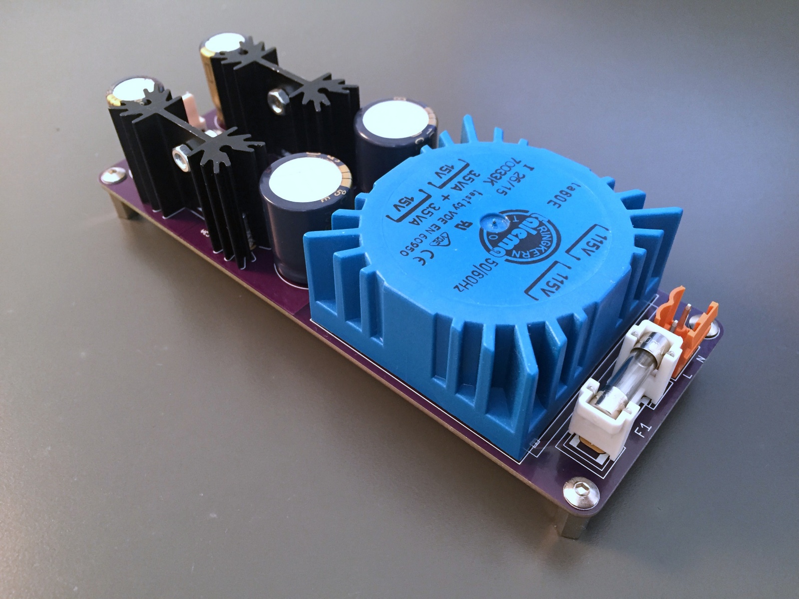

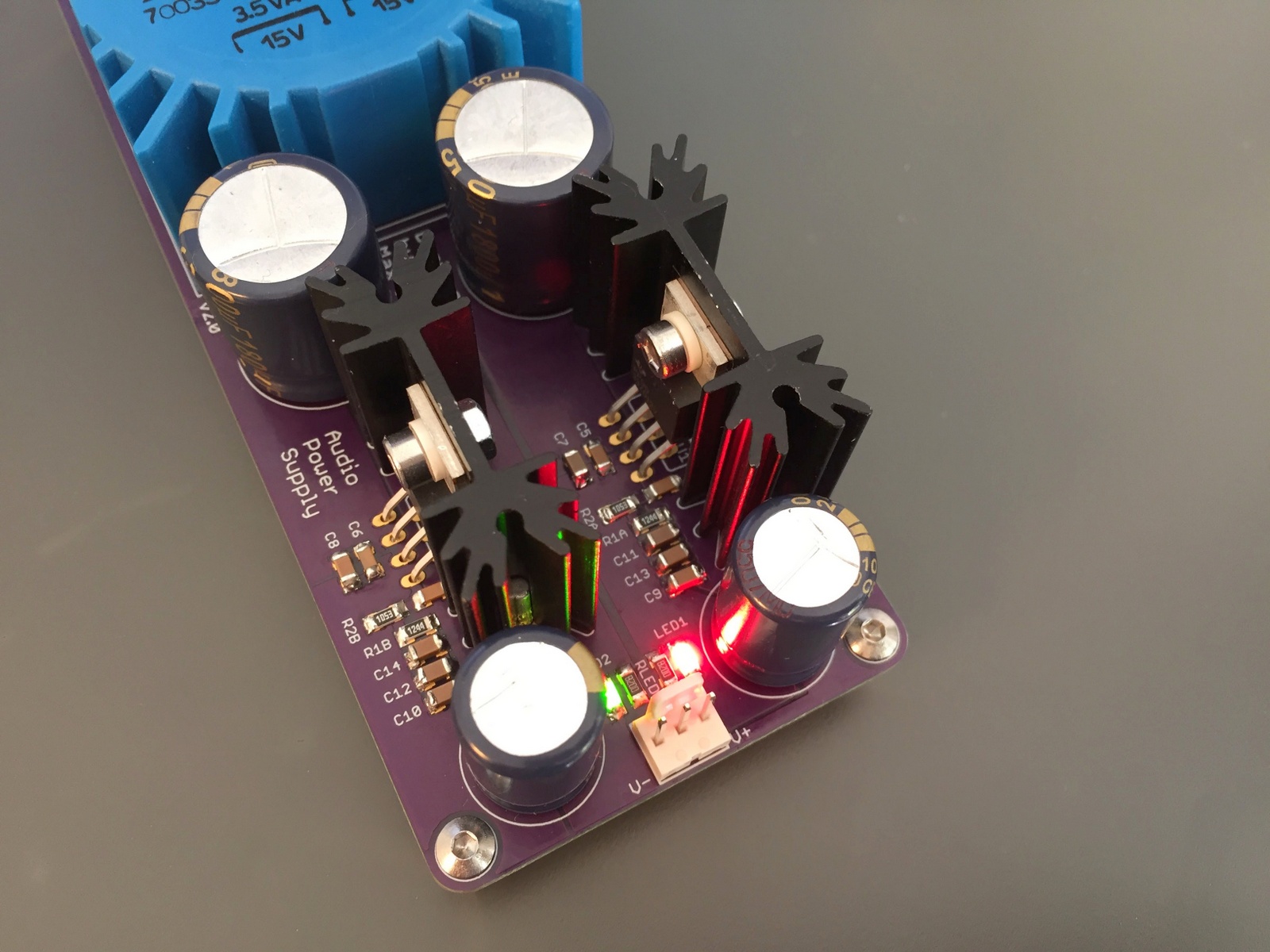

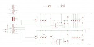

Here is my design for a compact and DIY-friendly power supply using 2x TPS7A3301s to give +/-15V. I want to use for it a preamp but it could also be used for a headphone amp etc.
Currently the BoM looks like this:
TR1 - Block FL6 or FL8, Talema/Amveco 5/7VA or standard EI-42
C1/C2 - Panasonic FK 2200μF 35 V, 18mm
C5/C6 - 1206, 0.1uF, X5R or X7R
C7/C8 - 1206, 47uF, X5R or X7R
C3 - 1206, 1uF, X5R or X7R
C4 - 1206, 10nF/0.01uF, X7R
C9-14 - 1206, 22-15uF
C15/C16 - Panasonic FC 800μF 25 V, 8mm
R1A/B - 1.24M
R2A/B - 105K
B1/2 - VISHAY DFL1508S
I've tried to keep the layout and components as close to the TPS7A3301EVM-061 evaluation module as possible while still making it compact.
Any pointers? Do you guys think the slight layout changes are OK?

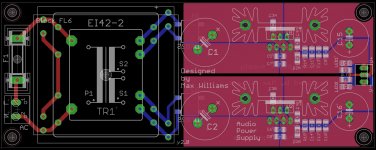

Hi Maxw,
I would suggest to increase top and bottom "Restrict" around the mounting holes at the right side. As it is now it will electrically connect to chassis if metal screws/spacers are used. Your design also needs spacers for the heat sinks which could be avoided if you remove/change some copper pours.
What you've done is similar to Owen's (opc) design in "The Wire" series of boards. His design is even more compact but it does not have on-board transformer.
Oleg
Good idea. Previously I had just relied on the soldermask as insulation. I actually couldn't find an easy way to do this in Eagle so I made a custom part containing a hole and large restrict area.
I've isolated the heatsinks now. Will also use a thermal shim.
Yeah I've seen his design but couldn't really see the layout from the photos. I think he had good results and measurements so I'm hopeful for my design too. I think they both follow the datasheet/EVM in components.
Thanks Oleg!

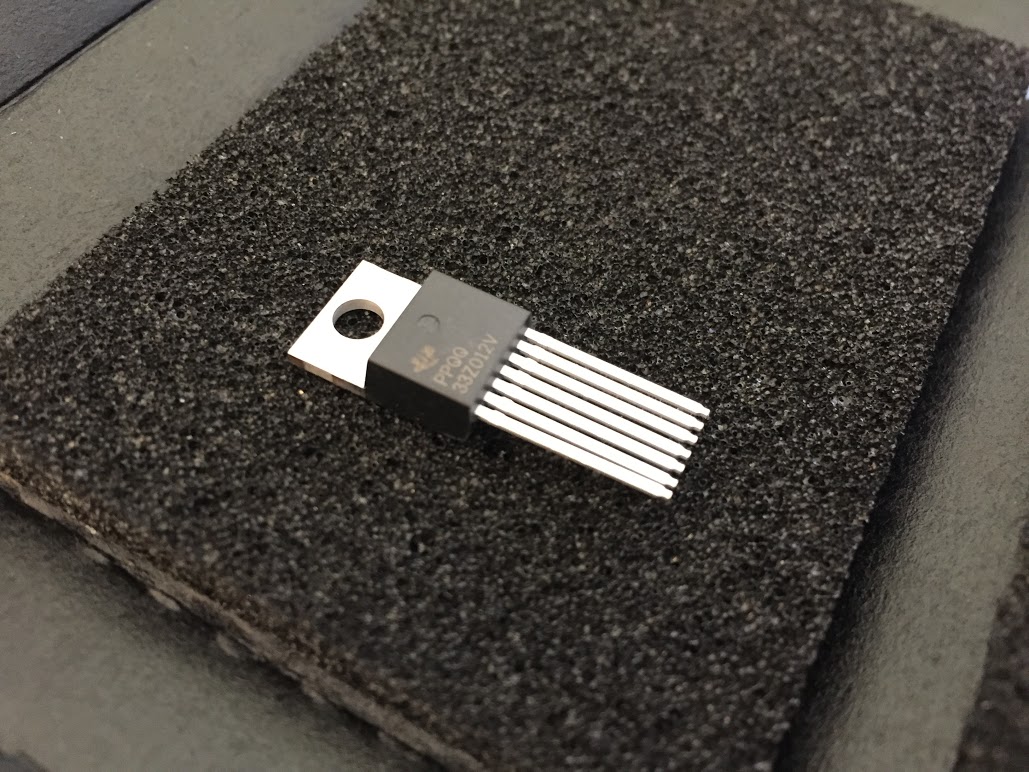

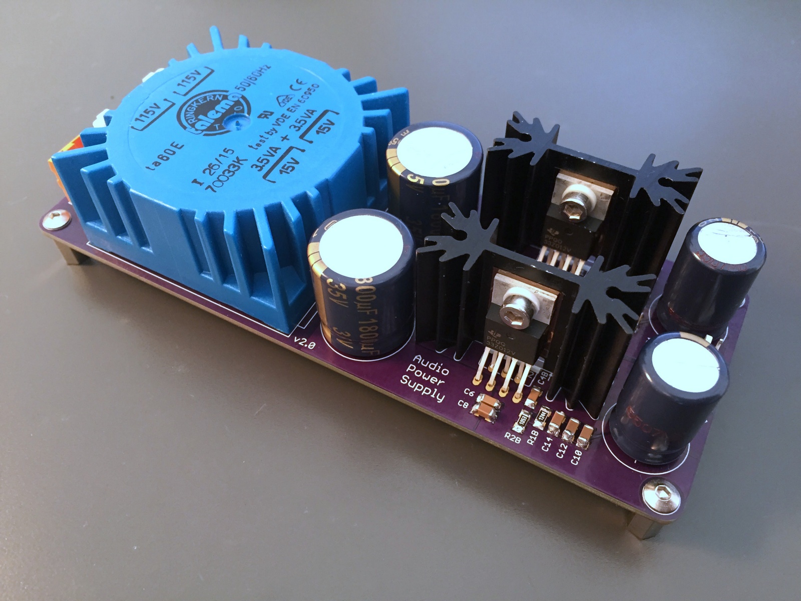

I'm not sure about the pin spacing on the IC though. It looks different between some photos of the EVM.
For example here it looks like the pins are directly underneath the IC, like the pins are straight:
But here it looks like they are bent a lot, like in my layout:
The IC has straight pins, like in the datasheet. So perhaps they bend the pins when making the EVM units. I've changed the Eagle package a bit so less bending is required.

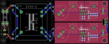

There's this bit in the data sheet that might explain it :D
10.4 Package Mounting
The TO-220 (KC) 7-lead, straight-formed package lead spacing poses a challenge when creating a suitable PCB footprint without bending the leads. Component forming pliers can be used to manually bend the package leads into a 7-lead stagger pattern with increased lead spacing that can be more easily used..
Anyway, nice job Max :)

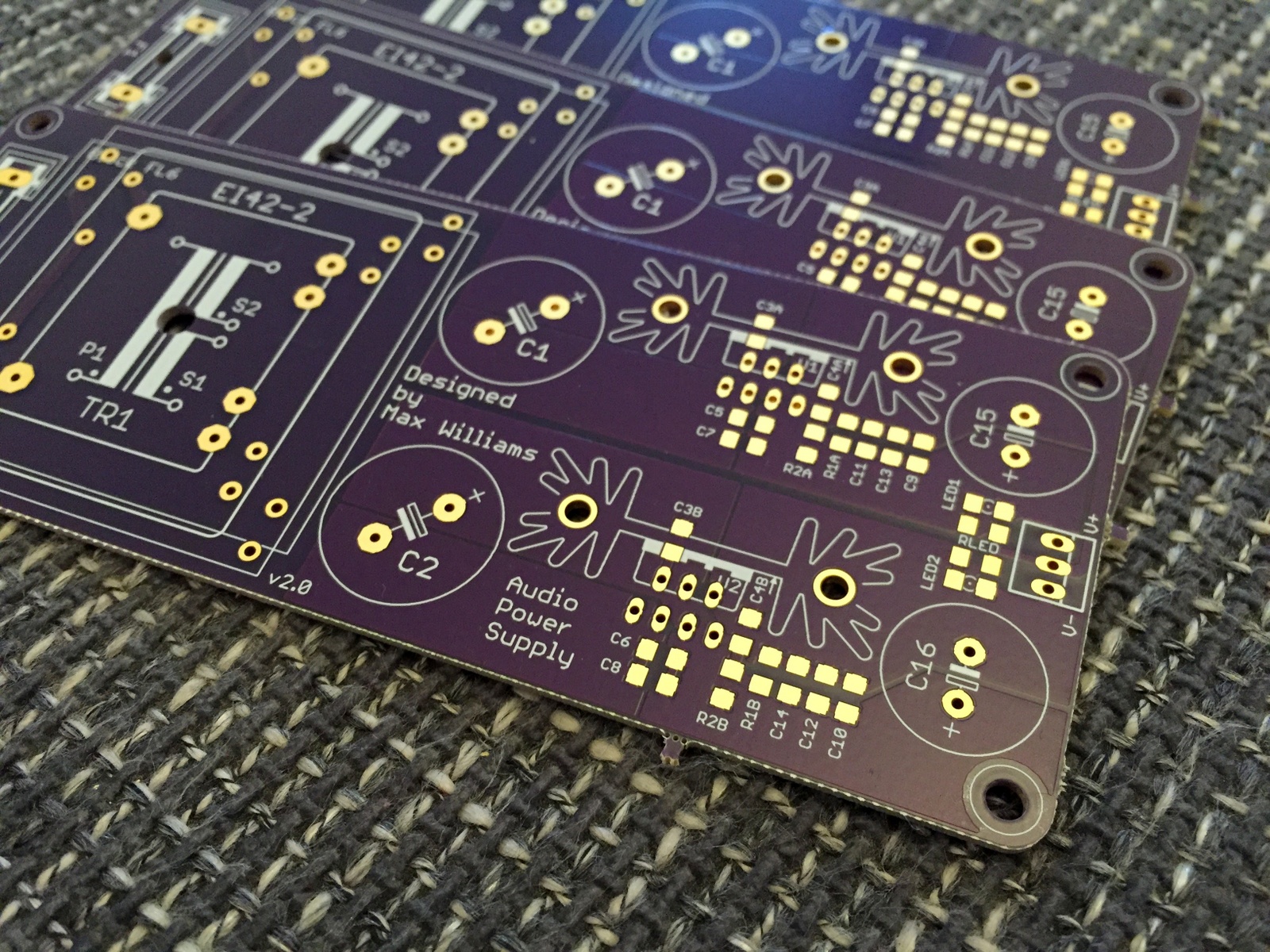

I have two spare PCBs if anyone is interested. Or if someone wants to make their own, attached are the Eagle layout and schematic files and here is the BoM:

120 Volt AC Mains Conversion
Your Eagle PCB uses a 240 Volt TR1 Transformer. I need split primary transformer so that I can configure your design for 120 Volt AC Mains.
It looks like this transformer by Nuvotem Talema, Part Number 70033K
would work. It's a 2 x 15 V AC Torodal Transformer that's rated at 7VA with a split dual 115 Volt AC Primaries.
Changing this design means a substitution of the footprint for this transformer
in Eagle. Since I'm need I'm sure I can't undertake this step. Let me know if anyone can help. Take care.:mad:
Part Number 70033K
Yes, this is the part I used.
You just need to change the design to have the primaries in parallel, like you already did for my 5V PSU.
