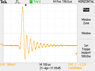

I remember this Dirac impulse response. I find something very similar in the Philips CD 723. (See attached picture)....but one that is essentially more like the classic LC Brickwall filter on early non-oversampling ADC/DAC Systems and first generation Japanese CD-Players, which has 19 cycles of visible post-ringing...
Yes, this is broadly what it looks like.
No wonder I really liked my heavily modded Philips CD-720 (very similar design, slightly different chipset but same digital filter) so much. I never tested impulse response on that one...
BTW, I still liked true Non-OS better than that...
Ciao T

When you look at such impulse responses please look at them in spectral view. You´ll see that this pre and post ringing only is happening above the cutoff frequency of the lowpass-filter. Most likely no one can hear this. If you use filters that change the content well below 20kHz you may of cause hear differences. A gentle linear lowpass with defined low aliasing may be best.Hi ThorstenL,
