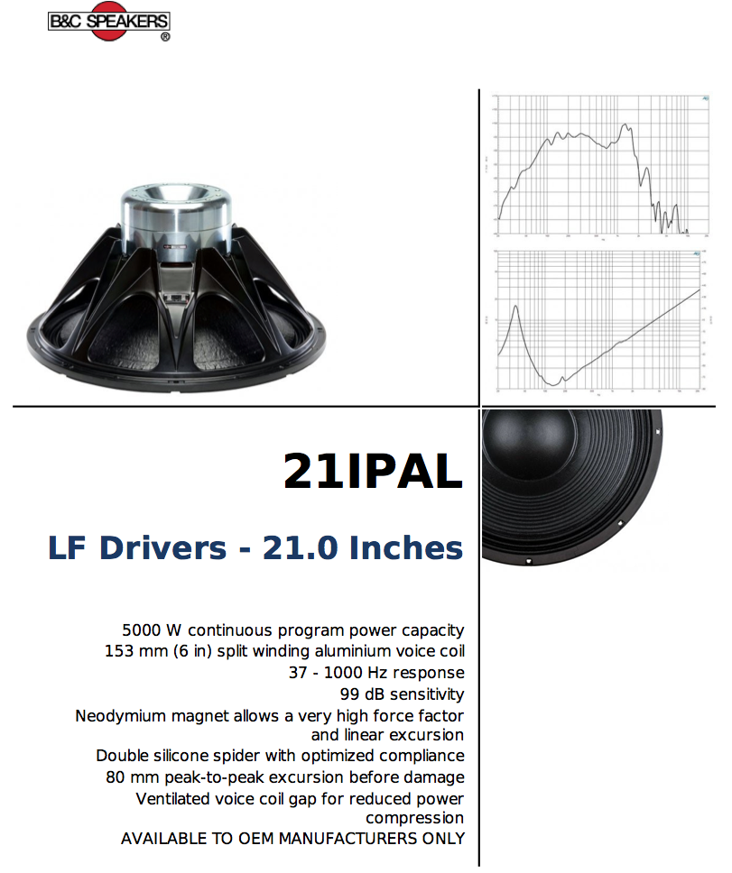

Ben,The harm you refer to is the terrible threat faced by those who try to produce MF systems commercially: feedback system go nuts when naive customers push them outside their working range... even just for an instant.
The commercially available (to original equipment manufacturers) B&C/Powersoft IPAL system discussed in posts 27, 31 and 33 does not "go nuts when naive customers push them outside their working range".
The system limiters make it impossible for end users to cause any damage to the system if it was properly set up by the OEM.
Since a manufacturer's warranty covers failures, it makes no sense for an OEM manufacturer to set limit parameters even 1/4 dB higher than safe levels.
After the original failures associated with finding what the real world of DJ abuse could dish out, the systems have been quite "foolproof", and offer the highest clean, near transient perfect output potential in a small package presently available.
That said, few are willing to pay the rather large cost difference for improvements that are (arguably) masked by room modes and reflections or compromised by addition of multiple arrival times due to the large number of open microphones on any concert stage.
Having proved to my own satisfaction that the differences in phase response a MF system can provide is inaudible to my (59 year old, NIHL) ears, I am satisfied with using other (very) good speaker products from B&C.
In the (relatively, compared to this three year old zombie post) near future I will be building a half dozen Keystone "stretch" (taller, lower LF cutoff) subs, and will compare the pair of B&C driver loaded units to the other four loaded with cheaper drivers that I purchased previously, thinking I wouldn't hear the difference in quality.
I have a premonition that four inexpensive drivers will be up for sale once their rental income pays for the cost difference between them and more B&C drivers to replace them ;^).

Ben,BTW, BR boxes are not suitable for MF. The sound output does not mimic the cone motion across the range you care about the most.
As the photos clearly show, the sound output of the IPAL bass reflex MF system does accurately "mimic" the transient response of the low frequency input signal.
That said, the mid-range decade from 400 to 4kHz is the range I care about the most.

I started my 41 adult years in sound reinforcement mixing bands in bars, some of the lightweight mid cones we used back then might not withstand a plastic straw, so we used grill cloth over them to avoid that problem .
The BC 21IPAL can handle 2500 watts (that's 3.3 horsepower to us old-timers) and has moving parts weighing in at 487 grams. Put a drinking straw in front of it while it moves through it's linear stroke of +/- 22 mm (about 1 5/8 inch travel, it can do 80mm peak to peak without damage) and you will have a smashed drinking straw, and perhaps a bruised hand. You can throw baseballs a surprising distance with these drivers, and they sound fine while doing it.
Unlike the crap I started out with 45 years ago, IPAL amps have no wonky turn on transients. Since I started using decent amps, I never have felt the need for an oscilloscope, eh .
