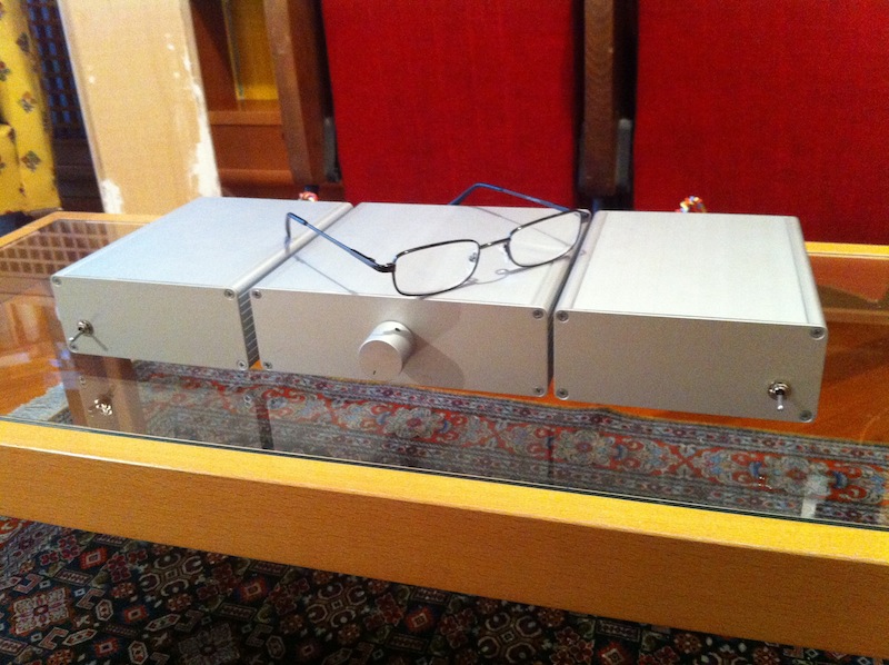

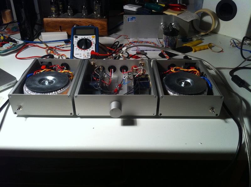

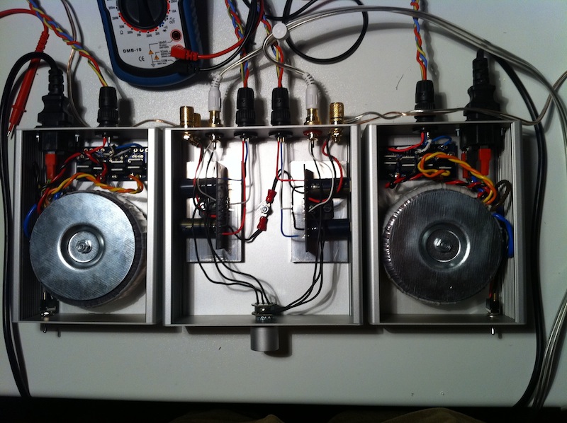

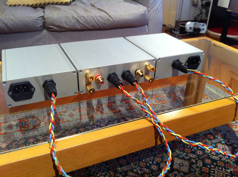

Low hum from trafos
first of all thank you Peter and all of you for giving me the chance to build with your help my amps.
I built my third amp based on the Audiosector kit.
In particular this one uses the premium kit in dual mono configuration, the configuration similar to the 47 Labs Gaincard.
It sounds extremely good and I am very very satisfied. It incredibly improved the transparency of my diy Jordan MLTL speakers.
I only had to put the small caps at the chip input as suggested in post #51 because of the RF noise which now is completely disappeared.
No noise is now coming from the speakers.
I can only hear a very low hum when I put my hear very near the PSU.
Is this just a usual noise of the trafos or is it due to a ground loop?
I assumed that ground loop noise should come from the speakers.
Thank you for your help
Renato

Nice work!
Thank you. It is not beautiful like Audiosector Patek, but I am proud of it, of course. I am going to post the pictures on the chip amp gallery
Yes, a ground loop would hum from the speakers.
Some transformers make a very faint hum/buzz.
OK, I can survive with it: I do not listen to music with my ears on the PSU
Renato
