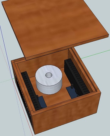

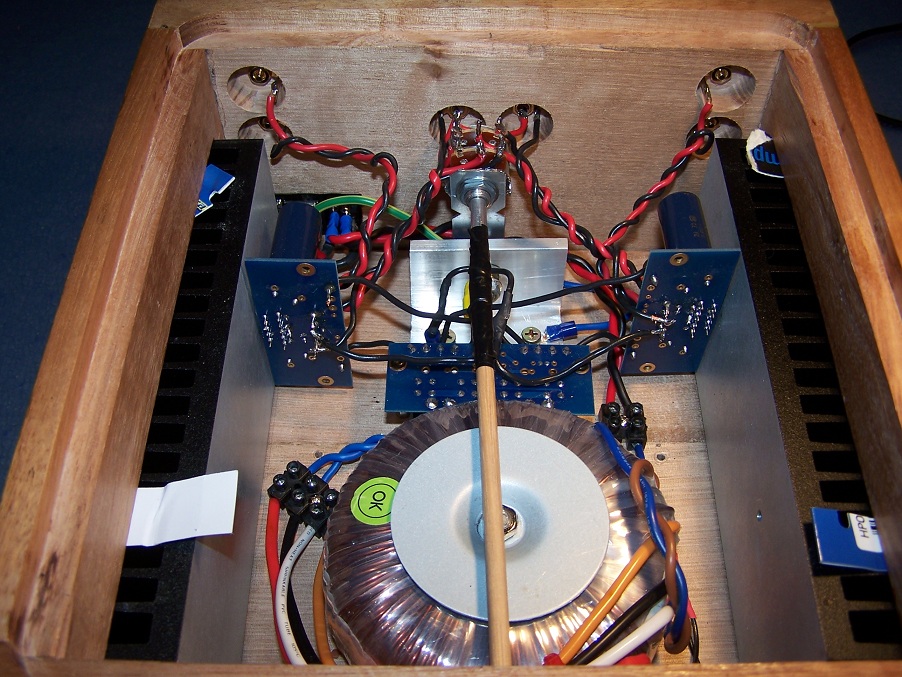

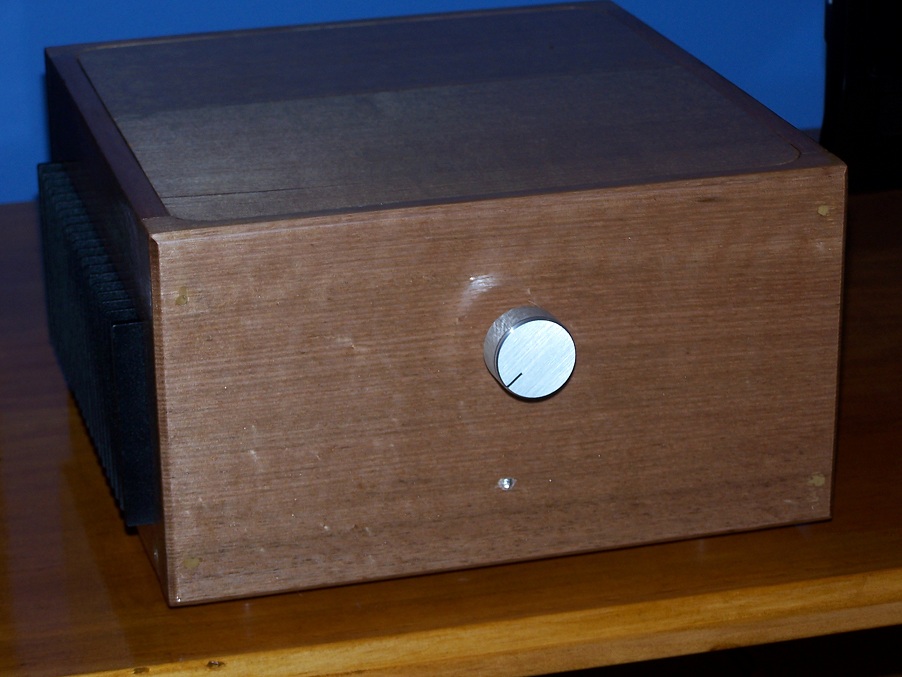

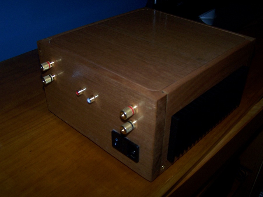

Here are the pics, feel free to criticise. I'd love to hear what I've done wrong or what I can improve upon.
I'll just point out from now that these pics were taken before the amp was 100% completed, the heatsinks are now grounded. I still need to secure them properly also. The volume shaft is also temporary, matter of fact, the whole case is temporary as I have made it far too small for my liking. I will have to last until my summer break. When I was designing my case using Google SketchUp, I didn't realise how cramped the case was going to be after wiring up the amp. I still managed in the end.
I see nothing wrong with the way you have used the space available to you.
It works and you have room to check and/or maintain the innards.
One Safety question.
Are all the exposed conductive parts connected to Safety Earth?
No metal chassis makes this more difficult in that separate grounding wires must be run to every exposed conductive component. I think I count 9.

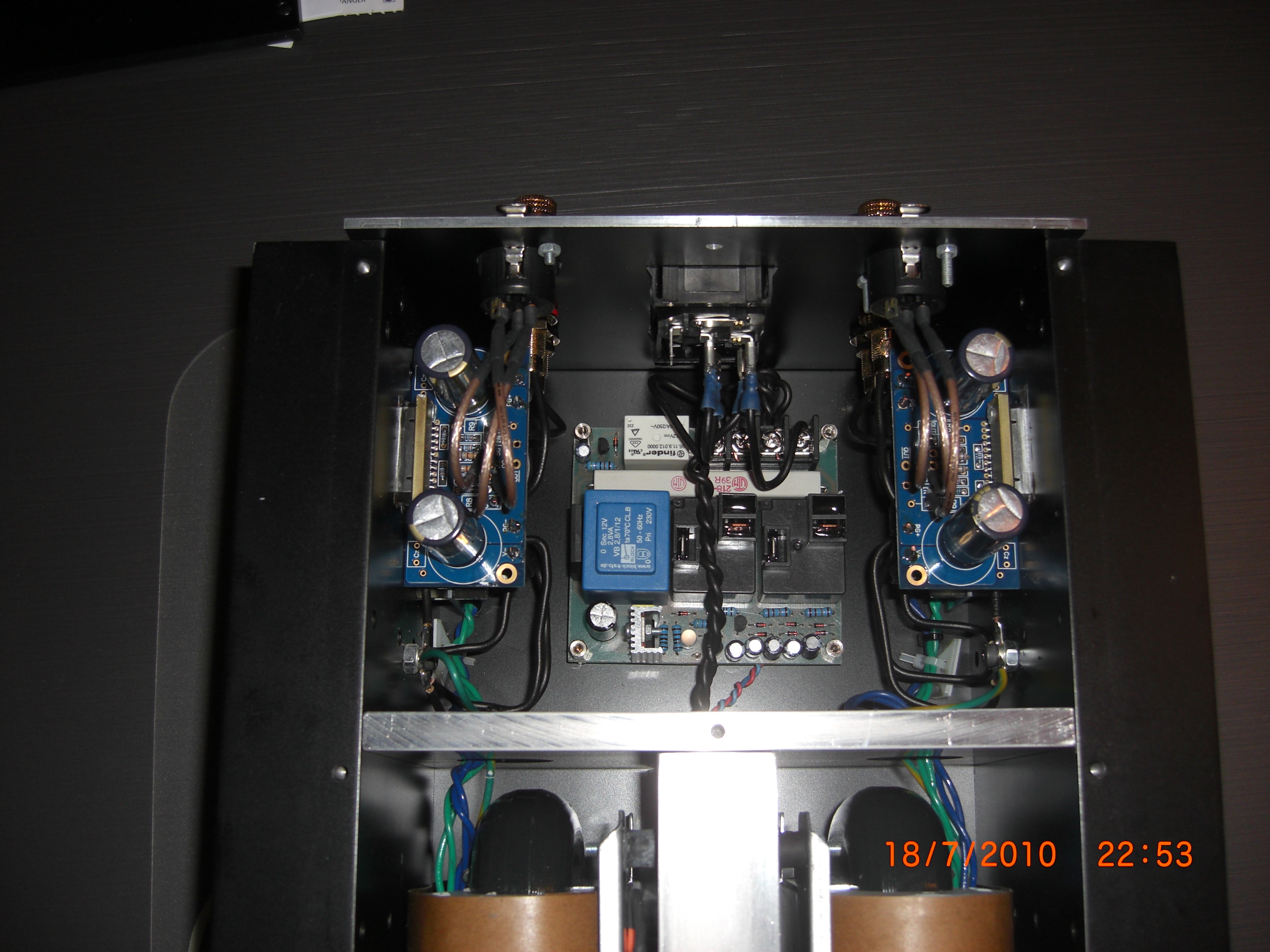

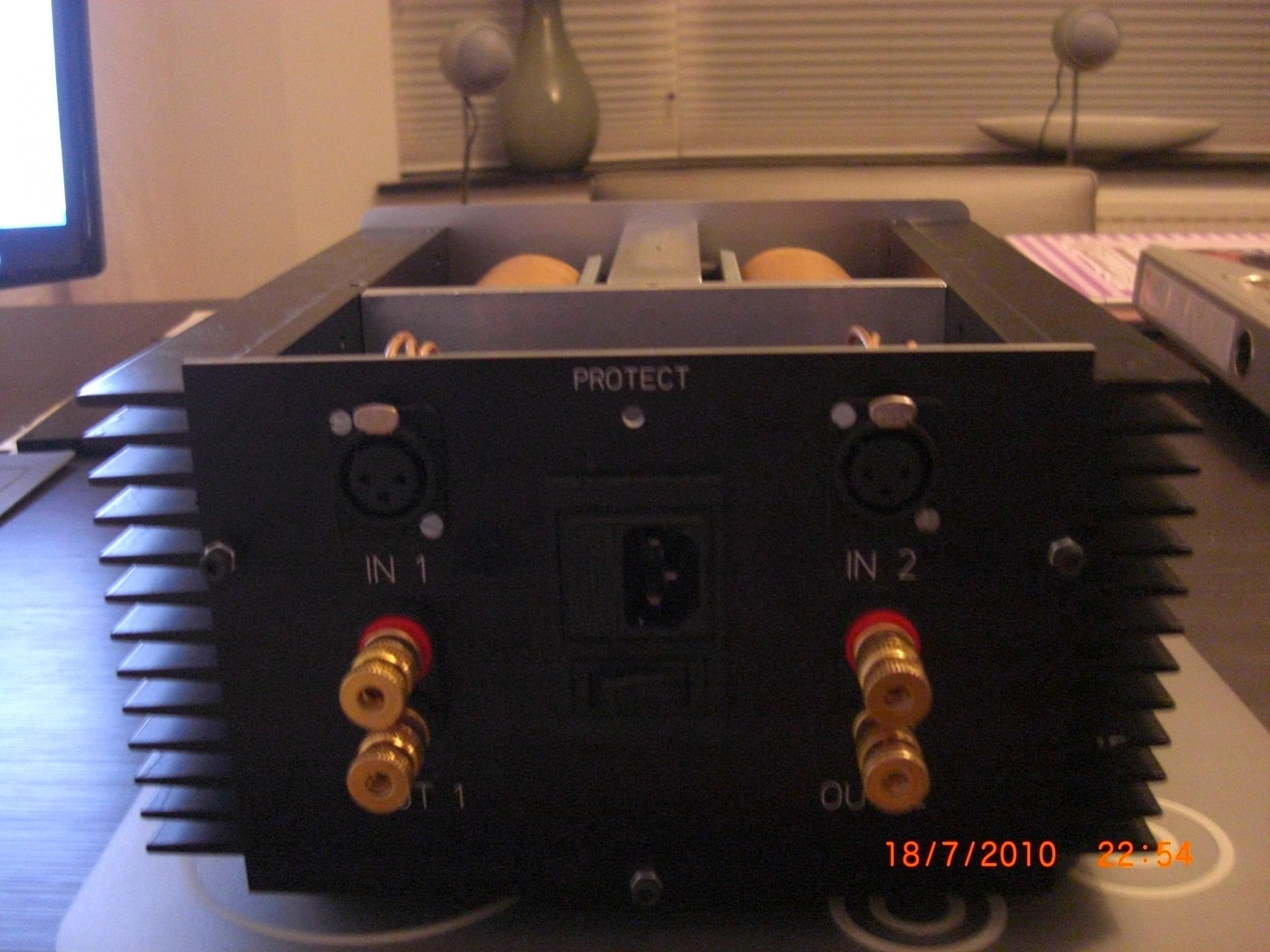

My first gainclone
One build. Another to go.
http://www.diyaudio.com/forums/attachment.php?attachmentid=180791&stc=1&d=1279486621
http://www.diyaudio.com/forums/attachment.php?attachmentid=180793&stc=1&d=1279486621
http://www.diyaudio.com/forums/attachment.php?attachmentid=180794&stc=1&d=1279486621

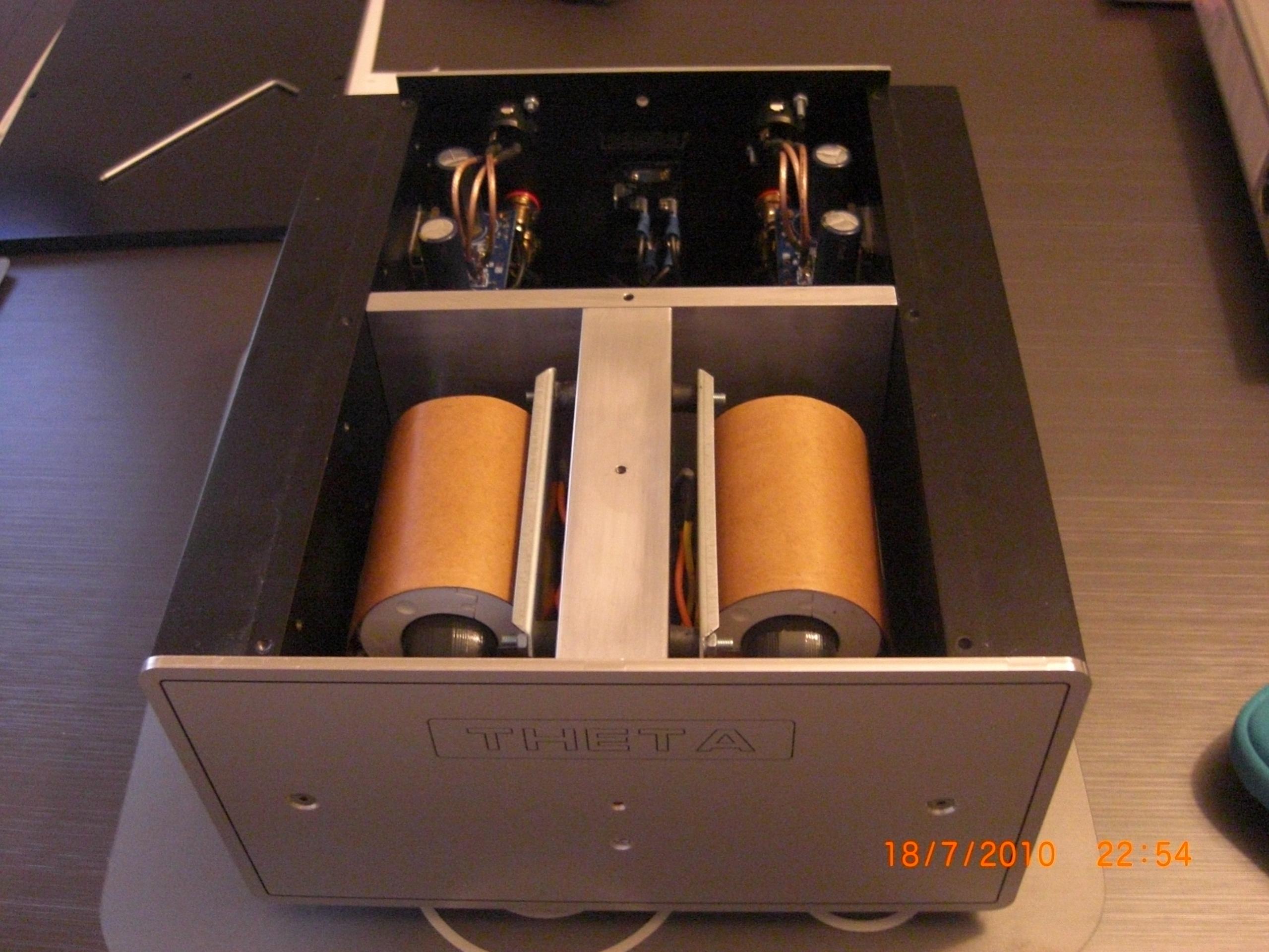

Hello Koogar,
thanks. The rating of the transformers is 200VA per transformer. I ordered them at: DIYCLUB. I waited a very long time for these (1.5months) but that was probably because i asked for sea transport to save on the shipment cost (i ordered 4 of those and they are heavy!). The voltage is 2 pairs of 2x24V. They are build for the LM3886 etc kits tehy also sell.
