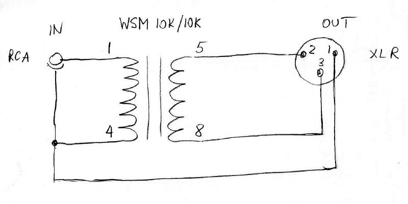

It shouldn't be a problem to use bridged LM4780 with 6 ohm loads, of course the results will depend how loud you like to play, what type of music and on heat dissipation capabilities of your assembly. I've been using bridged LM3875 for almost a year with 4 ohm speakers (FAL) without major problems.
Please note that in order to use the amp in bridged mode you need to supply balanced signal to the amp, as the amp by itself will not do conversion from unbalanced source.
