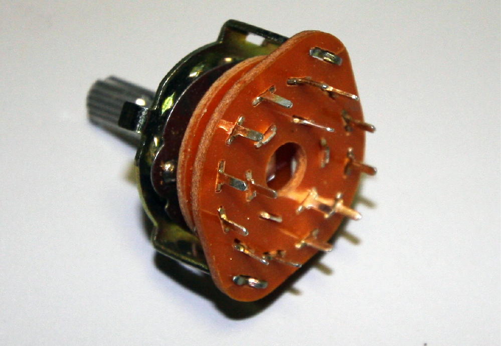

A simple rotary switch is pictured below: it features a single deck with 12 pins and 3 poles which is good for 4 positions.

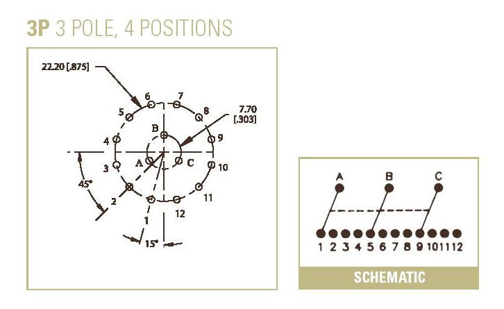

Attached is a schematic for such a switch.
For stereo application we use only 2 poles, lets say A and B, which connect to pins 1-4 and 5-8 respectively. Pole C is not being used.
We only need to switch signals, the grounds are common and usually not switched.
Pin 1 connects to left channel of your first source, pin 5 to the right channel of your first source (connected to RCA inputs).
Pin 2 to left channel of second source, pin 6 to right channel of the second source, and so on for other two sources.
Pole A is a left channel output, pole B is a right channel output from a switch, and they connect to the potentiometer.

Thank you Peter, you have been very kind and detalied in your answer as always.
Just last question (I hope): where should I connect all the RCA input grounds? All left channel grounds together to the left amplifier PCB input ground and all right channel grounds together to the right amplifier PCB?
Thank you again
Renato
Re: Source selector
That is correct. The amp board input ground is marked SG, this is also the point where ground from potentiometer connects.

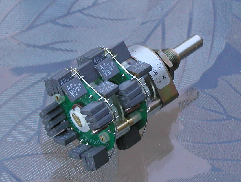

Personally, I don't like buffers in the amp, the buffer should be placed with a source. A simple fet buffer works fine with NOS DAC, one such example is buffer described in Figure 15C in Borberly article: http://www.borbelyaudio.com/adobe/ae699bor.pdf
At the amp's input, a swtching attenuator is usually preferred (25k or so).

Sorry for my ignorance but where exactly do we use the switched attennuators? Is it a substitute for volume pot?
Also, currently i am using a 100K pot for volume control as it was the only one available at the time i was building. I still need to order the Nobel one. Does this value affect the amp in anyway? I should be using something in range of 20-50K, isnt it?

I actually meant stepped attenuator in place of potentiometer, which is probably more popular term, a recent discussion can be found in Blowtorch thread: http://www.diyaudio.com/forums/showthread.php?postid=1568061#post1568061
100k will work but it's a bit too high, the potentiometer should preferrably be in a 10k-25k range, 50k being maximum.
