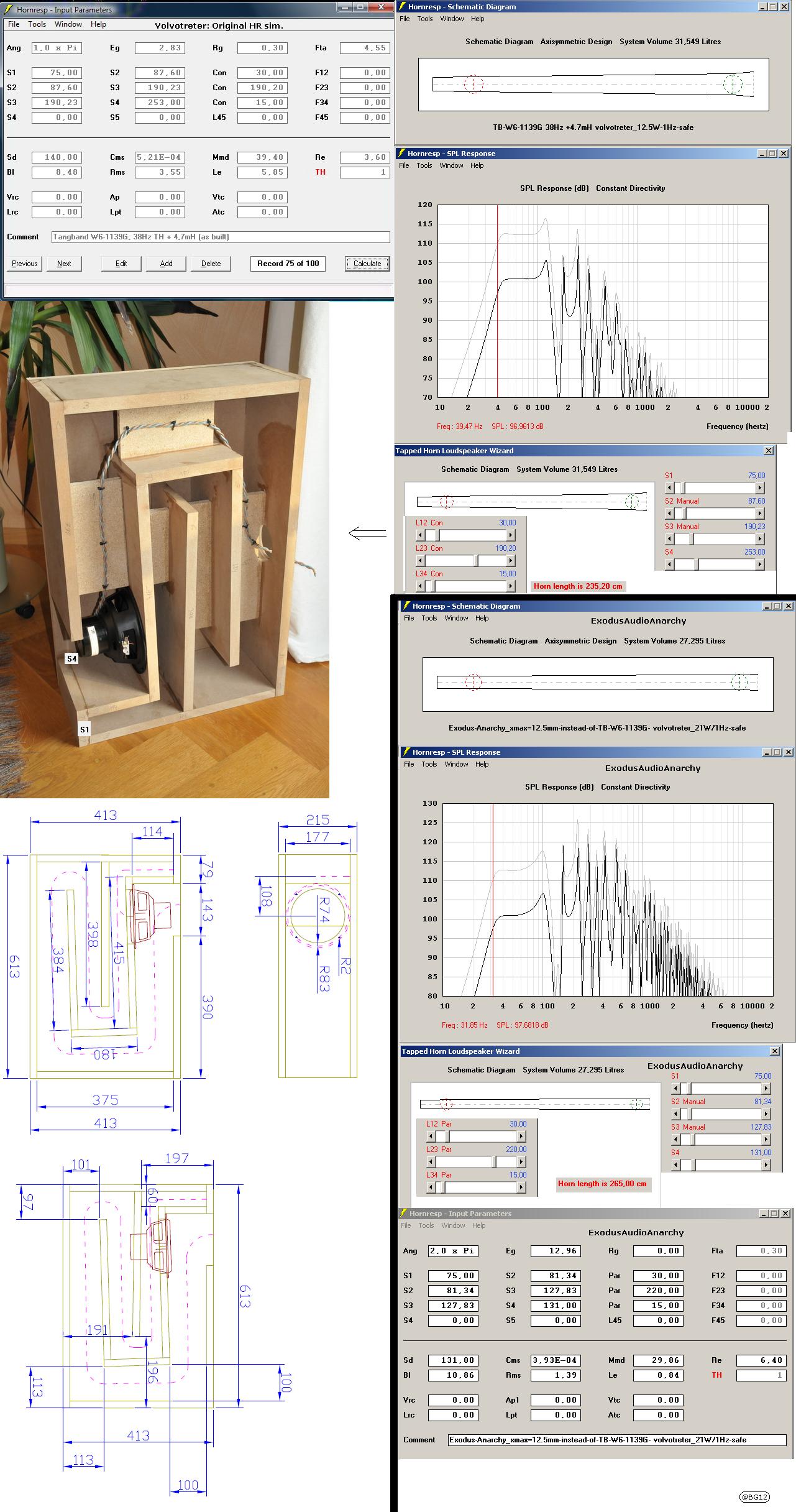

I have been looking at the 25hz tapped horn flat pack for this driver. Are there any other kits that would be suitable? I am not concerned with 25hz response, 35-40 would be fine I have NO woodworking skills or equipment, thus I need a commercially available enclosure. Flat pack is ok. Any suggestions? Thanks

DIY a TH by converting small # of dimensional changes from Volvotreters design using the TangBand_W6-1139SC to your own using the Exodus Audio Anarchy driver. Try use the submitted information:
b:)

I would hesitate if the use of this TH is primarily for music as the so called 'TH flat-pack' suits IMO only HT when used a long with a HT amp that can take care of and adjust the group-delay that otherwise would screw up the timing fidelity for any good stereo speaker system.
Volvotreters design is in that respect not flawed at all.
