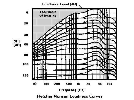

Hey, look at this chart and don't stick crossovers on the peak. . . don't allow "distractions" or "distortions" out of your audio system. . . and then you don't "need" your audio to be so loud.
Edit: After that, if you still want it loud, check out the concert-worthy speakers with high efficiency.
darn! the picture... i'm taking weeks to get what the hell is that.
Thts why i turn down the mid tonal level ( 3band tonal ) when play the music louder.
thats why we take more hundreds wattage to awake the lower hz ( subwoofer ). thats why some friends make a little delay for their mid and high.
sorry daniel, i don't get it last time.
you better tell 'the other indonesian' in his thread about this.
