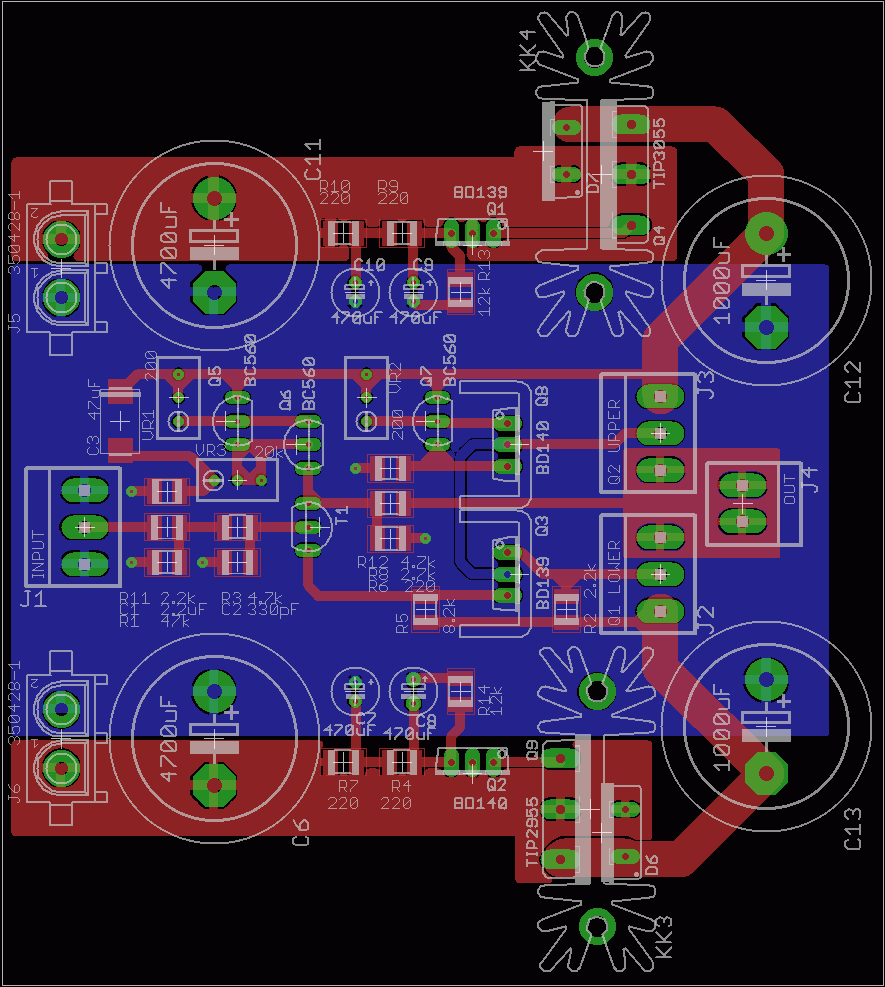

It was raining outside today and nothing good was on the TV.. So I decided to fire up eagle and try to make a very small JLH. I'd appreciate some comments and thoughts on making it even smaller.
Mounted off-board: The fuses, output transistors (& resistors), muting relay and the filtering caps.
Thanks !

Anyway, there is no way to reduce your pcb size, its OK. The distance between the smoothing caps it is big. Try to shorten it.
Fill the "T" points on the tracks, with small copper triangles. Avoid the 90 deg corners. They cause parasitic capacitances. Make the supply and 0V tracks thicker.

p robertson said:
Hi yoshy, is it the 10w class A circuit?
Yes, all the components on the PCB are rated at least 30v (C1 and C2). I'd have to redraw the PCB and make the traces bigger but higher power is achievable I think.

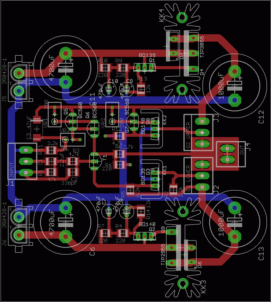

Thanks for the input; about the 0v: would it be better if I used a ground plane instead ? Something like this...
Thanks !
