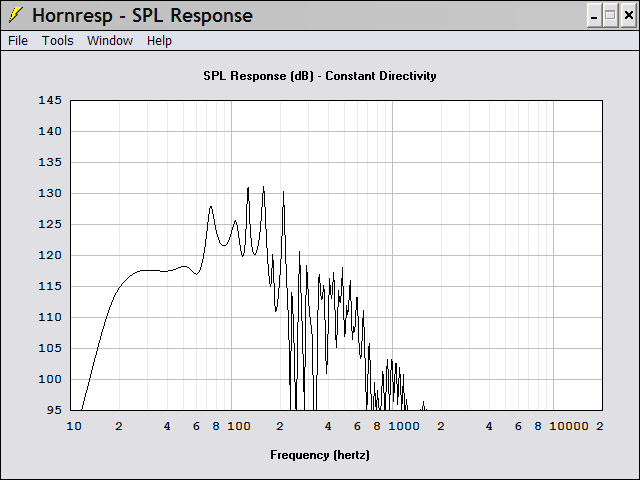

CLS said:Well, seeing so many successful and fascinating experiences about this, I can't help playing with the hornresp and the woofer I have on hand.
It seems not so good. Loud and deep, yes. But what the xxxx of those peaks and dips!
Maybe this can only be used for 80Hz and down with a very very sharp xover....
Can it get any better than this? Or this big dump driver is just a big no go in such application?

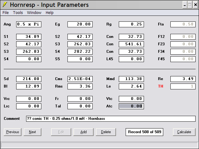

This is the data:
The problem is the length of S1. In my experience, the tapped horn simulation in horn response gets weird when any one of the pathlengths approach zero. In your simulation, S1 is barely a fraction of an inch. Modify that to a "sane" value and your simulation won't be so wonky. For instance, with a twelve inch driver your S1 will be in the neighborhood of six inches or more.
