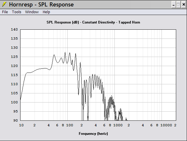

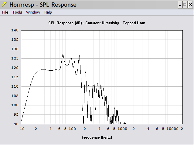

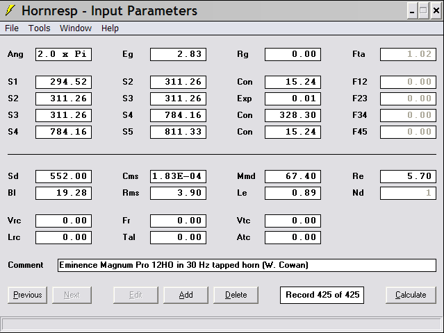

No, it's 2 pi, though I can't imagine why other than I did it in the wee hours because I couldn't sleep.
Regardless, little wonder it doesn't match up well since Freddy's TH dims are somewhat different than WC's, so try it in his at 2pi and see if we match 'close enough.
Still, yours is a bit different than when I copied the Magnum Pro 12HO into WC's, again at 2pi for consistancy, so where do we diverge?

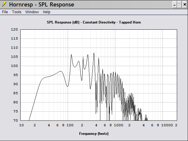

Because it's doable! Not every DIYer is a penny-pinching bargain hunter. Some folks would like it just for its novelty. Doesn't look too bad in a quick sim either:
GM

Eminence Magnum Pro 12HO in 30 Hz tapped horn (W. Cowan) - specs:
Exellent, thanks, looks like the Magnum Pro 12HO works well in that enclosure. As I have 4 of these drivers (and some baltic birch) I think I'll build 1 of the 30Hz TH enclosures first, and see how well it works. Them I may go for some self designed ones after that, so I can compare them.
William Cowan's 30Hz TH enclosure seem like a nice size also which is alway a bonus. If I get any free time this weekend, I should be able to make some sawdust. :)
EDIT: Could you post the parameters of the lower tuned one also? I'm sure I'd run out of xmax below 20Hz, but I wouldn't mind seeing how well it works. :)
Someone on a Dutch forum ordered one, just to try it out. He put it in closed and vented boxes and said it works fine, in balance with its price. In addition, its dimensions allow different enclosures than the normal standard squarish boxes, which is the whole point of this driver. I could imagine someone using this driver for a very flat tapped horn, something that sits more flush with a wall than the coffins that you are almost forced to make with regular round drivers.
Like GM said, interesting challenge for DIYers.
GM
Good point GM! My initial reaction was the same as Iand's, but I can't fault your logic.
Something like that would be good for a tapped horn in a pickup truck, where the box could be very wide and tall, but shallow enough to fit behind the seats.

Good to know, thanks! Yeah, I had already done the sims, just hadn't copied/uploaded them when I saw Ian's negative response and posted a 'knee jerk' retort, but you and PB are right, this would make a nice, relatively flat panel speaker or horn for a truck, under a sofa or bed/whatever if the specs are reasonably accurate. Not to mention that due to its layout it may have better distortion specs under load than a typical car audio 'sub' driver.

I didn't mean just vs price, even if the frequency response is flat maximum SPL will be much lower due to comparatively limited power handling and Xmax -- conventional drivers will give a lot higher maximum SPL in the same size box.
Since extended response and high maximum SPL are generally the whole point of tapped horns, this kind of goes against this :)
