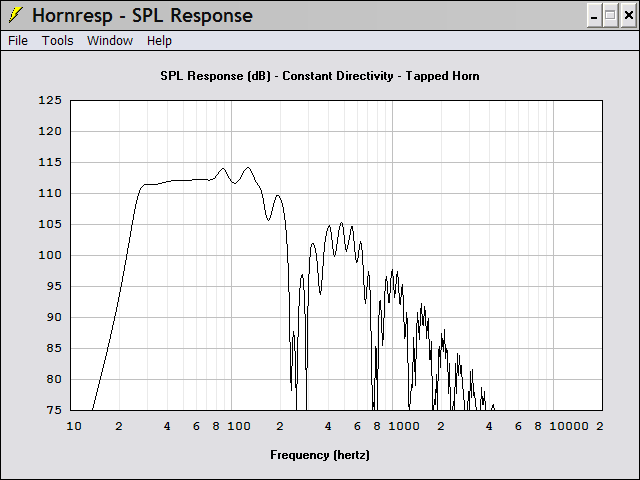

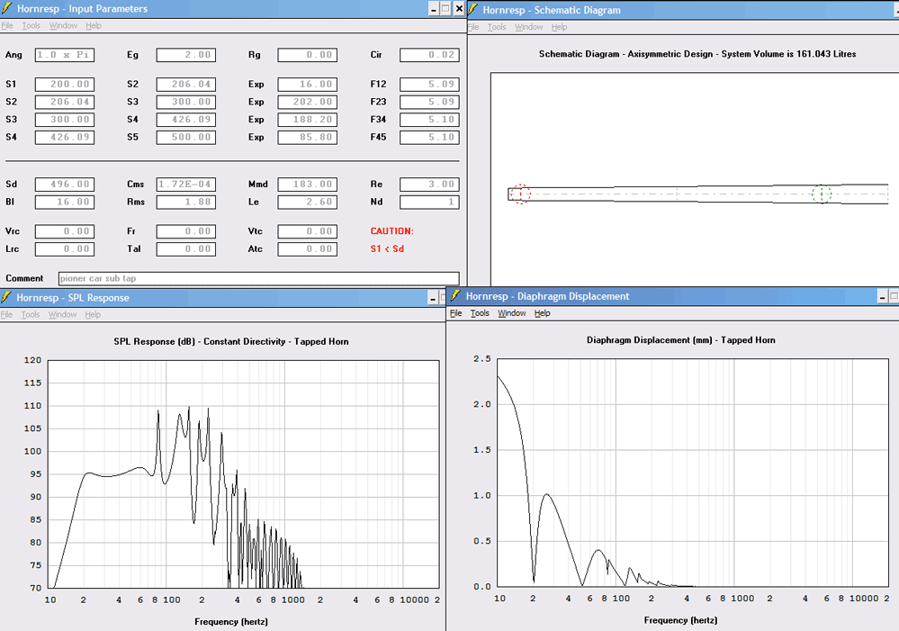

I also have 2 Pioneer car subs which are in reflex enclosures right now, and sound pretty poor. I thought I'd have a go and see if these are any good in a TH... The model number is TS-W305C, and it's a 12" unit, even tho the cone is closer to 10" really.
The box works out quite a bit smaller, and it's still good around 20Hz.
If I built 2 of these TH's, and put the mouthes next to each other, would I get more extension like you get with normal front loaded horns?

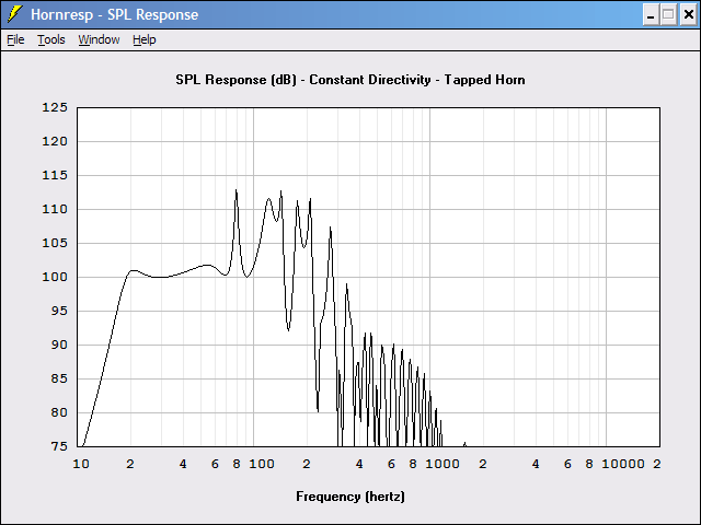

EDIT: Is there any way I can make this a little flatter, or will this sound ok it only varies 1 or 2 db between 20-80hz? This is the pioneer car sub, fwiw.

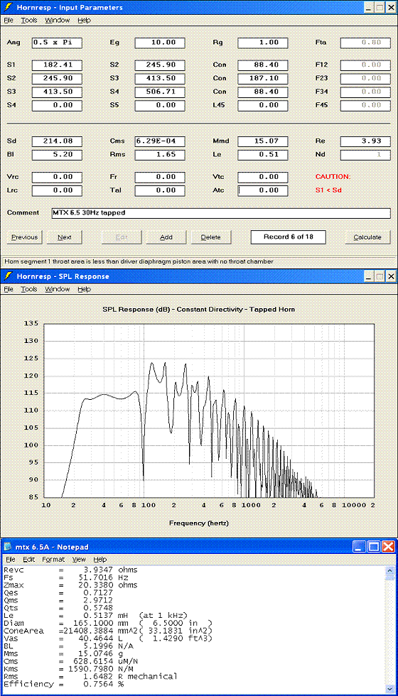

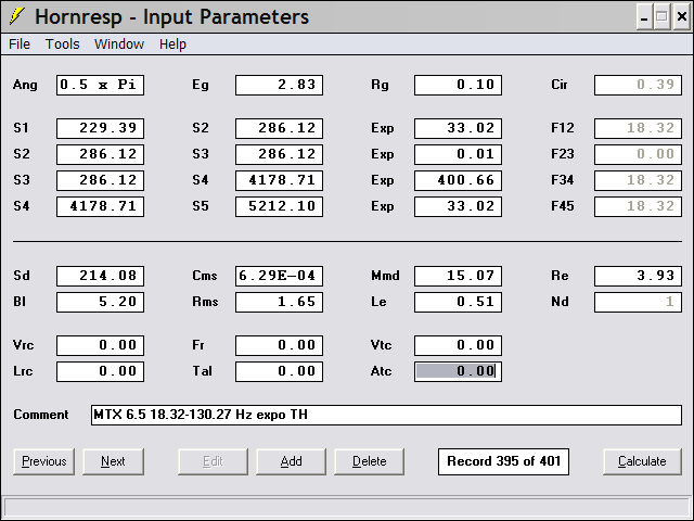

It's a 6-1/2" midbass from an MTX RT260S component set. Unfortunately I don't have a datasheet with Xmax on it. The TS parameters I am using are from the Woofer Tester II. Could you post the input window that goes with that SPL plot? I'm still trying to get the hang of picking flare rates and adapting them to the desired BW(using Leach's math via ML Util) and efficiency.
112dB SPL at 30 Hz from a 6-1/2" driver? What is the motor made of, plutonium with a diamond cone? That plot GM showed a couple of posts back of this driver's expected performance looks uber nice. Almost too nice. What am I missing here?
rcavictim said:What am I missing here?
A horn of almost 800 liters.

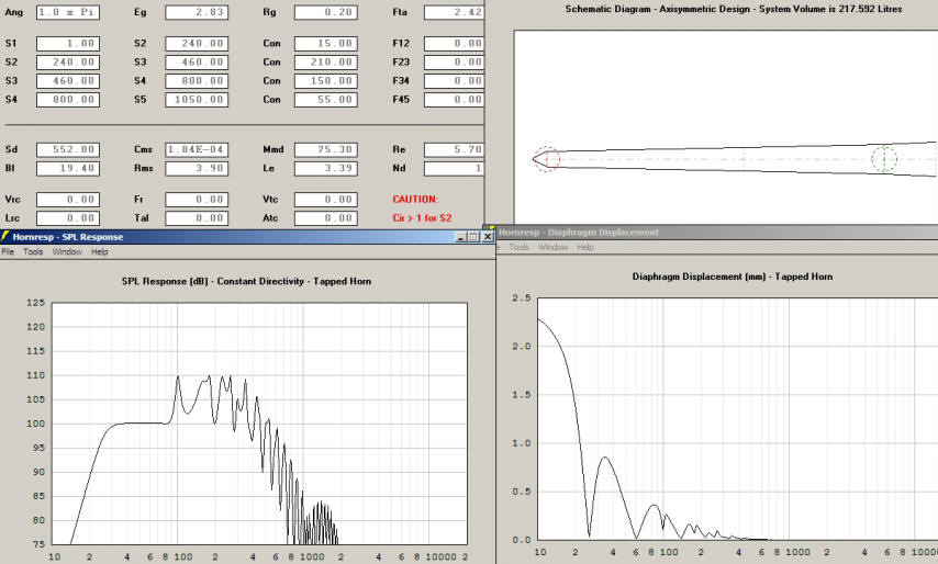

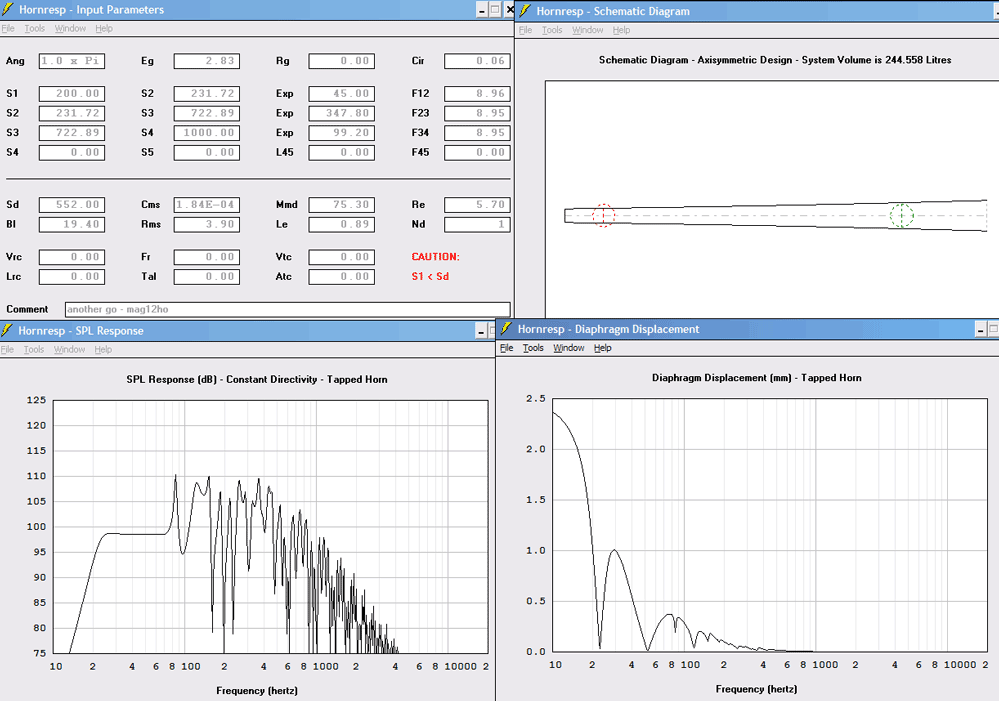

Anyway, I've worked on a couple of enclosures for my Eminence Magnum 12HO, and it seems to be a trade off between SPL and bandwidth... Both are around 250L which is a nice size for me.
Both are 1 x pi:
I'm thinking the black curve would be better, as I'm getting almost an extra 3db, with only slightly less extension?
Both are 1 x pi:

Just a quick question, isn't the compression ratio a little high? I thought you shouldn't go above 3:1, so 552:1 seems too much...
Anyway, I'm pretty happy with this design, even tho it isn't amazingly flat, I'm gonna have a go at building it:
I used the spreadsheet posted earlier to see that it will be less than 8ft tall which means it will fit in my room... Now the only part I'm struggling with is how to actually convert into a finished design... Are there any links for anything similar which show how to turn the sim into an enclosure design? I'm going thru the wiki right now, and I may yet strike gold.
