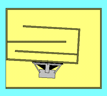

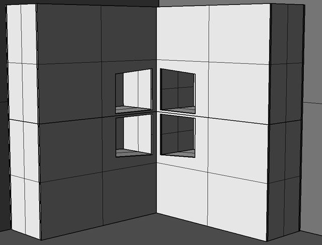

With horns, putting the outputs as close together as possible is better, because they need to be close to work as one big horn. It depends on the quarter wavelength of the highest frequency in question. Dont put them further away from each other then that. For example 107cm for 80hz upper cutoff.
Chris8sirhC said:In regards to that "wall of bass" would it be better to have the output mouths in each of the outward 4 corners of the wall instead of clustered in the center of the wall?

Thanks iand have a couple of ideas in the works for that top end of the TH which brings me to a ?
I noticed in some earlier post there were some pictures of pvc pipes that were thought to be resonators.
Can that be implemented into the box to help with the upper bandwidth peaks? If so any ideas on how to figure them?
I put the mouth in that way as to couple the horns of course but to take advantage of the surface area of the front of the horn. I can simply put these in a 90 degree configuration and I was thinking have corner loading. I could be wrong but it only seemed logical. This was my thought anyway.
I have been tweeking away at the design and will post as soon as I get it right I have it done to about 408 ltrs and reasonably flat.
Thanks again guys. Nice to have responses and look forward to getting some time to put this project together.
I will try to post some pics of the different configurations I was thinking with when I was designing the box.
dee
