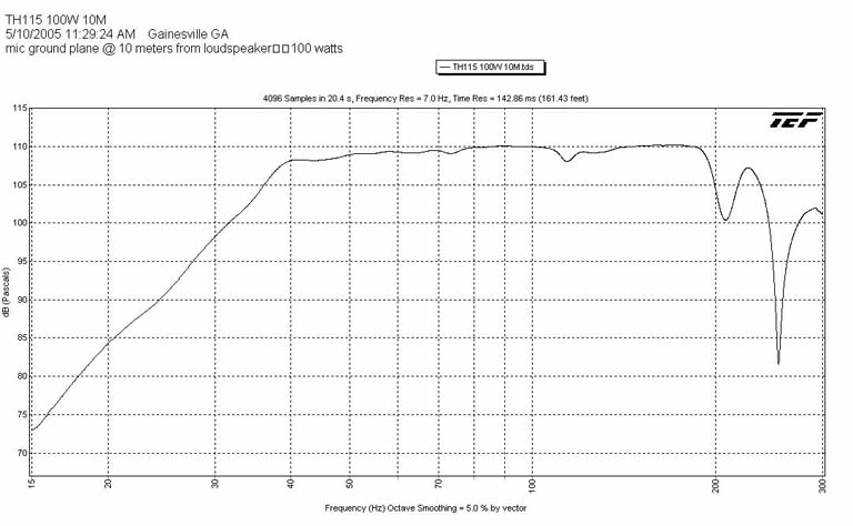

Tom Danley said:Hi Ian
Your trying pretty hard to make the case the Tapped horn does nothing unusual. Normally, when investigating something new one usually has better results with more of an open mind approach, as opposed to deciding on little information, but to each his own.
Also, so far, you are only comparing a loss-less ideal model where the port losses and size is not included in your model which is not the same as measured results in the real world.
As others have suggested, why not look at it from the other direction, take the measured results and see what it takes to equal them even if its only a prediction?
Take the measured response of the Mini, take its volume and see if you can make a vented box with the same sensitivity, low corner and include cabinet walls and a realistic port size which is taking up some of the space.
Same for the 4Xth115's below.
Also, a few Vented box Pro-sound subwoofers DO have real measured responses, to get more of a feel for that , you might want to examine these curves carefully relative to the TH-115 and TH mini.
http://www.jblpro.com/srx700/SRX700_Flash_Presentation/JBL.SRX718S.pdf
http://www.jblpro.com/srx700/SRX700_Flash_Presentation/JBL.SRX728S.pdf
Your assessment of how the horns work is curious, at least from my understanding.
If your assertion is right, it should be a snap for you to find a vented box combination which gives the same or greater efficiency shown below for four TH-115’s with the same physical size and low corner.. Don’t worry too much about if you can find / build the actual driver, for now anything goes.
Again, as with our other curves, this is in half space with 100W drive (25W each) and at 10M so it is a conservative “1w1m” equivalent.
Best,
Tom

Hi Tom
Just to check -- this is the same as a single TH-115 in a corner (0.5*pi) ?
Cheers
Ian
Best,
Tom
Hi Tom
I've done some modelling in Hornresp of what I think is something close to the TH-115 (but see comments about simulated vs. measured results) and a dual 18" reflex box with the same external size and cutoff frequency -- all results are for a single box in half space (but both boxes gain the same 10dB in a corner or a block of 4 according to Hornresp).
I know this is simulation only, but it's the only way I can see of doing a comparison of the two designs with a level playing field -- if there is any systematic error in Hornresp's calculations it should at least apply to both designs equally, so the differences should still be correct.
Box designs
For the TH-115 I'm using the B&C 15TBX100 in a 3m long conical tapped horn (tap points 20cm from each end) with 3:1 CR (best result I could get) and 2000cm2 mouth -- this gives just over 300l net volume which I calculate is what is inside the TH-115 allowing for all the internal partitions and the bottom rear corner chamfer.
For the reflex box I'm using 2 B&C 18PS76 with 320l net volume, (allowing 30l for ports which is a 10" diameter port per driver) tuned to 37Hz. Simulations for box this are with 2V applied to allow for 4ohm nominal impedance (2.82V for tapped horn).
Response curves
The tapped horn has an impedance curve which is very close to the TH-115, but in spite of lots of tweaking I can't get either a flat response or one that's quite as efficient as the one in the data sheet -- from 37Hz to 100Hz it varies from 99dB/W to 102dB/W (3dB ripple), average is about 100.5dB/W, -6dB point from this average is 34Hz.
==> Tom, can you explain why the measured results in the data sheet look better than this? (I have noticed the poor frequency resolution, also the differences between the current data sheet response and the one I have saved from a couple of years ago
The reflex is not quite maximally flat, from 38Hz to 100Hz it varies from 100dB/W to 101dB/W (1dB ripple), average is 100.5dB/W, -6dB point from this average is 32Hz.
Maximum SPL
Maximum cone travel for the tapped horn with 2.82V applied is 0.49mm at 47Hz (also at 33Hz). Mathematical Xmax for the 15TBX100 is 9.5mm, so worst-case power handling is 380W without exceeding Xmax, which is over 4dB less than the 1000W continuous power handling of the driver. This limits peak output to 126dB at 50Hz and 119dB at 33Hz (average would be 130.5dB at 1000W without Xmax limit).
Maximum cone travel for the reflex with 2V applied is 0.29mm at 51Hz (also 32Hz). Mathematical Xmax for the 18PS76 is 9mm, so worst-case power handling is 980W without exceeding Xmax, which is 1dB less than the 1200W continuous rating for the drivers. This limits peak output to 130.5dB at 50Hz and 125dB at 32Hz (average inband output would be 131.5dB at 1200W without Xmax limit).
Comparison
The 15PZB100 costs 225 euros+VAT, the 18PS75 cost 167 euros each + VAT which is 50% more for a pair than the single 15PZB100, but I would expect the extra cost of building the tapped horn box would compensate for this.
According to Hornresp (which might not agree with your SPL measurements for sensitivity, but the cone travel results are similar to those in your white paper) we have the following:
-- average sensitivity 38-100Hz is 101.5dB/W for both boxes
(single box on floor, both increase by 10dB in corner or block of 4)
-- inband ripple is 3dB for tapped horn, 1dB for reflex
-- -6dB point is 34Hz for tapped horn, 32Hz for reflex
-- Average SPL at rated power is 130.5dB for tapped horn, 131.5dB for reflex
-- Xmax limited SPL inband is 126dB for tapped horn, 130.5dB for reflex
-- Xmax limited SPL at -6dB point is 119dB for tapped horn, 125dB for reflex
Conclusions
Sensitivity is similar for both boxes, dual reflex has flatter response and higher Xmax-limited SPL across the operating bandwidth.
Even allowing for a 2dB possible sensitivity discrepancy between simulations and measurements in favour of the tapped horn (which I hope Tom can explain), the Xmax-limited maximum SPL for the tapped horn is still considerably lower.
Note that I've allowed a huge 10" diameter port for *each* driver so maximum velocity even at 32Hz is only 11m/s, which should be well below the point where significant port choking or chuffing happens.
Before anyone says "it's not fair comparing 2 18" drivers to a single 15" -- remember, nobody really cares what's inside the box, only results (size, weight, cost, frequency response, maximum SPL).
On this basis it seems that the dual-18" reflex does indeed equal or exceed the performance of the single-15" tapped horn.
I await comments with interest...
Cheers
Ian
P.S. If Tom can show otherwise I'll be perfectly happy to be wrong!

Exactly that´s my point. If nobody double checked excursion on an actual real TH - how can we be sure that the simulation is 100% correct? After all - simulation is one thing, checking up on reality is another. Without the latter it remains speculation. Not everything is predictable by an simulation. The often mentioned effects of port-losses in a reflex-design are one example. This has to be measured in real life.
It´s only fair to raise an eyebrow if a well known driver seems to handle much more input power in a TH than in a reflex-design. One key to explain this observation is to check up on excursion.
I know of several simulation programs which calculate excursion not as peak-peak but as "effective excursion" (don´t know if thats the correct english terms). AjHorn for example does this. So a result of 1mm excursion in the simulation has to be mulitplied by 2.83 in order to get the "real live movement" from peak to peak (or multiplied by 2.83 / 2 to get +- results comparable to the numbers in spec-sheets). I don´t know how hornresp handles this, but I am sure not everybody is aware of this when using ajHorn so many misinterpretations can occur.
iand said:We've had enough trouble with feelings, impressions and speculations already in this thread -- hard facts, science or measurements are needed!
I'm sure that if simulations disagree with real life then the simulations will be the source of error, Scotty had it right here...
Ian
What you want to find out is very interesting, but maybe you should do some actual work for it instead of criticising others and proposing challenges. Constructive criticism is the key.
The real problem is, that you want other people to do the work for you. If you really want to achieve something, then DIY.
Sabbelbacke said:Exactly that´s my point. If nobody double checked excursion on an actual real TH - how can we be sure that the simulation is 100% correct? After all - simulation is one thing, checking up on reality is another. Without the latter it remains speculation. Not everything is predictable by an simulation. The often mentioned effects of port-losses in a reflex-design are one example. This has to be measured in real life.
I'm hoping we'll get a reply soon from David McBean (and maybe Tom) about this.
If there is any error in excursion calculations -- like x2 from confusing peak and peak-peak -- this would almost certainly apply to all simulations, since the same equations are used everywhere. So any differences in excursion between different boxes are likely to be correct -- however if the absolute numbers are wrong then this changes lots of conclusions...
In the Hornresp simulations I did for the "TH-115" (as close as I could guess) the maximum excursion was +/-0.49mm at 47Hz with 2.82V applied. In Tom's white paper (which refers to the TH-115) he says that the peak excursion with 63V applied is just over 6mm (I assume this means +/-6mm) at 46Hz, which would give 0.28mm with 2.82V applied.
This is just over half the number predicted by Hornresp, which is not good :-(
If Tom's figure is right then this also explains why my calculations showed the TH-115 to be Xmax limited at 380W; with his excursion figure this goes up to 1160W which then exceeds the thermal rating of the driver -- so my conclusion that the TH-115 was Xmax limited is then wrong.
I did clearly say that all my figures were based on Hornresp simulations and the assumption that these were correct, and that "If Tom can show otherwise I'll be perfectly happy to be wrong!" (my exact words) -- and I stand by that
