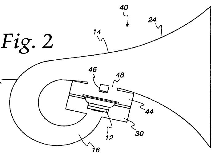

Here is a pic from Toms patent, which shows the compression chambers, but lacks one part of the horn path (a1-a2 in williams pic).

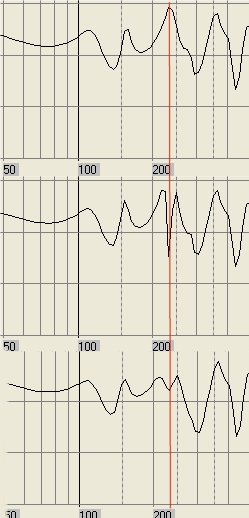

More study on resonators. The first plot shows a peak at 230Hz.
The second is affected by a duct, thus:
Duct 'D1' Node=3=0 dD=10cm Len=36cm
I couldn't get too much better using a simple duct.
The third uses damping in the duct (thanks MaVo)
Duct 'D1' Node=3=0 dD=15cm Len=36cm QD/fo={0.05}

@jnb: How can we achieve this kind of damping? do we stuff the pipe with rockwool or something like that? what kind of damping can affect those big wavelengths in question? But absorption seems to be a good way to make the q broader.
I assume Akabak models its damped ducts as for normal stuffing. The manual says it's frequency independent but reality should only be some trial and error away.

Well, in reality, getting results with resonators will probably be easy. Tom showed in his DTS20 that the concept works. So, all one has to do, is to make a connection point reachable in the horn to connect a quarter wave resonator. Then one can experiment with different diameters, lengths and stuffing, to get the best real life results.
One other thing, do you have a clue, what effect the damping material in the DTS20 has? I mean, it is so thin, it couldnt have an effect on the generated sound, or am i wrong?
